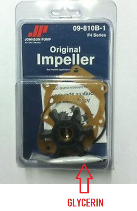

Glycerin is what the impeller manufacturers suggest and ship many impellers with. Dirt cheap at any pharmacy.

Johnson (OE supplier to many engine manufacturers) supplies glycerin right in the impeller kit..
