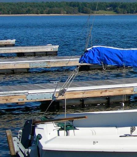

I think the main sheet on the 19 is end boom sheeting to the backstay triangle plate, just like on a 192 or 222. There should be a 12 or 18" strop from the backstay chainplate up to the triangle plate, and then on up to the masthead. The idea is that with stronger winds, the main sheet lever the triangle plate tensioning the backstay a bit. Meh, I'd rather have an adjustable backstay and a raised bridge traveller across the aft coaming...

Hello Bmiller, I replaced my halyards w/1/4" and I believe the sheets are 5/16.The mainsheet blocks are attached to the backstay of all places.You'll probably see a triangular piece of stainless with a hole in it low on the backstay. The centerboard pivot is a bit of a project.In my case I needed to replace the centerboard pennant line so I put the boat on blocks and removed the 4 screws at the front of the centerboard trunk on the underside of the hull.It helps to use an impact driver to remove these screws.To my surprise the pivot pin on my boat showed little wear but I had the replacement and put it in.I would recomend just replacing the pennant line and not removing the board and pin.You can lower the board to get to the attachment point of the line with the boat on blocks or stands. Good Luck,Barry

So let me be sure about it, the short pennant goes to the padeye, then the backstay and mainsheet go to the other holes. Interesting.

Diagram of mainsheet: attached below.

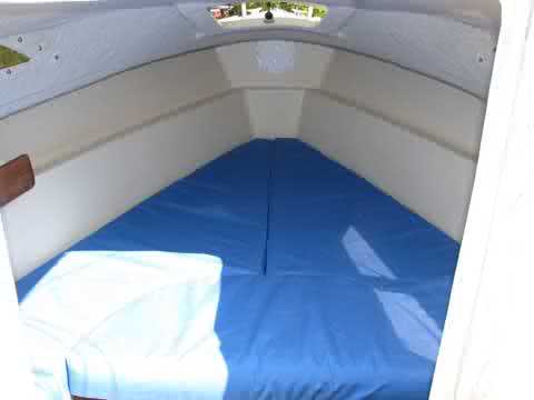

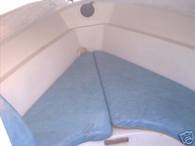

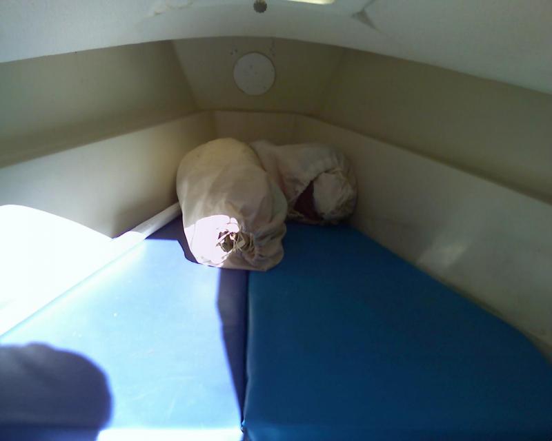

Another question, the bow eye was broken off. Looking inside the cabin at the bow there is a bulkhead of sorts with a couple rusty fasteners showing. Is it possible to open that up and access the bow and the nut for a new eye?

I ended up cutting in a hole and installing a circular removable hatch cover.

Sorry,no photos I'll try to get some.I would recommend a large port though.I think mine is 10".I cut the hole with a Fein vibrating tool and a wood bit.The fiberglass there is quite thin and cut easily.Inside there were shards of foam flotation material which must be taken out.I was adding a deck eye and backing plate to mount a roller furling drum.It was all I could do to reach and install the nuts.Hopefully the bow eye is an easier fix for you as it may be more within reach but I cannot say for sure.I didn't dig out enough foam to see.I would also recommend the screw on deck cover as opposed to the snap in type as the bulkhead flexes and makes the snap-in difficult.Good Luck,Barry

The previous owner of my DS II broke the bow-eye off while taking the boat off the trailer one year to paint the bottom, he installed a 6" inspection port in the forward bulkhead. When I had to rebed the bow-eye I found that port a bit tight to work through and so ended up replacing it with a larger hatch (about 9" x 11"). I would think that a 8" or 10" inspection port would give you enough room to access the inside of the eye-bolt. I happen to have a few pictures showing other O'DAY 19s that have had a port added by their owners, I'll post them below.
