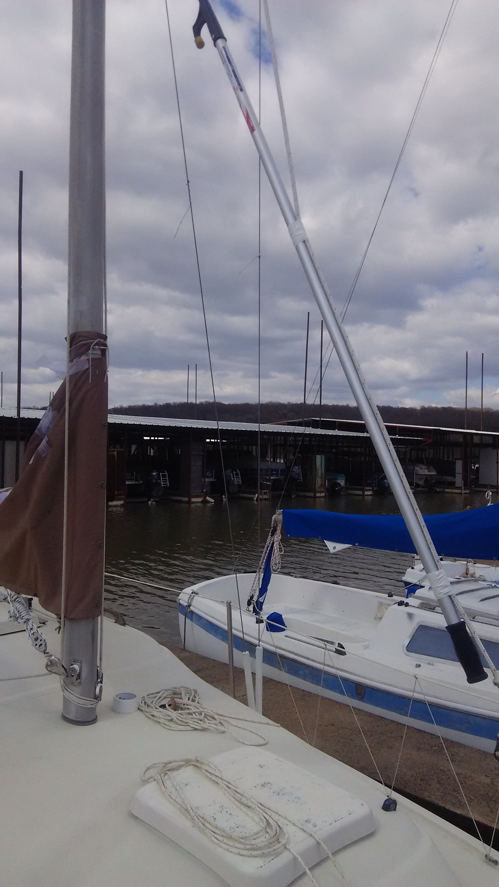

I used two sections of pic pipe 1" into 3/4 with fork taped to the end. Kink of hard to use ase it flexed so much. Did get lucky however and captured it.

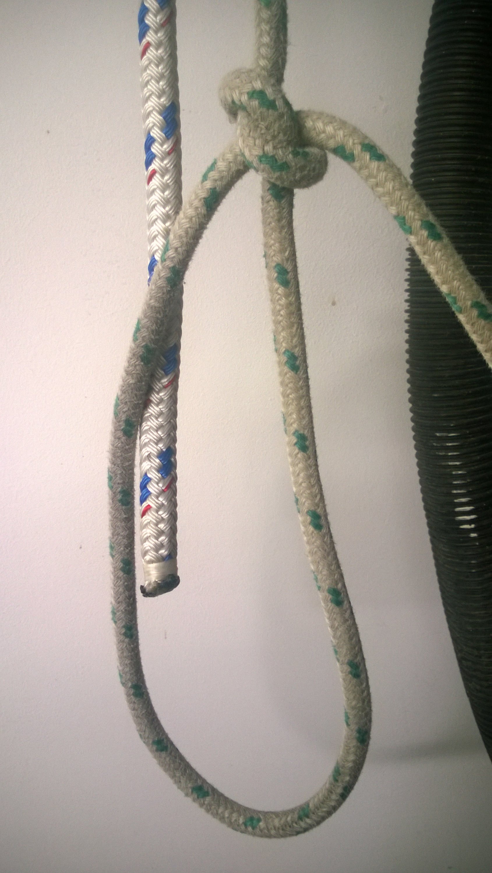

I might be easier than you think. Walk the main halyard forward and tie a big lazy overhand knot in it such that the tightening side goes aloft. Tie a bit of length small line to the bitter end such that when pulled it will close the loop forming a snare.
Now hoist the snare aloft using the small line to guide it up over the lost halyard. Yu may need to rock the boat to get at it more easily. When the halyard is in the loop close the snare by pulling down in the small line, and haul it in..

Here you can see the "Halyard Snare" in action. The While/Blue/Red line represents the loose line being finagled into the snare. Once snared simply hold the uphaul end of the available halyard and pull the downhaul (small line) to close the snare.
