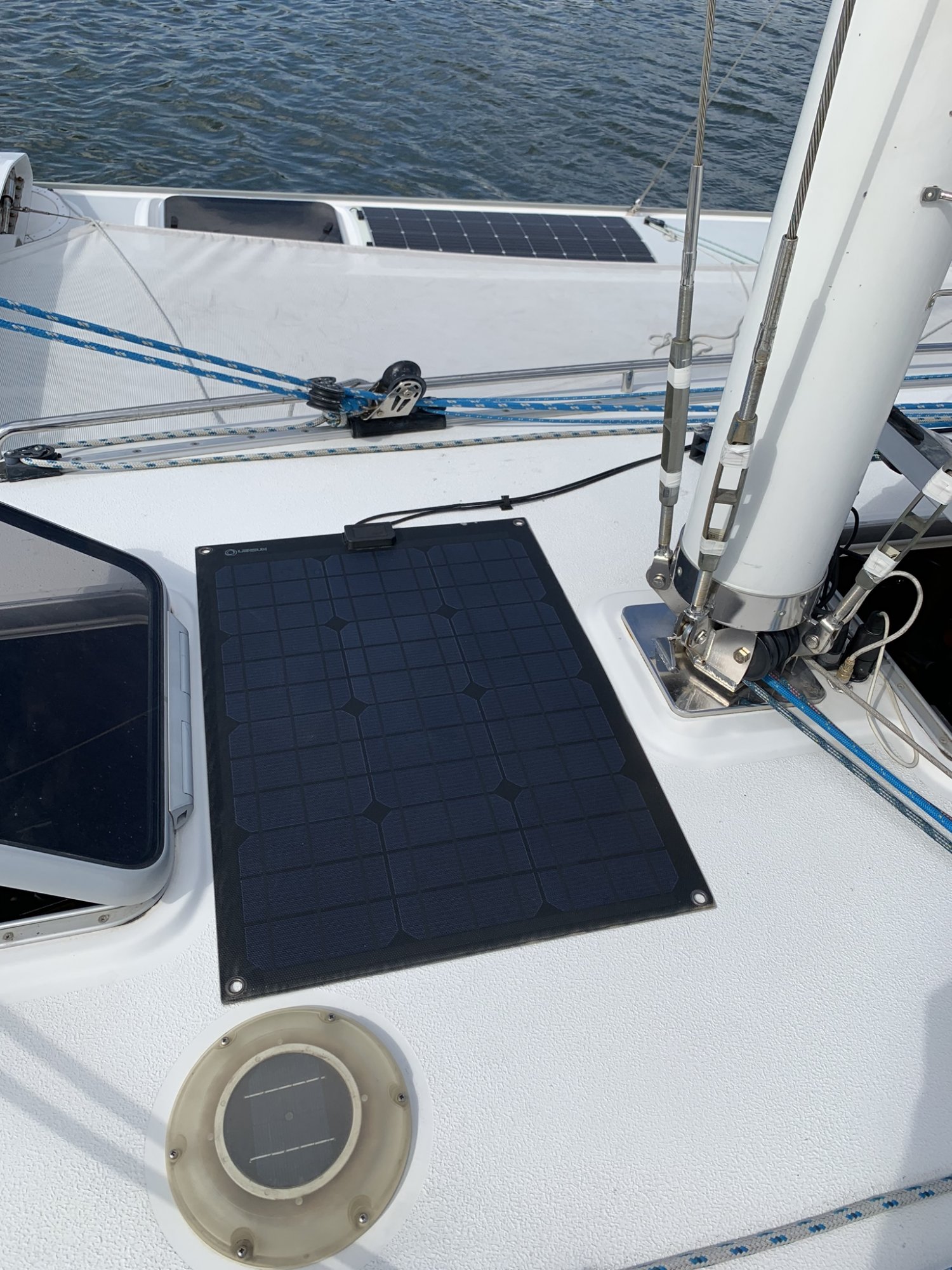

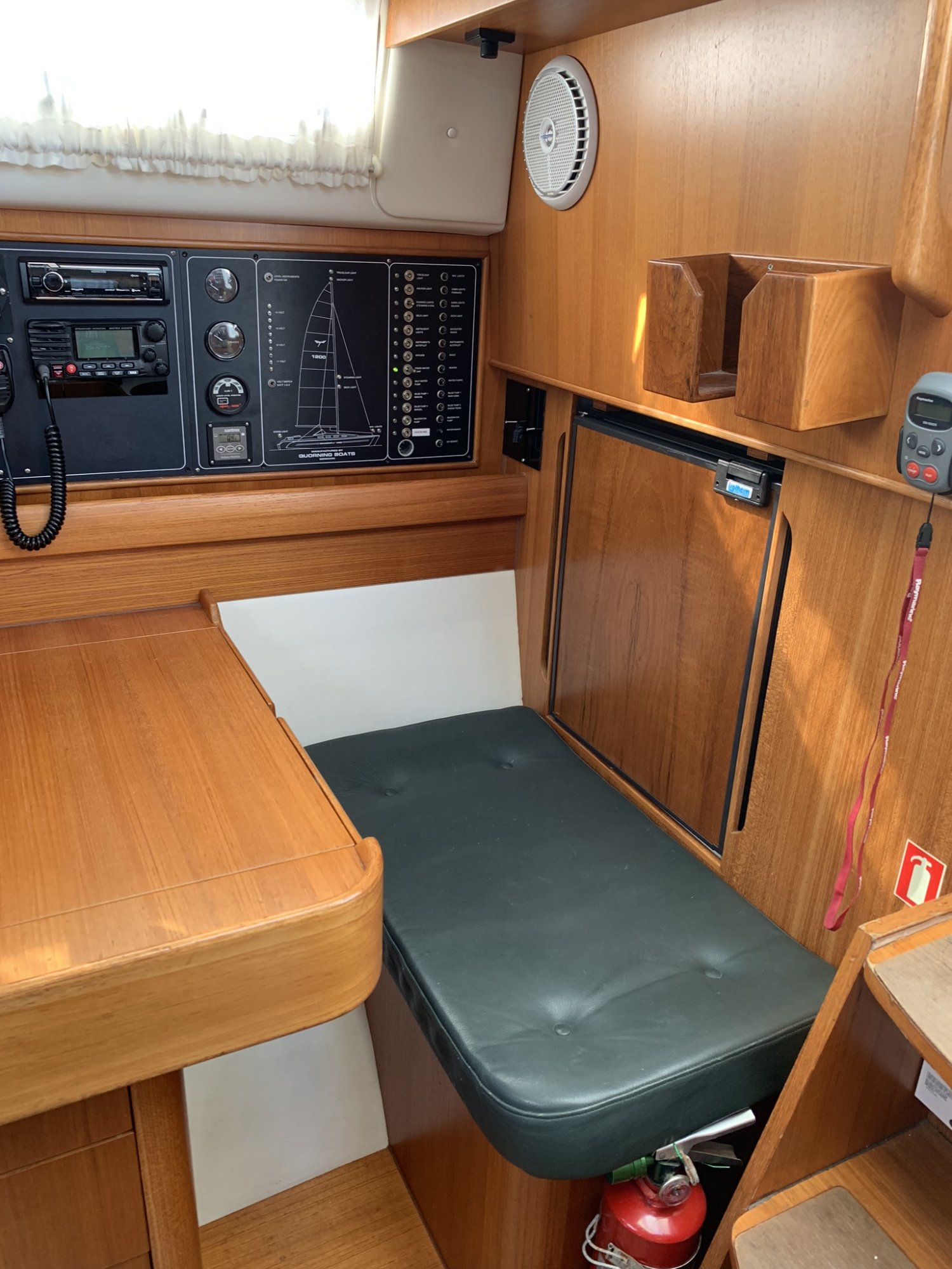

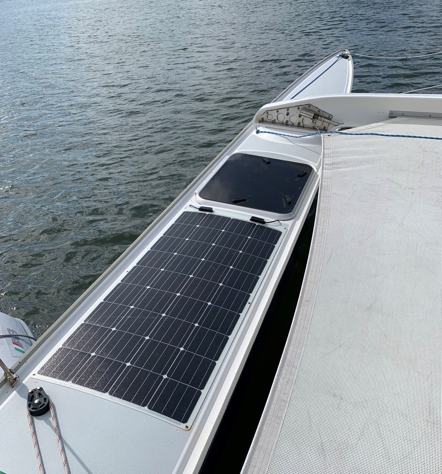

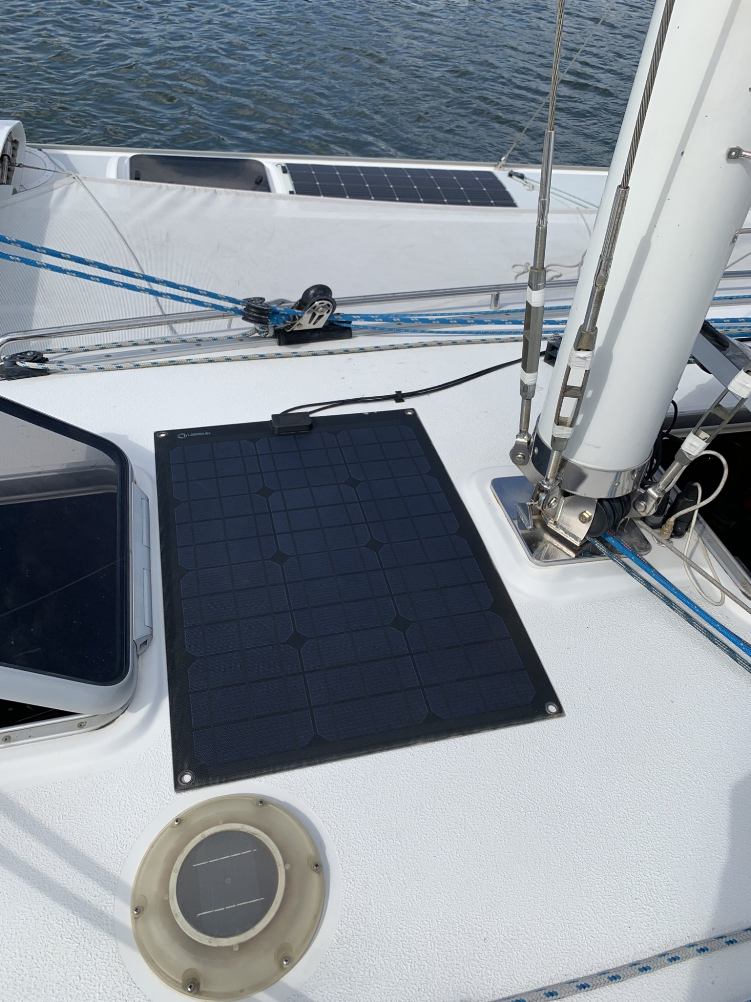

Keeping the beer cold is very expensive. 2x160w + 1x50w solar panels, each with its own controller, and a small Isotherm frig. I also have a built-in cockpit icebox that holds the stuff that doesn't need to be kept as cold (produce, etc. and yes, I still buy ice for that). My boat lives on a mooring without shore power, and the solar power is sufficient (with surplus) to leave the fridge on 24/7.

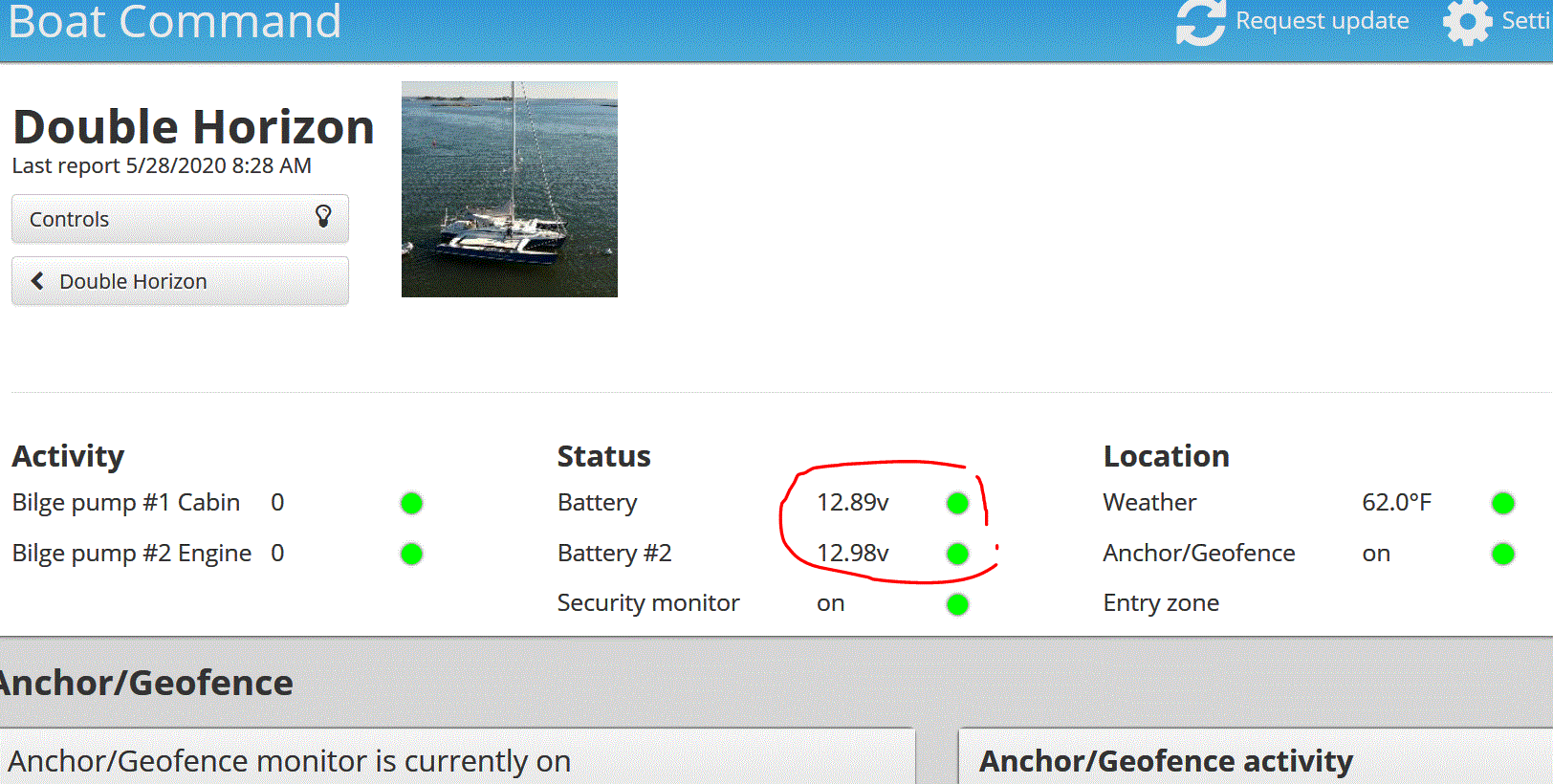

The following image shows the batteries are topped off (the boat hasn't been plugged in to shore power in 2+ years).
Frig was left on.
