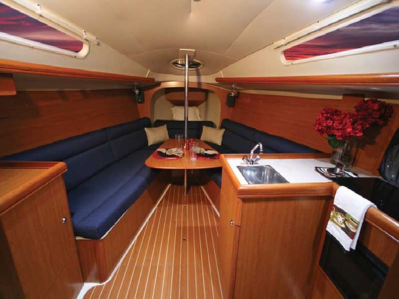

27 interior.jpg Well, I won't be able to get down to the boat before the weekend but thanks to mister google I did find a few photos of other boats that might give you an idea?

Got it, I've just never seen them described with the -1 -2 -3 designations.
You've got the rectangular base that the stanchion fits over. There are two bolts securing the base to the deck and there are nuts that are accessed from the bottom. Unlike some of the earlier base designs, there _are_ nuts... they are not tapped into encapsulated aluminum.
