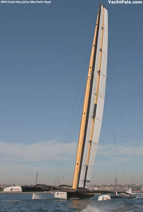

Think "WING SAIL" the closer you can make your sail look to these super efficient drivers, the better.. whether that be loose feet or tight feet..
