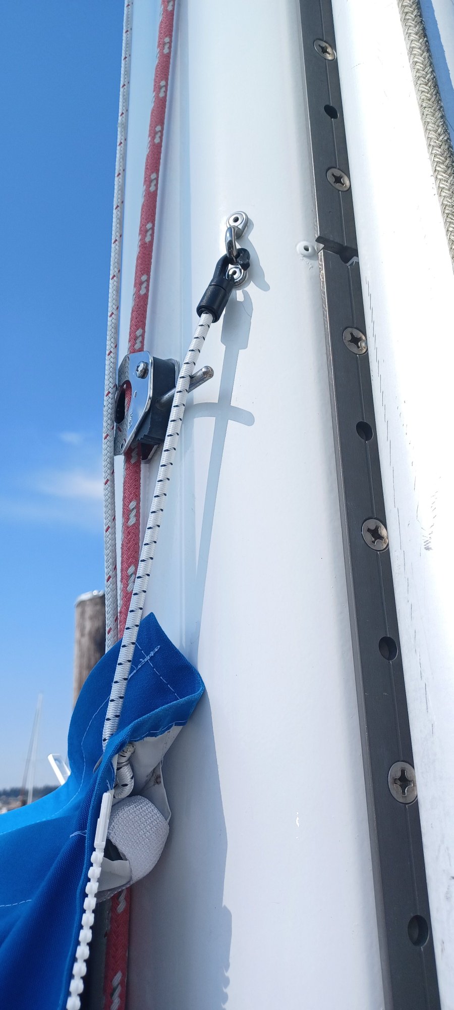

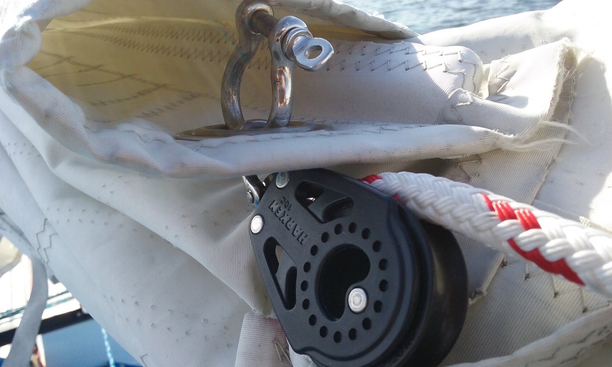

I have 1st and second single line reefing on my C30 but it uses the single continuous line system rather than the in-boom shuttle system. I found that in order to get it working well, I needed to add ball bearing blocks at the tack and clew cringles.

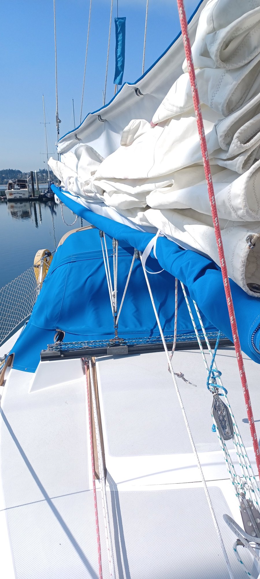

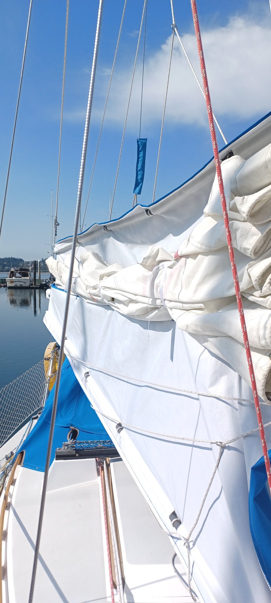

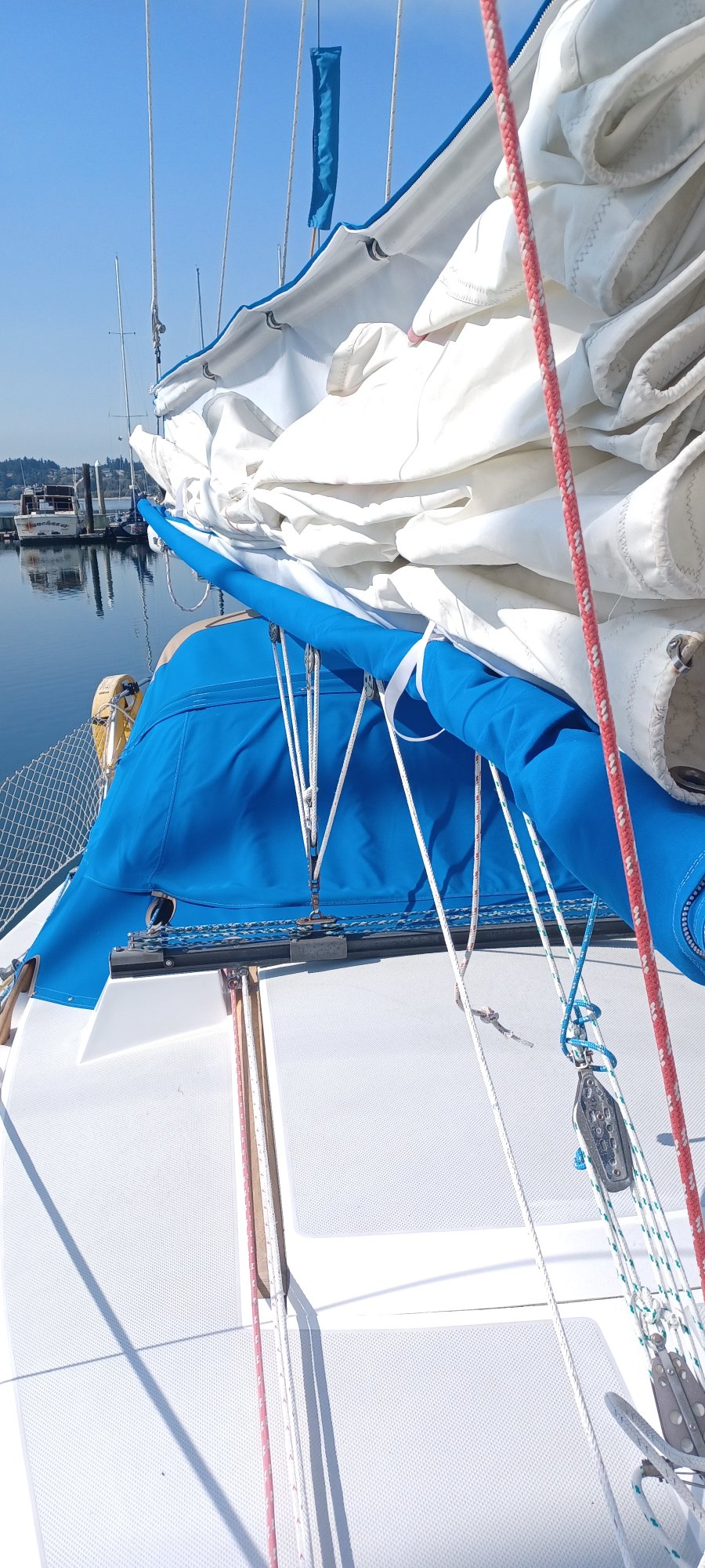

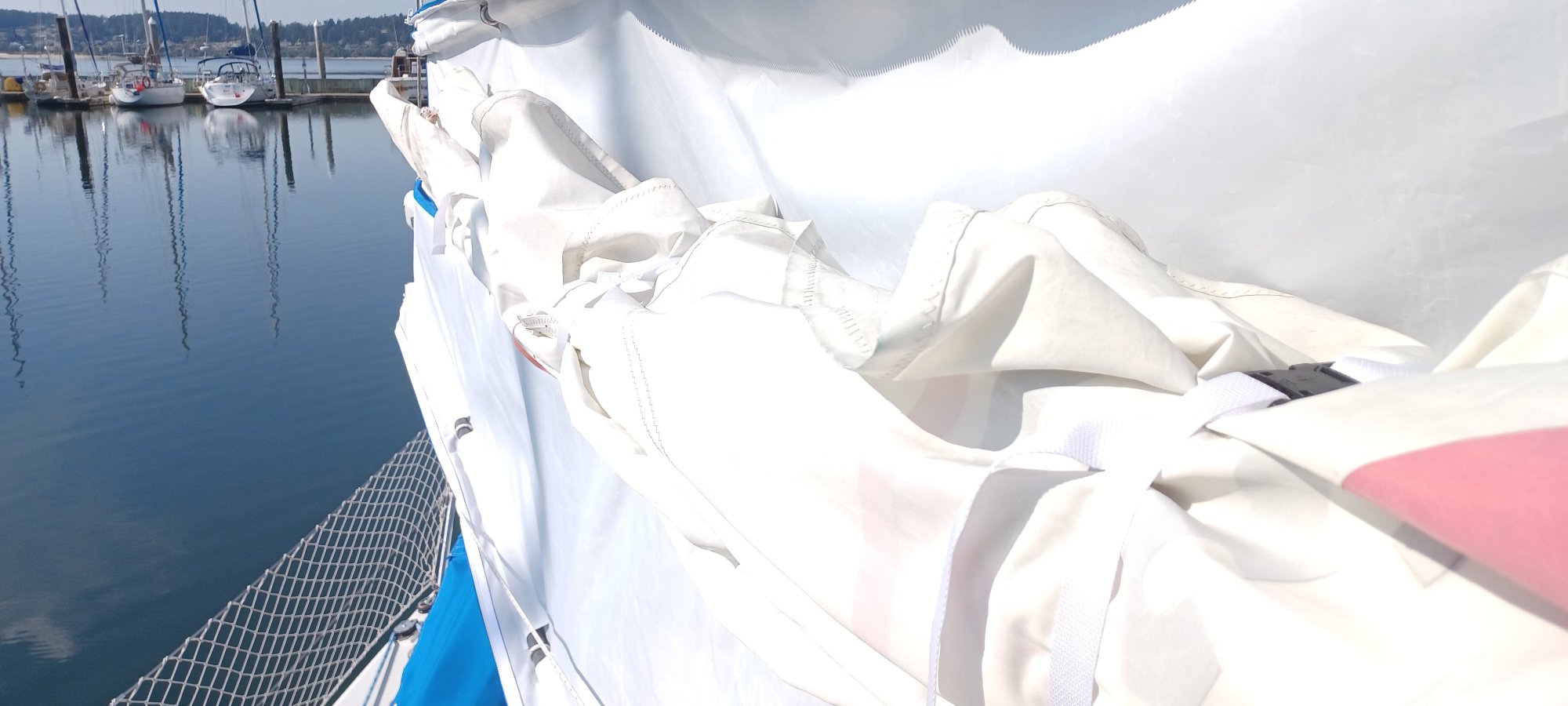

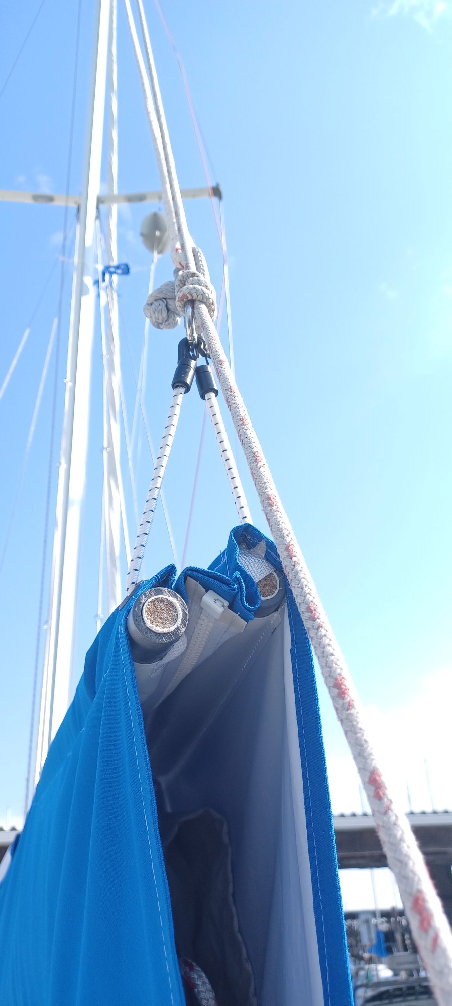

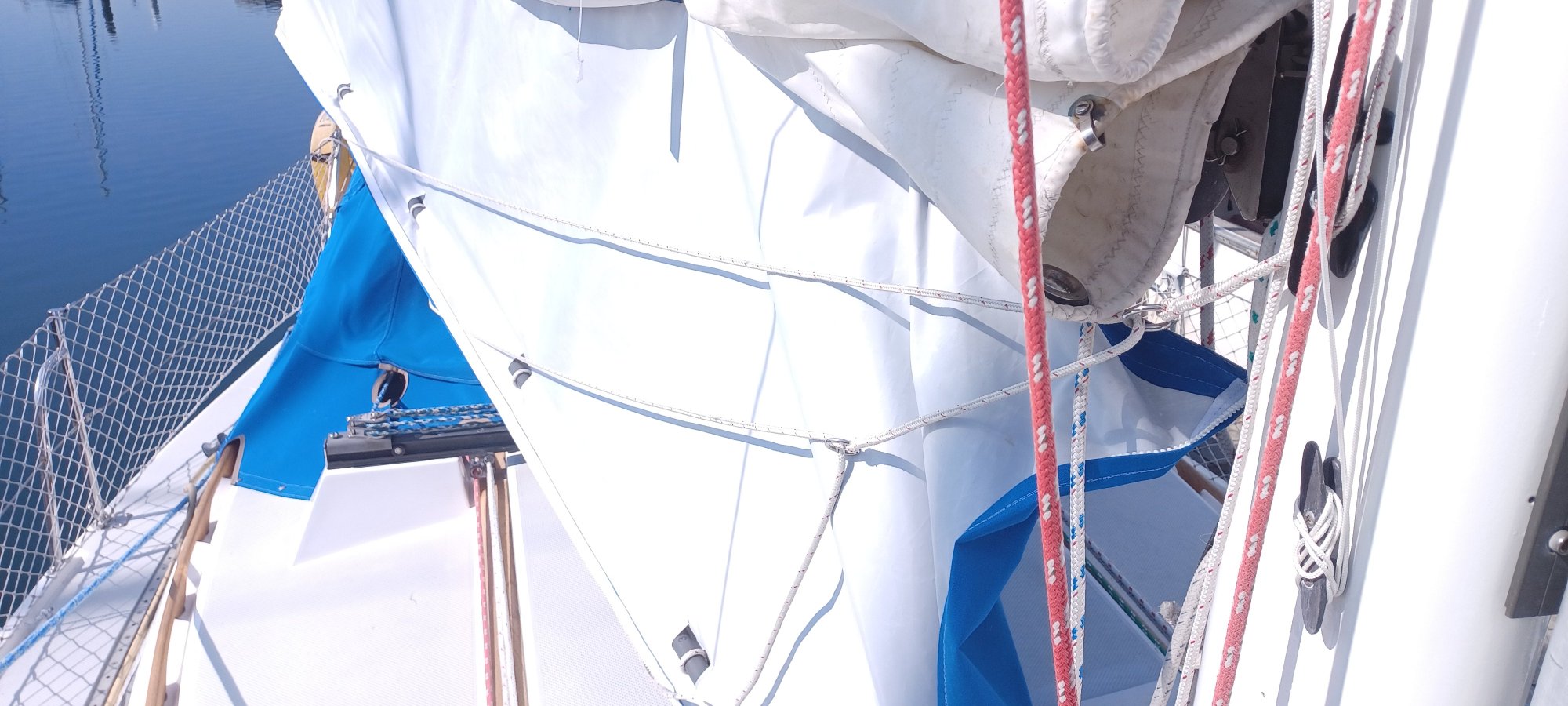

This is true of almost every stack pack I have ever seen, and I agree that it is fugly. I feel the same way about any lazy jack system that is up when sailing for the same reason. I want nothing to interfere with my sail shape when I am sailing.

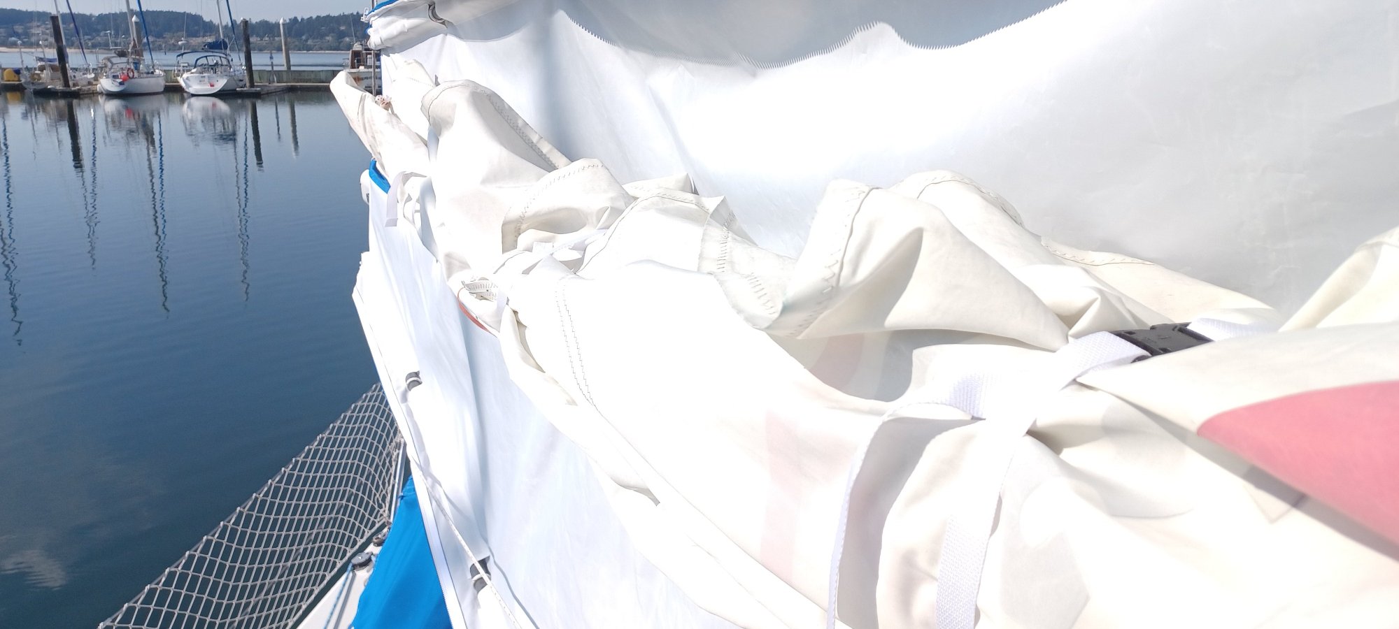

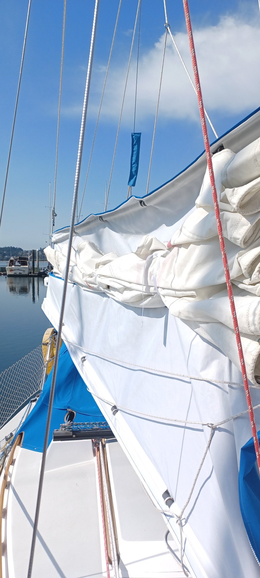

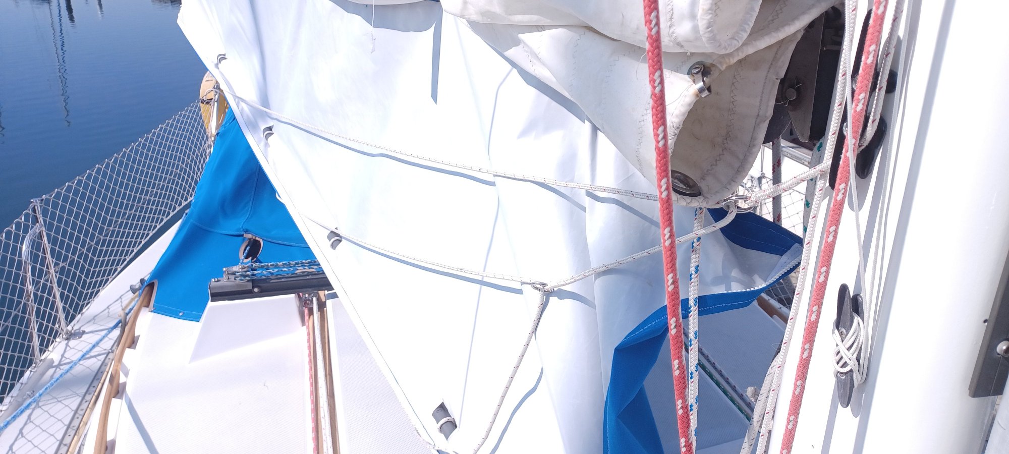

That is why I made my own. It is never up when sailing so that it does not disturb the air flow at the base of the sail or affect trim.
Likes: FastOlson

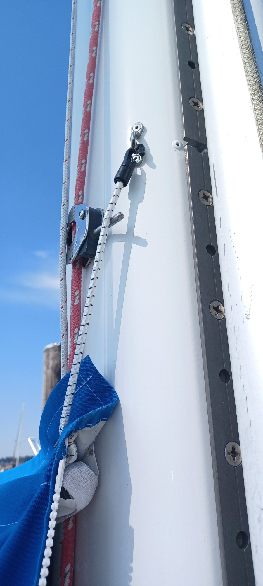

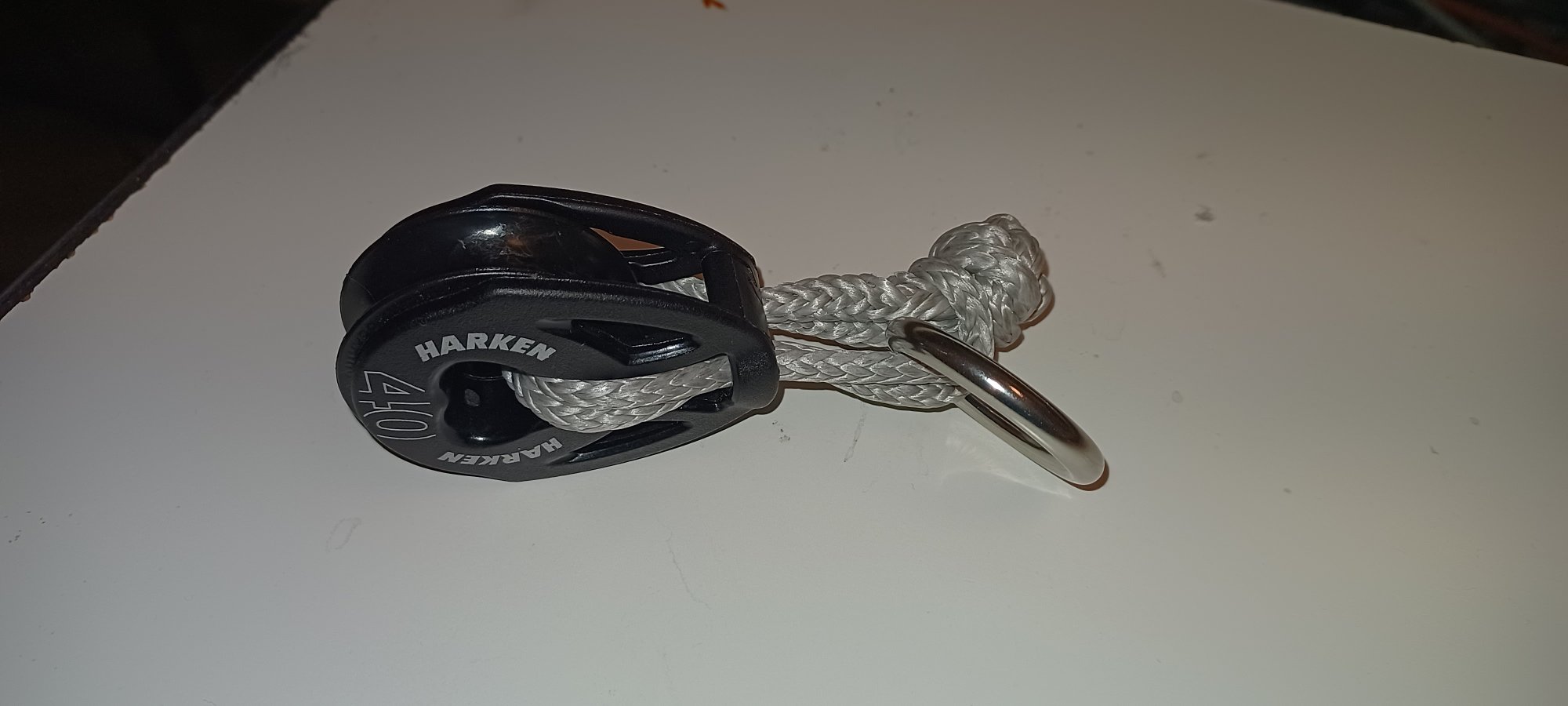

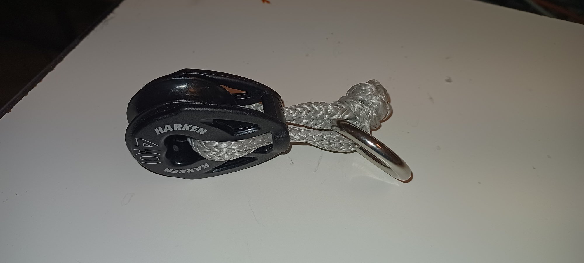

Yep, it needs the ball bearing blocks at the cringles or it will not work well. I made my current ones from Harkin Carbo blocks with soft shackles.
For the first set, I just used a couple of Harkin single blocks that I had on hand and connected them to a welded SS ring on the other side of the cringle. Here is a photo of the prototype setup where I used a D-shackle to hold it to the sail.
