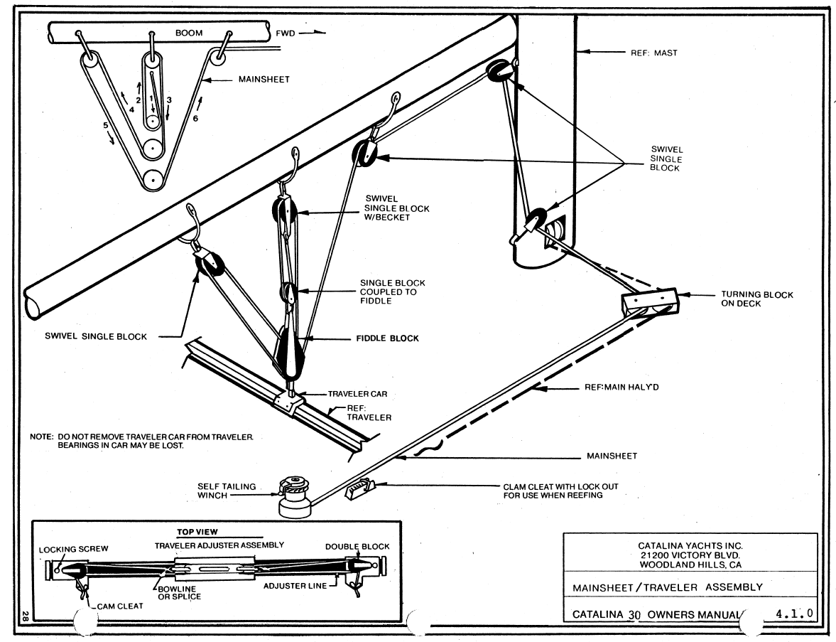

I have a C30 that has 6:1 mid-boom sheeting with 3-attachement points for the main sheet to the boom which is lead to a 16ST winch. The original sail plan had a typical bolt-rope footed main sail. In this configuration, I assume that there there is some upward force applied to the boom by foot of the sail which would not be there if the main is loose footed.
Is there any problem with using this type of boom / sheeting for a loose footed main sail? The boom is pretty robust. The section used is the same extrusion that was used as a mast for the C25 and they were never considered to have a wimpy rig.

I know this post is old, but why do folks call this a 6 to 1 sheet? As I see it, it is only a 4 to1 sheet, with the rest of the blocks just bringing the line back to the winch with no mechanical advantage (might possibly be 5 to 1). My question is, if you used a triple block at the traveler with a cam cleat on the car, to make an actual 6 to1 sheet, would that give you enough mechanical advantage to do away with the winch and bring the sheet straight aft from the car to the cockpit? This is an Oday 28 (10-ft boom and cabintop traveler).
Count the vertical line runs, 6 vertical line runs is a 6:1 sheet. See the small diagram in the top left corner.
Harken provides load calculators. Use the Mainsheet load calculator to calculate the loads on the mainsail at different wind speeds and then do the math to see if your plan would work. One caveat about triple blocks is there tendency to induce twist especially if the block is moved a lot as it would be in a mainsheet application.

Maybe there is another way for Sid to look at it. And no, it is not really 6:1.
  • Assume all pulleys are 100% efficient. This is not true, but that takes us down another rabbit hole. All purchases are less efficient than the simple number we assign, but it's an agreed upon simplification that applies to all tackles, and winches too, for different reasons.
  • The force from each leg that attaches to the traveller is the same as the number of ropes, because they all feel the same tension. If the pull on the tail is 50 pounds, the tension on the entire length of rope is 50 pounds.
  • But, of course, they are not all at a 90 degree angle to the boom, so the vertical component of the load may be only 80-85% for the fore and aft lines. The other component, perhaps 30-50%, is compression through the boom. The components don't have to sum to 100% (study engineering statics). The reason for the spread tackle is to reduce the bending force on the boom.
So yes, the actual purchase may be only 4:1. But not because the posters were wrong, but because of inefficiencies in the tackle pulleys and geometry. Also, a mid-boom tackle has less leverage than and end-boom tackle. I suspect 3:1 at the end of the boom would be as effective. But the traveler would not be.

OK, let me rephrase the question... the boom on my Oday 28 is set up like in the diagram above, and the last part of the sheet runs forward and then through 2 additional blocks to a winch on the cabintop. The fiddleblock on the car is only a double block. All ov the existing blocks are old and without bearings, do the friction in there is clearly an issue. Ann having to winch is the sheet is slow and cumbersome.
I was wondering if I used a triple block and cam cleat on the car, so I could run the sheet up-down-up-down-up-down between the car and the boom, and back to the cockpit through the cam cleat, if I would expect to have enough purchase to pull in the sheet comfortably without using the winch and extra turning blocks.
It is midboom sheeting with the traveler on the cabintop, but it is only a 10 ft boom.
