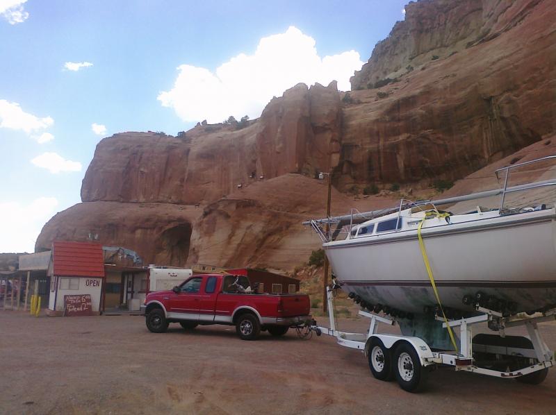

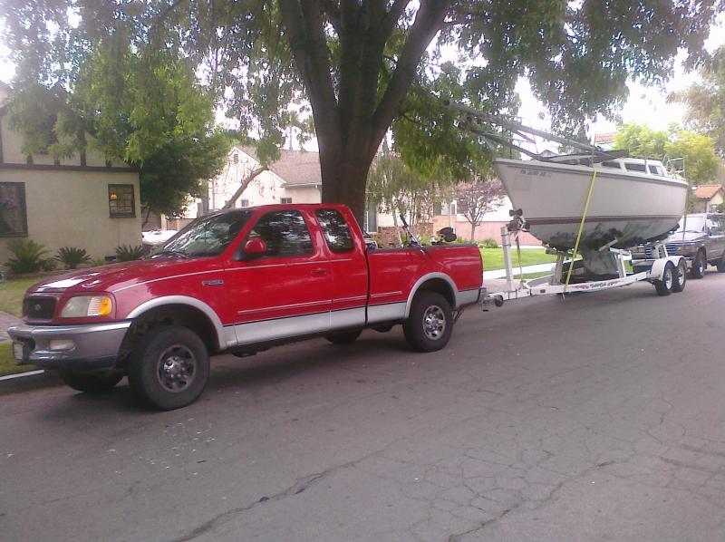

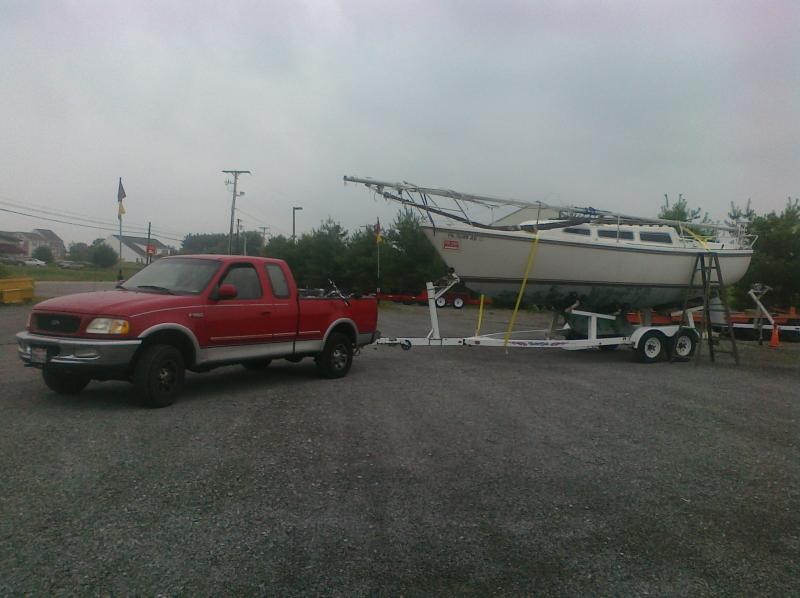

You're right the older model is 8-8. I towed all over hill and dale from Pa to Ca last year with out a (pardon the pun) hitch. The trailer is narrower and the gunnels are so high they don't interfere with anything on the road.
