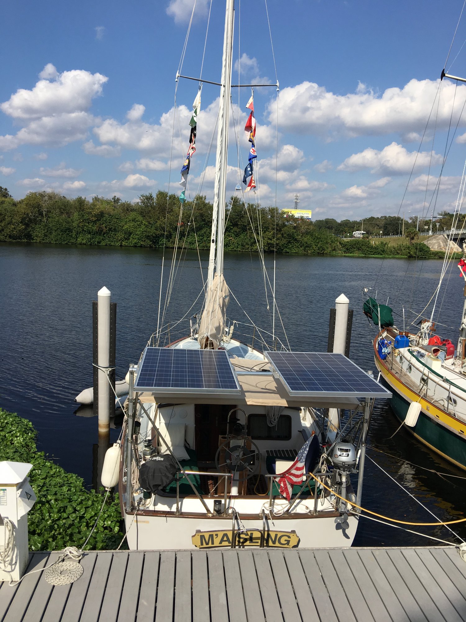

I spent a lot of time researching this. The company with the best prices was Sun Electric in Miami Fl. I bought 2 250 watt Sanyo panels at $.49 cents per watt. I bought 6061-T6 aluminum tubing (same stuff your mast is probably made of) from an aluminum supplier. Supporting braces were from Garhauer Marine. So, I have 500 watts of solar power thru an Outback MTTP controller including all brackets, bracing and tubing for $1126. The system has been spectacular for 7 years.
