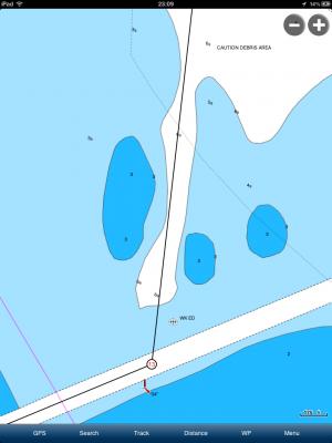

Since Katrina, it's common to go out and in without seeing another boat. I'm more concerned about depth and position as the average depth here is 3ft and if if you stray outside of the channel too far, you are screwed. I hope this image posts. Stuff like this is the norm here:
