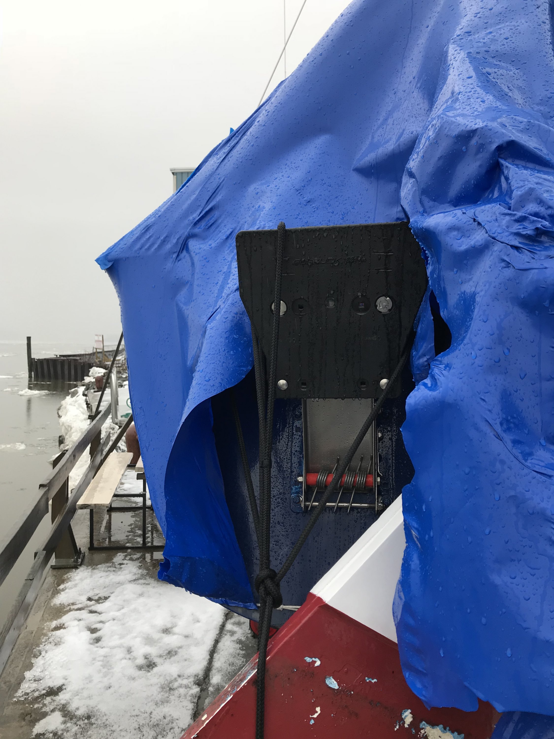

I took a couple pics this wkend at the marina - and a not so great shot of the mount is attached.

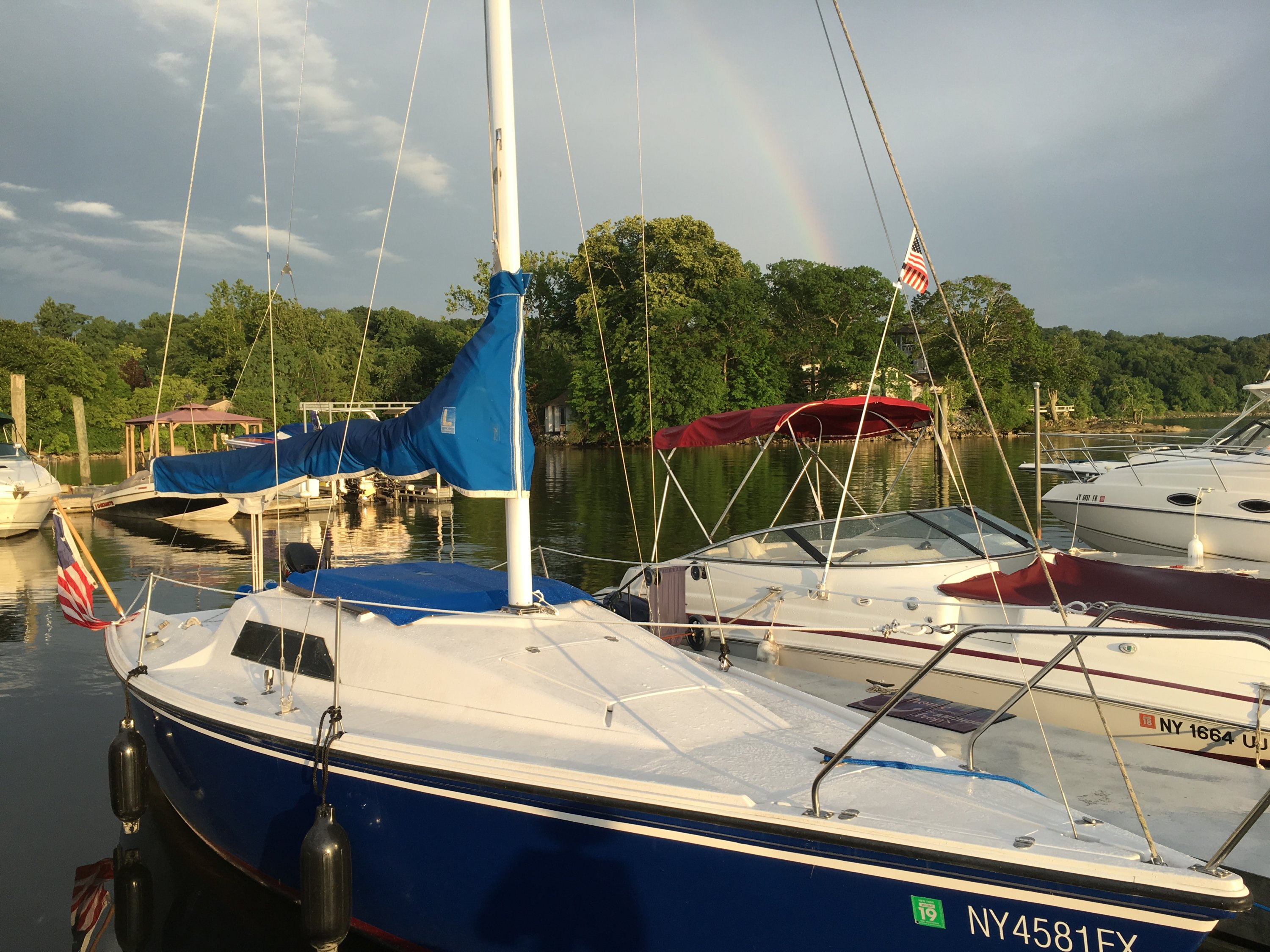

Uploaded a couple pix from when i got it - anything recognizable?

I would go with 6 HP. You shouldn't trailer with the motor mounted. Your trailer probably has little suspension and bumps act directly on motor mount and transom. Ease of lifting off, alone, should decide it for you. that's assuming you trailer her.

Drew - somebody would have had to be really overzealous - mine had a stern railing, genoa tracks, and halyards ran back to cleats on port side of cabin-top. Great boat though! I moved to Philadelphia from Upstate NY, no longer had a backyard to keep it in, and when I'm ready to keep a boat in a slip it'll be tad larger than the '23 !
