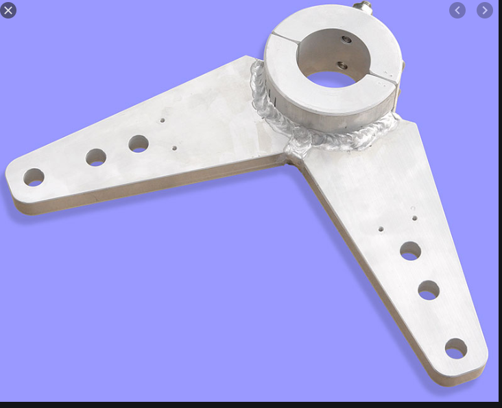

Maybe the term Tiller lever is a better name. I have seen a couple similar to the one below. For how far along - I have the equipment and wanted to fully understand what is needed before I start the work or employ someone to install.

Ah, O.K. I don't like the fact that it's welded-up like that. The "standard" approach is an Edson bronze tiller arm, admittedly at high cost (like $450).

I agree - I attached a sample - will I need to use a dual arm for the autopilot? Trying to find a person that has installed on a Hunter 33 to learn from their experience

I don’t know why you would need a “dual” timer arm, unless you are planning to use a separate “arm” for your rudder sensor.
A single tiller arm, as @jviss showed should work. A rudder sensor has no real force on it…mine is mounted on a wood block mounted on my radial quadrant.
