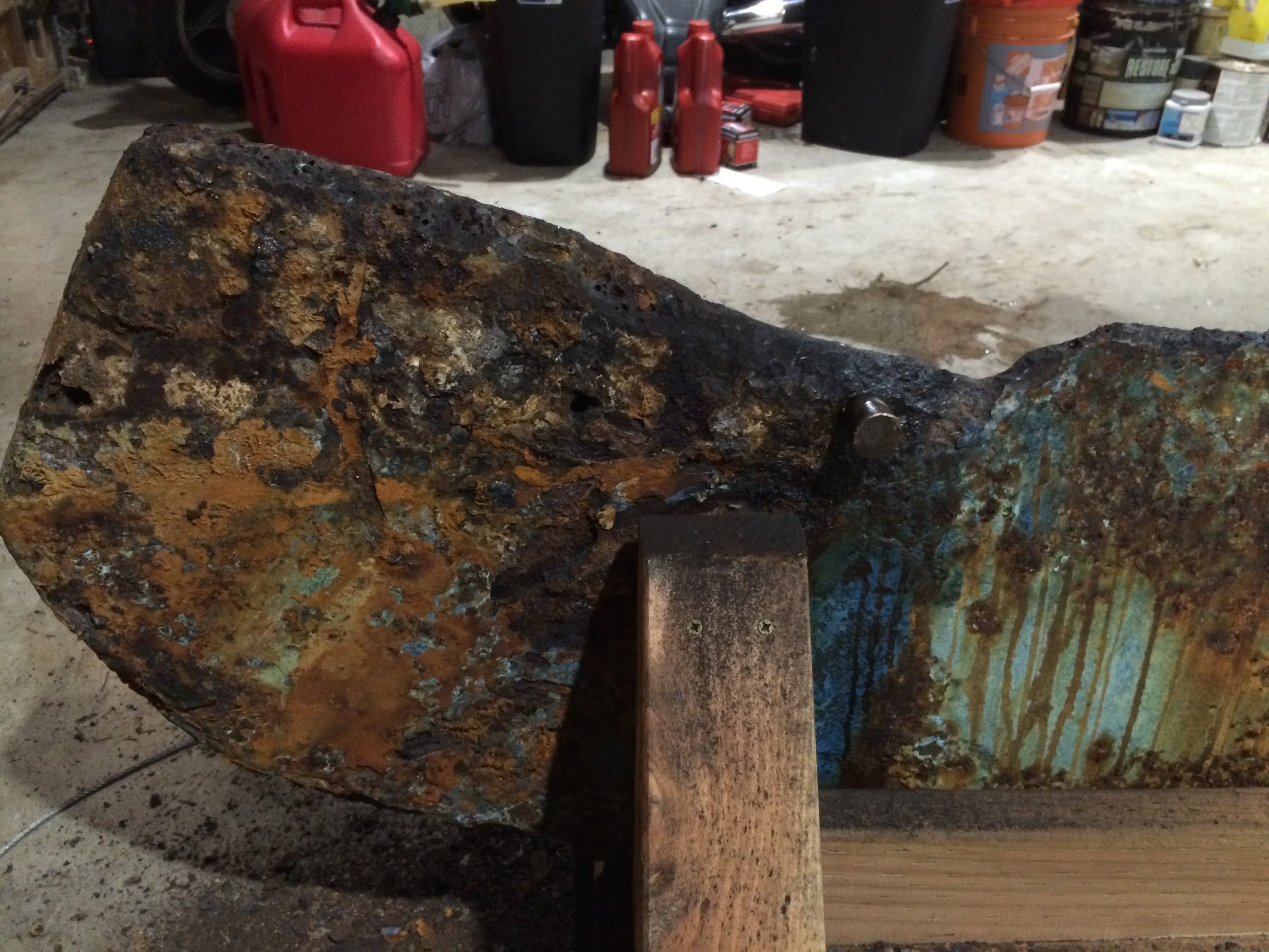

A good suggestion. I'll check them out this week. Attached are pictures of the keel pin area. As you can see, the problem is the area above the pin.

Yup, that looks pretty bad... I guess mine might have had just a bit more material to work with but hard to tell without sand blasting. I would say finding another keel that is in better shape is your best bet. To put in all the work to sand blast and then fill/shape/tape with fiberglass would be in the $500 total material cost range, and you still might feel questionable about missing that must cast iron around the pin. Try to get the used keel at a good price and hopefully you can get a scrap metal salvage cost for the old one. Even if you get less than a dollar a pound its worth it to try to recycle it. Starting with a better keel will give you peace of mind, but still sand blast and epoxy seal it, using high density filler where missing material is.
