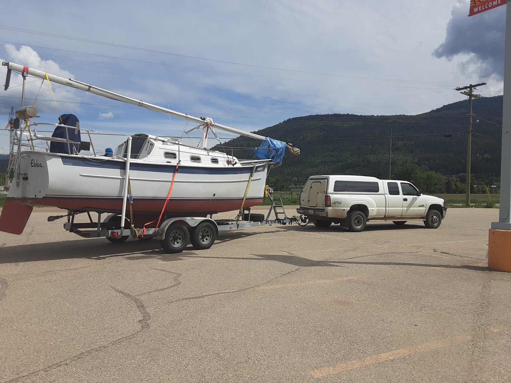

The S24/S25 is a big boat to tow any distance. I tow with a diesel GMC dual rear-wheel one ton, which definitely knows it has something behind it. Caution is always necessary when towing this much weight, and your margin of safety will always increase with a heavier tow vehicle.

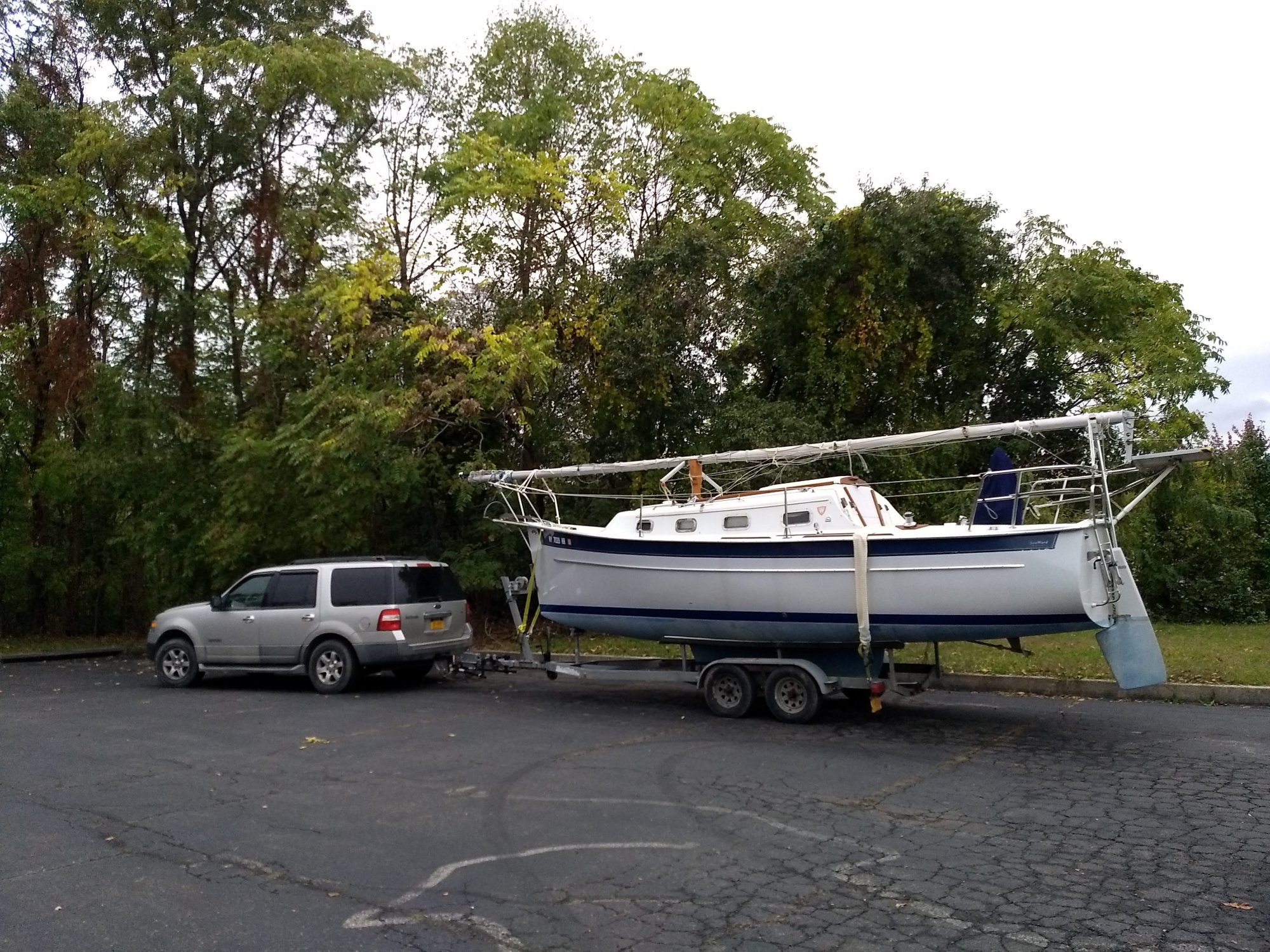

Look at this picture and tell me that the truck looks unnecessarily large for the boat!

The problem is that it's a gmc. My expedition doesn't even know it's back there :biggrin:. Actually, kinda jealous of that truck. Always wanted a 3/4 ton gmc diesel.

A nice setup, with the horsepower and weight you need. I am sure you wouldn't want anything less though.
I was going to ignore the GMC dig, but cannot resist saying that I'll bet I get better mileage out of the Duramax, towing or not!

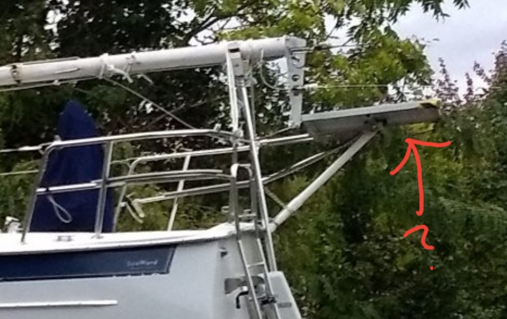

I know that I am going to get laughed at for my ignorance, but what is this?

Ha ha, nice catch. I have 2 solar panels on the boat. There is a 100 watt that installs on rails over the sliding hatch over the companionway. We remove that one when trailering. There is also another 60 watt panel cantilevered from the stern rail (the one in the pic you zoomed in on). The pvc support is only put on temporarily when trailering, to give it a little more support. This way, I can keep the house bank up when we tow it as I added refrigeration, and we usually have the fridge box loaded up with cold stuff for the trip. It pivots to get it out of the way when raising or storing the bimini. PIc below shows both in use.

Thanks sesmith. Looks like a good setup. I shall have to try something of the sort next season.

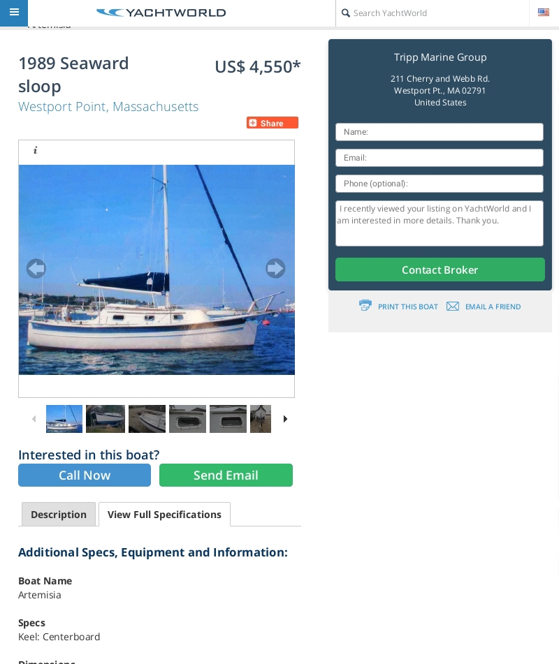

It's a little early in the season for many listings, and what there is appears very expensive or lacking a trailer or both. But there is this 1989 Seaward 23, which is so cheap that you could buy a trailer for it and still have an inexpensive quality boat. Looks very similar to the 24/25, but apparently with a centerboard. In Massachusetts.
Edit: I see it comes with a trailer! Looks like a great deal.
Second edit: Confusingly, although this has the 3 portholes per side of the S23, I read at Sailboatdata that it should be a fixed shoal keel, and that it is the S24 that has a centerboard. Maybe this IS an S24, or some kind of hybrid? Maybe someone could comment on this.
