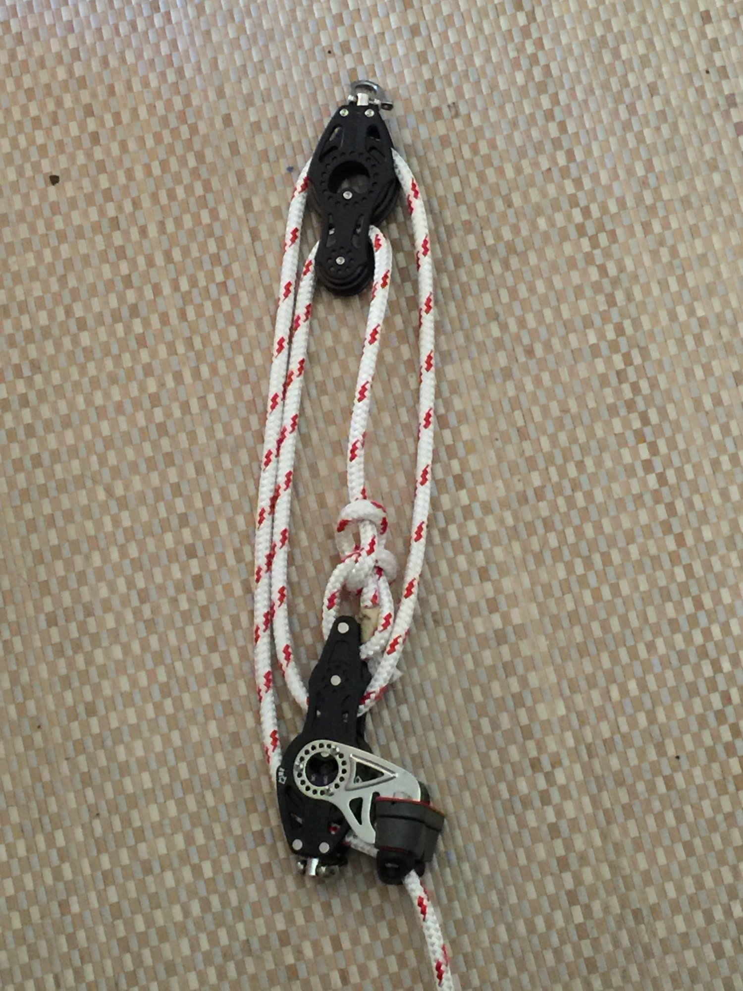

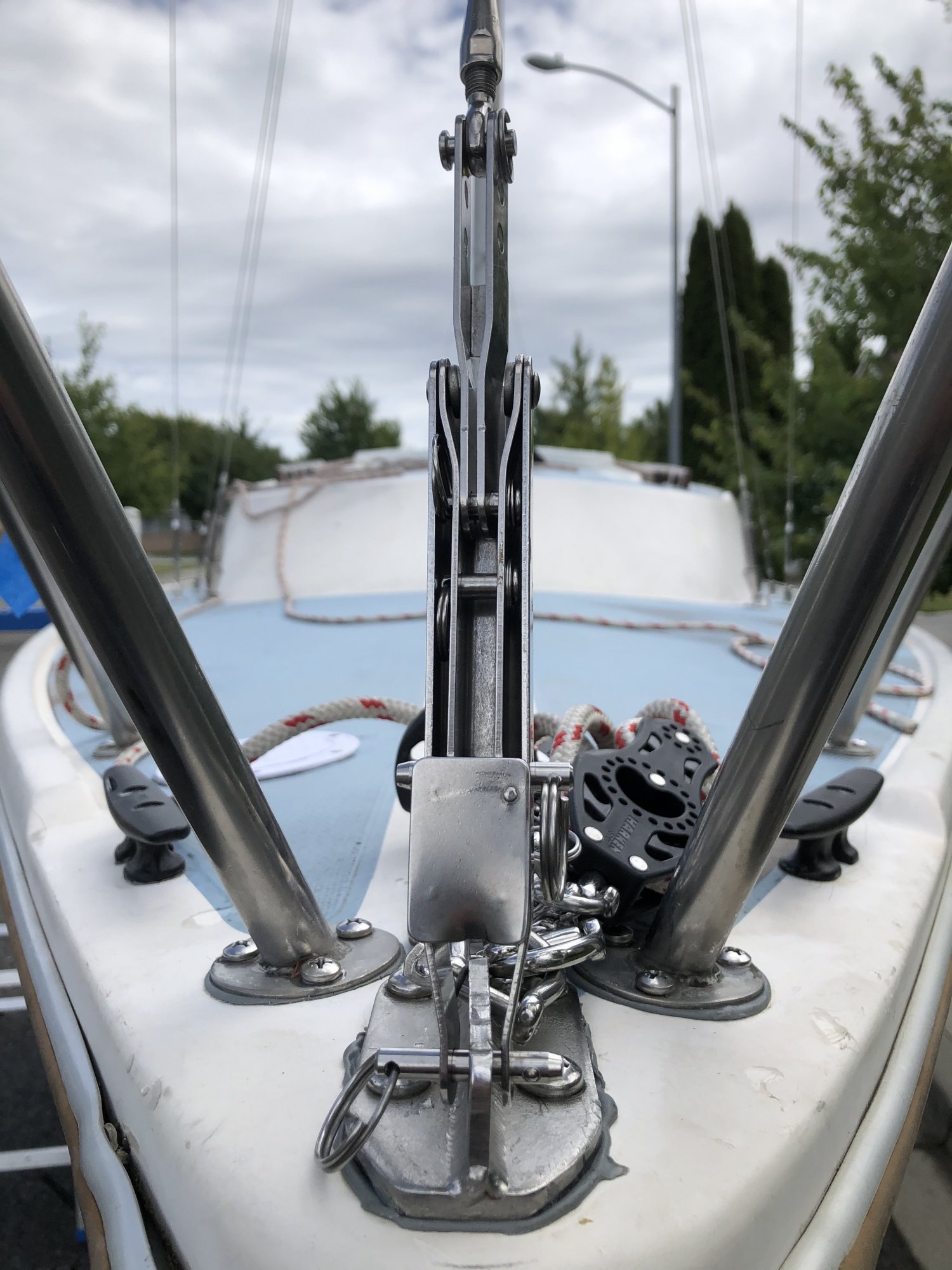

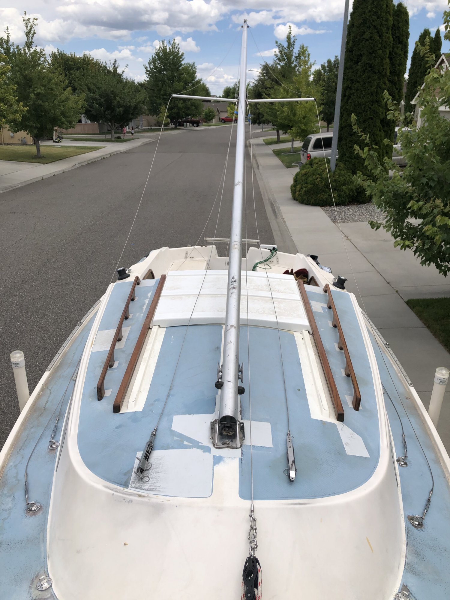

I"m in the @LakeShark camp: needs to be efficient and I only raise solo. Certainly as you raise with the main sheet tackle fixed forward to the bow stem and the forestay-- I can comfortably stand on the hatch cover mast cradled in one hand with the other dedicated to the taught main sheet tackle-- very comfortable for the fist pull and 1/2 to ensure the mast goes up straight until the stays start to take up their slack. Couple of shots of the connection details:

Horrible video attempt but it does show the connections a bit better. I tried and failed to capture video and drop with the same 2 hands -- but this does at least show the mechanical setup:
And here is the fail at showing anything useful during lowering:
