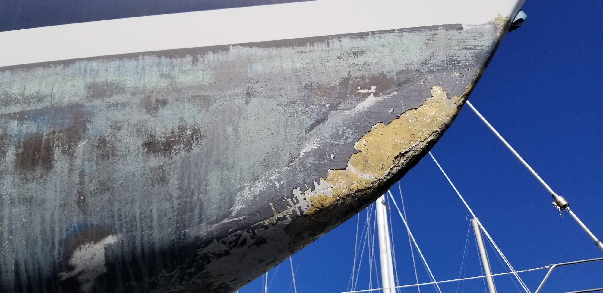

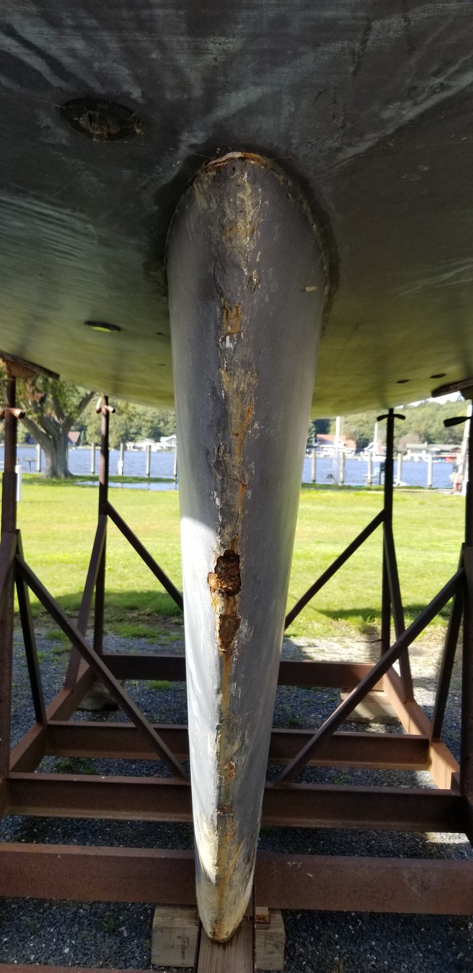

Editing the post with a few pictures I took of the hull and keel when I was up there a few weeks ago

It looks like the bow and the keel have struck things.

Because the keel had hit something you want to do a careful inspection of the stringers .When the keel hits the front pulls down and the back pushes up ,this can cause stringers to become detached or crack away from the hull.On newer Beneteaus they are glued and the glue pops and the keel will push up causing floor to rise in boat and your keel is now not supported

The keel is iron so they rust, the bow looks bad but I bet that can be fixed. Freshwater boat is a plus I think. The project list doesn't look too daunting, all boats come with project lists. If the price is good. On the plus side you get to replace the worn out stuff with exactly the stuff you want.
