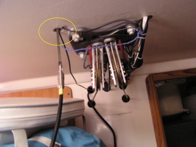

Paul, Thank you for the photos as always. Yes I also thought of switching out the VHF antenna cable, but that might be for another day. Another can of worms, but has anyone added connectors to the up-mast wiring outside the boat (at the mast base) so that you don't have to disconnect everything in the bilge when you pull or lift the mast? I hate added connectors that are out of sight, but it is a pain to pull and re-pull those cables. Drilling another hole seemed like a good idea, are the holes in the tube up top all ready or did you have to grind a new one in there also? I believe it is tradition why we keep mounting our radios below in this age of water tight and water proof electronics. So yes even thought the cost was there, mine will be below again at the panel, and the RAM MIC at the helm. (but I believe I am bringing it out the engine control panel) Being the creatures of habit, look at all the years that we sailboaters have kept our chart plotters and radar below at the chart table rather then have them at the helm where we need it. That is evolving, and your right maybe the VHF coming up top is the next step in evaluation.
Mar 22, 2011
14
Oday 240 Pistakee Lake
Through Deck Coax Connector
I used a GLOMEX through deck connector to allow for separating the COAX cable from the mast to the component below deck.

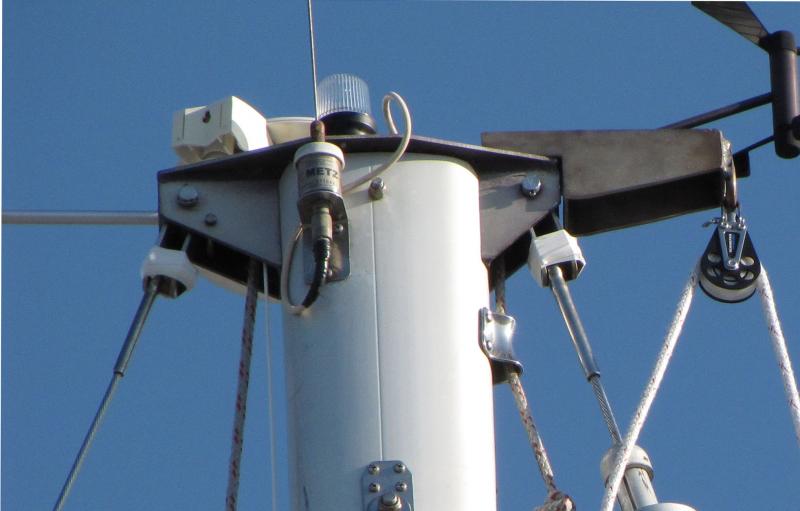

My existing anatenna is a Metz, so I'm going to replace it with a Metz Manta 6.......:confused:

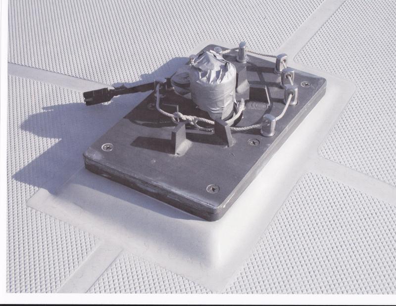

This a picture of my mast base mount in which my cable will pass thru.

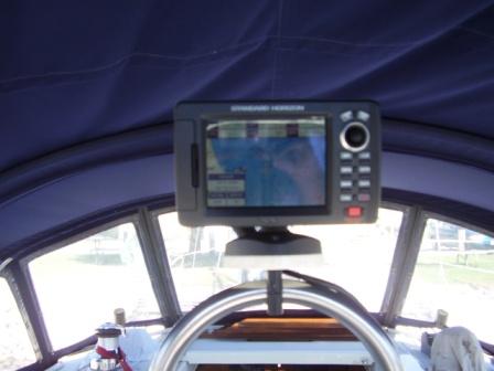

Anyone know how to pick up the NEMA OUT signal from the Flux-gate compass and into a chart plotter? (I have a Standard Horizon CP109i) and with the addition of the Si-Tex Radar they say I also need a heading sensor. Well we have the flux-gate from the Raytheon ST4000. I've tried contacting Ray Marine :cry: no response, and I tried Standard Horizon :doh:so my only hope is that someone has seen this before and solved it. :eek:
Where is your GPS located for your CP 109i ?

The CP109i is at the wheel, and has it's own GPS. Has worked fine so far. I was going to pick up the GPS from here to the radio (same make) but through an interesting (Long Story) I now have the separate antenna for Free so hooking that to the new VHF GPS. Even with all the information talking back and forth, I can't do a radar overlay without the heading sensor (compass). I have been told that the flux-gate talks to the Ray unit through NEMA, as it is wired separate of the Sea Talk - (hence my hope is no extra box needed.) I will look to see if I have a photo to how, I know I have the mount bracket I made so it swings around to see at the wheel or when hiding under the dodger.

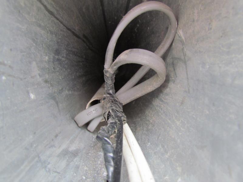

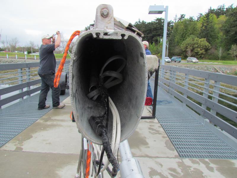

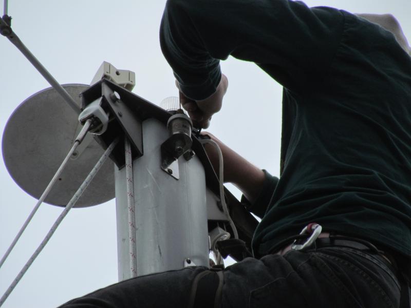

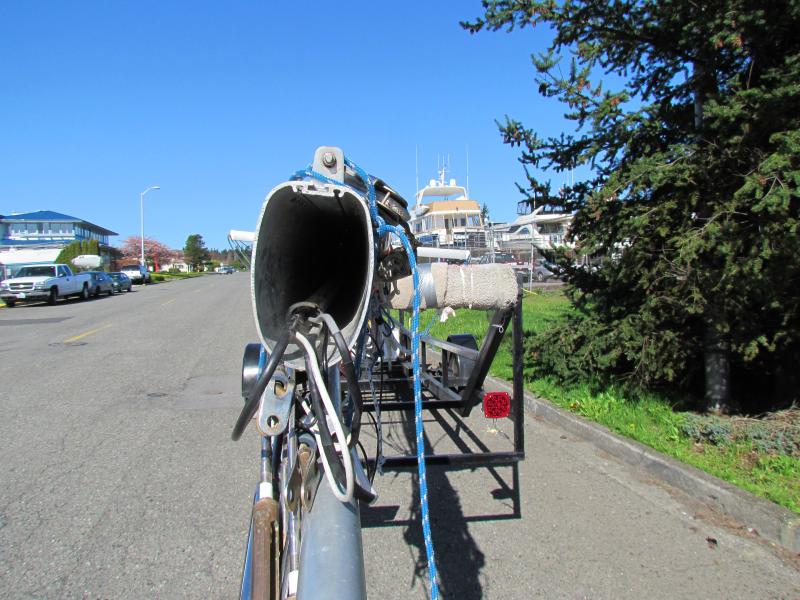

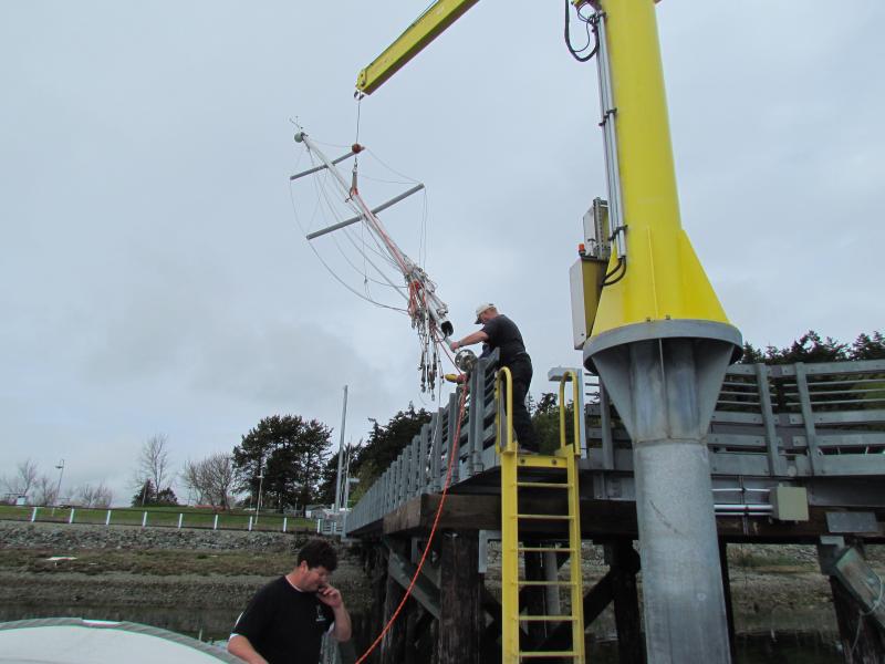

In order to install the new VHF radio, seems to me that 75 feet of new coax Belden 9913 f7 cable would fill the bill, now was the time
to remove the old cable. Had a rigger on top of the mast and use the old wire for a chase wire to pull the new cable...........
could not move any of the cables up or down:naughty:
yup you guessed it..............
God Bless Them.......whoever...........installed a drip loop :eek:.
I had to pull the mast today and will work on it over the weekend, so if anyone has any mast questions now is the time...........

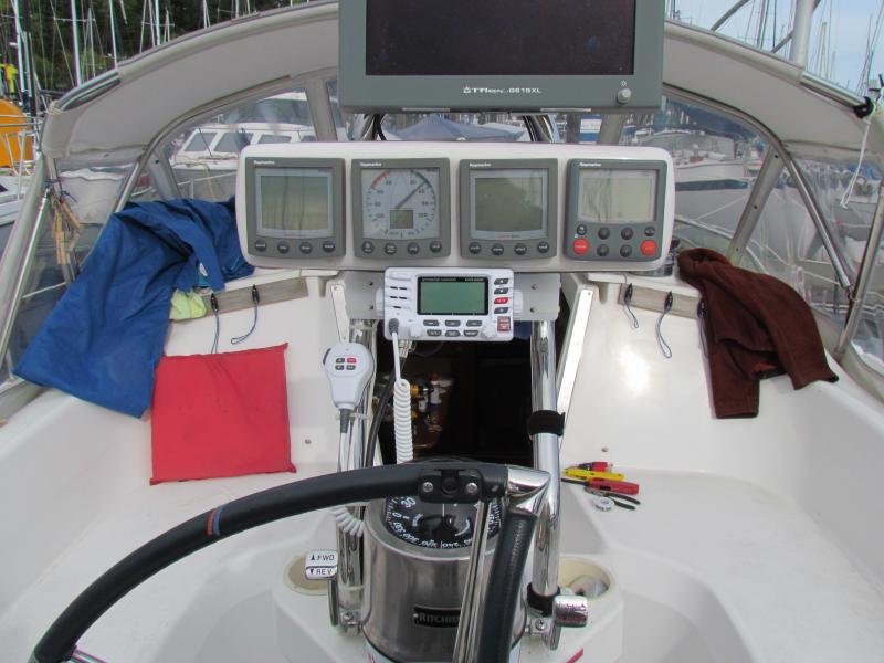

Well the new VHF radio is installed.
Sunday, when the tide is just right, the mast will be installed .........then comes the power check.
Sunday afternoon, I'm number three in line for having a mast installed.
paulj :troll:
