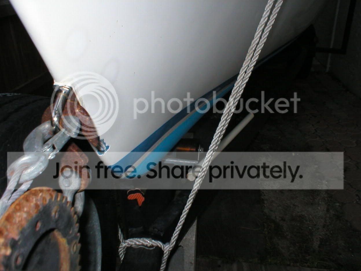

Another question - we haven't been on the road with this boat but once, and we were wondering what is common for tie-downs on a 25' boat?
Most important are the tie downs that prevent the boat from sliding forward ... like during a panic stop by the towing vehicle. You definitely dont want the boat to slide into your truck when you hit the brakes hard.
