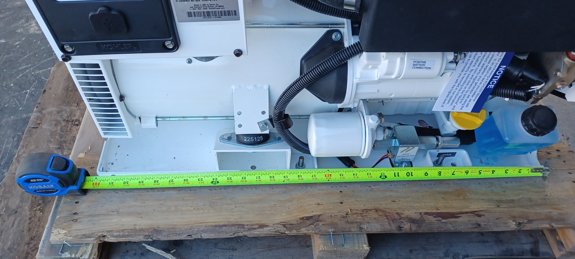

My new Marine Generator has Lombardini engine, 16 hp. It is lighter and more efficent than my old 16 hp Yanmar.
_____
a couple of things would give me concern: Fuel filter and sea water pump is on the back side of the engine.
Not on mine. Every thing, including the pencil Zinc, is all in the front. In fact, it Blue Tooth's to my iPad and shows all info when running.
But not my main engine, which is British made or Volvo.
Jim...

My genset is of course different from a main engine drive.
@kloudie1 every serviceable thing is in the front.
