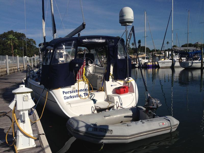

I have a pole mounted hoist. I can lower my motor, a Lehr 5 hp @ 57 lbs, with one hand. My previous motor, a Yamaha 4 stroke, 4hp was 67 lbs. Very easy with this setup. It is made by Ocean Marine Systems.
The photo below shows the Yamaha mounted on the dinghy. The enclosure is hiding the Edson outboard mount. This has been a very convenient way for me.
