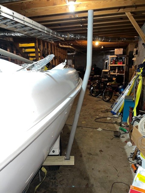

A better bolt on option is a bunk guide. I had planned to make one for our Catalina 22. Here is a Hunter 18.5. on a trailer with them:

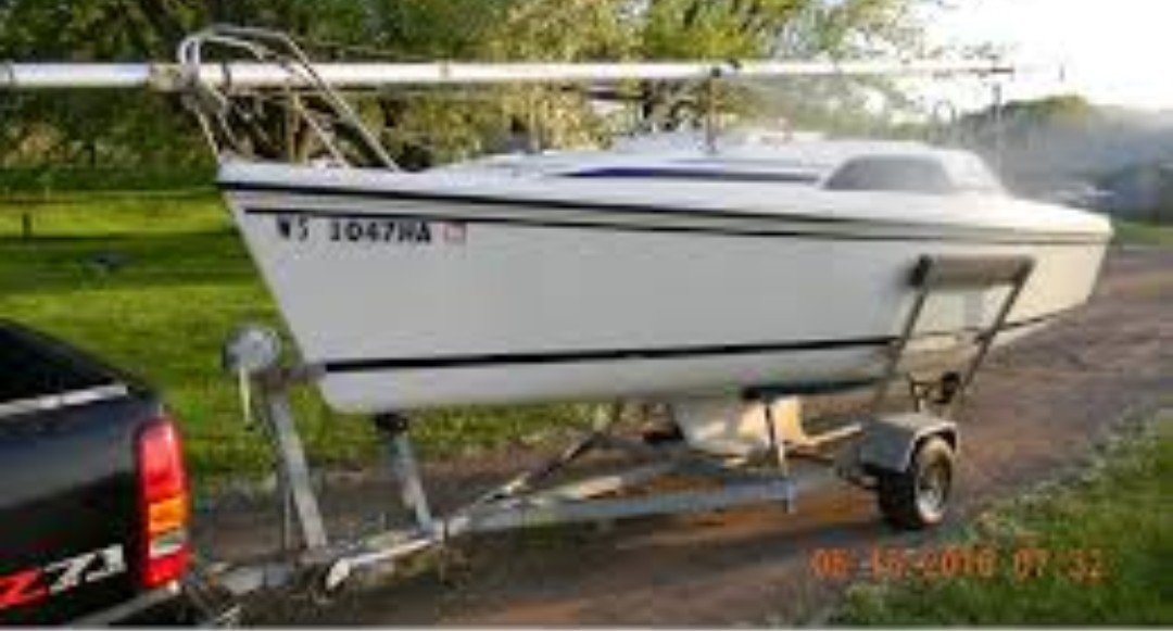

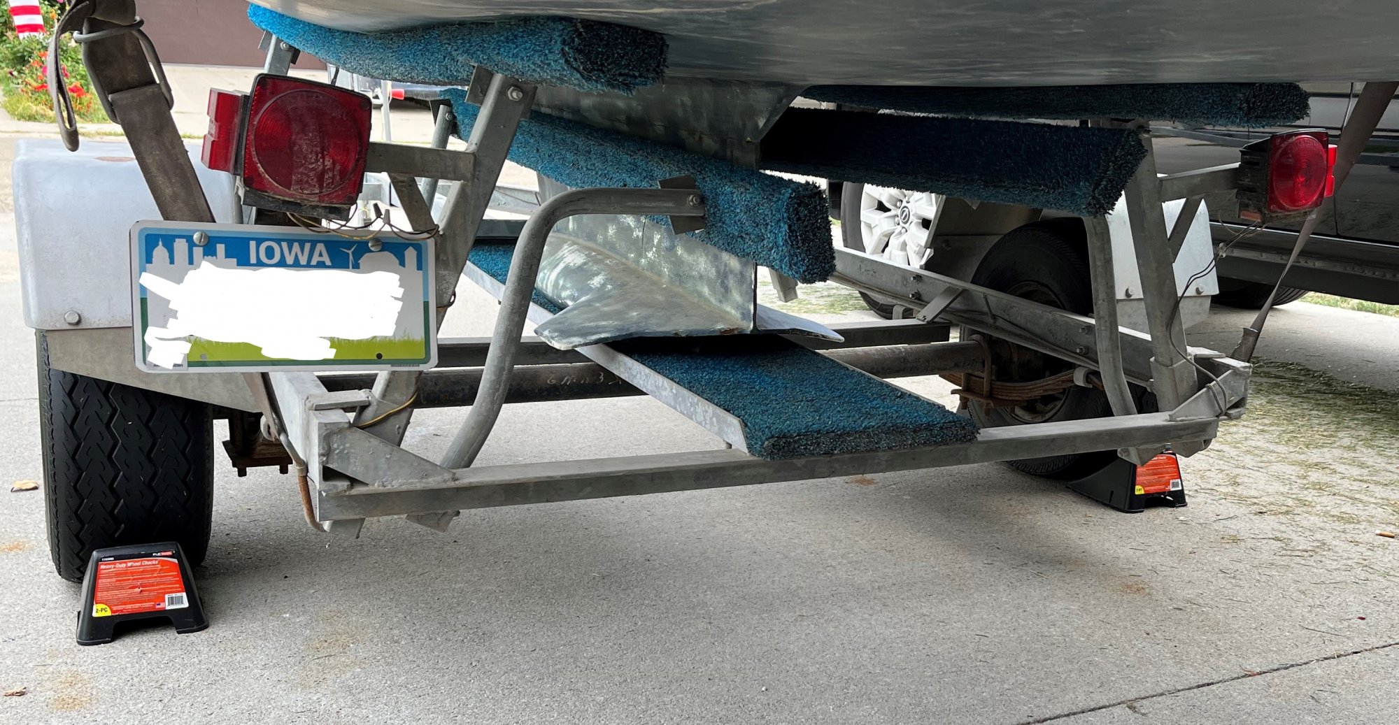

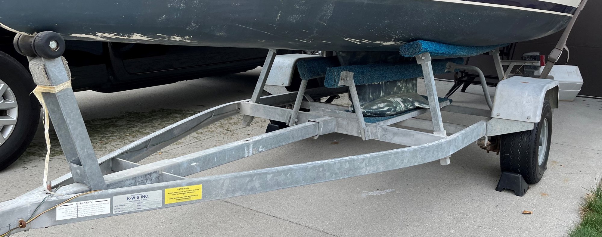

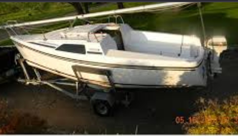

Here are a couple of photos. Draft is 2 feet. View attachment 210064View attachment 210065
Looks like it is sitting correctly in the photo. Weight on both the keel and the Hull.
The keel guide would likely work better if the aft end of the guides was angled towards the sides so that as you pull on, the keel is pushed left or right until it sits in the middle. A funnel shape.
But.. And this is a big but... That keel guide width looks like those wings would hit it when you are loading with the trailer too deep in the water.
In that case, as the boat and trailer came together, the keel could easily be ABOVE the guide at the start (not behind It) and as it moved down towards the trailer while pulling out,.. the wings would hit the top of the guides.
Is that the problem occuring?
You would need to ensure that the trailer and boat were close enough vertically so that the keel would slide into the guide from behind, as opposed to lowering itself onto it.
Because of the wing keel, I would remove the keel guide and reuse/modify it as bunks that guide the Hull, like that shown in the photos above, and keep the keel support pad. That way the boat and trailer could simply come together vertically, in various ramp depths.
