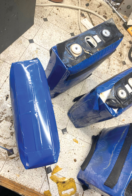

Overcharging. Attached is a pic I borrowed from Rod Collins showing the "damage" caused by overcharging LFP cells to 100V until they completely failed. No fire, no smoke, no explosion - just a lot of swelling and graceful failure. I can confidently state that charging lead batteries to 100V will result in explosion and fire and acid everywhere. If you are near them, you are dead.

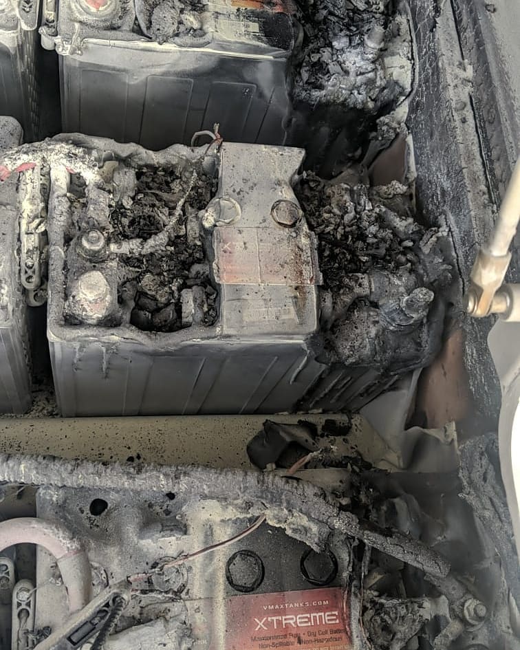

I leave you with a picture of a boat that burned beyond saving from their lead batteries being overcharged in a hot environment. Lead batteries are very dangerous. Much more so than LFP.

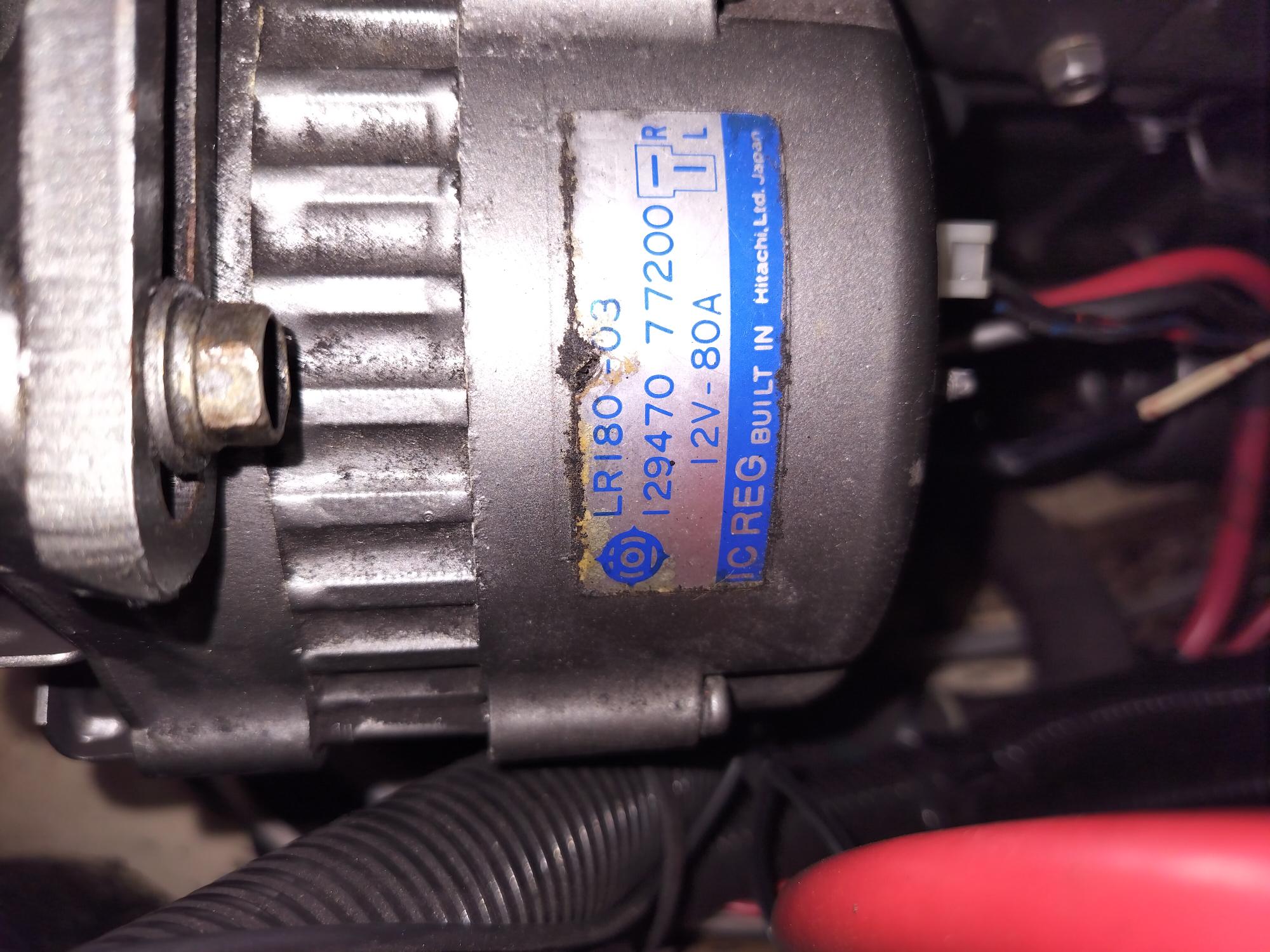

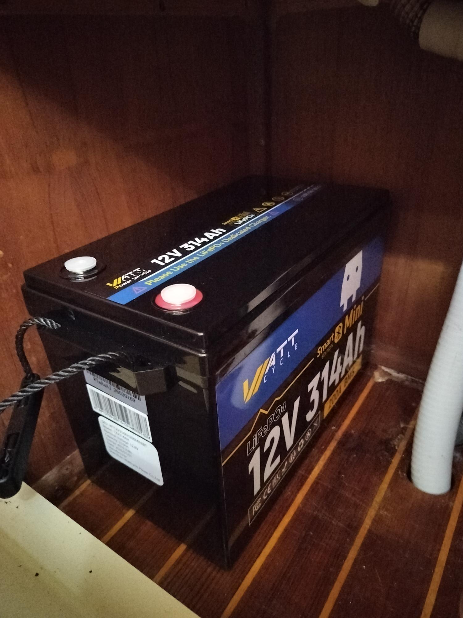

Original Poster here: Back to the subject at hand. I appreciate everyone's input and perspective.
I have purchased one of the WattCycle 314AH LiFeP04 using Rod's discount code (Thanks Rod). I've had a little delay in getting it installed due to some health issues so it is on the boat but not hooked up, sitting at 53% SOC, which I understand is about the right SOC for storage. It will be placed low in the boat under the sinks with a short run to the Electrical Panel as shown. The Lithium Battery is about 12 feet from the Solar and the Sterling AC Charger and about 2 feet from the FLA starter battery. I have attached some pictures of the equipment I currently have onboard. I know the OEM Hitachi 80 is not the ideal charger but I'd like a "strategy" for installation that allows me to use as much of the equipment have right now and still keep the system healthy as I upgrade the Alternator. There have been some recent discussion on a similar situation and I have been keeping track of that. It will be well restrained from movement.
I do not have a DC-DC Charger but will probably need one?
Equipment I have:
OEM Hitachi 80 (dumb) alternator (with powered exhaust vent position just behind and above the alternator - might not do much good though)

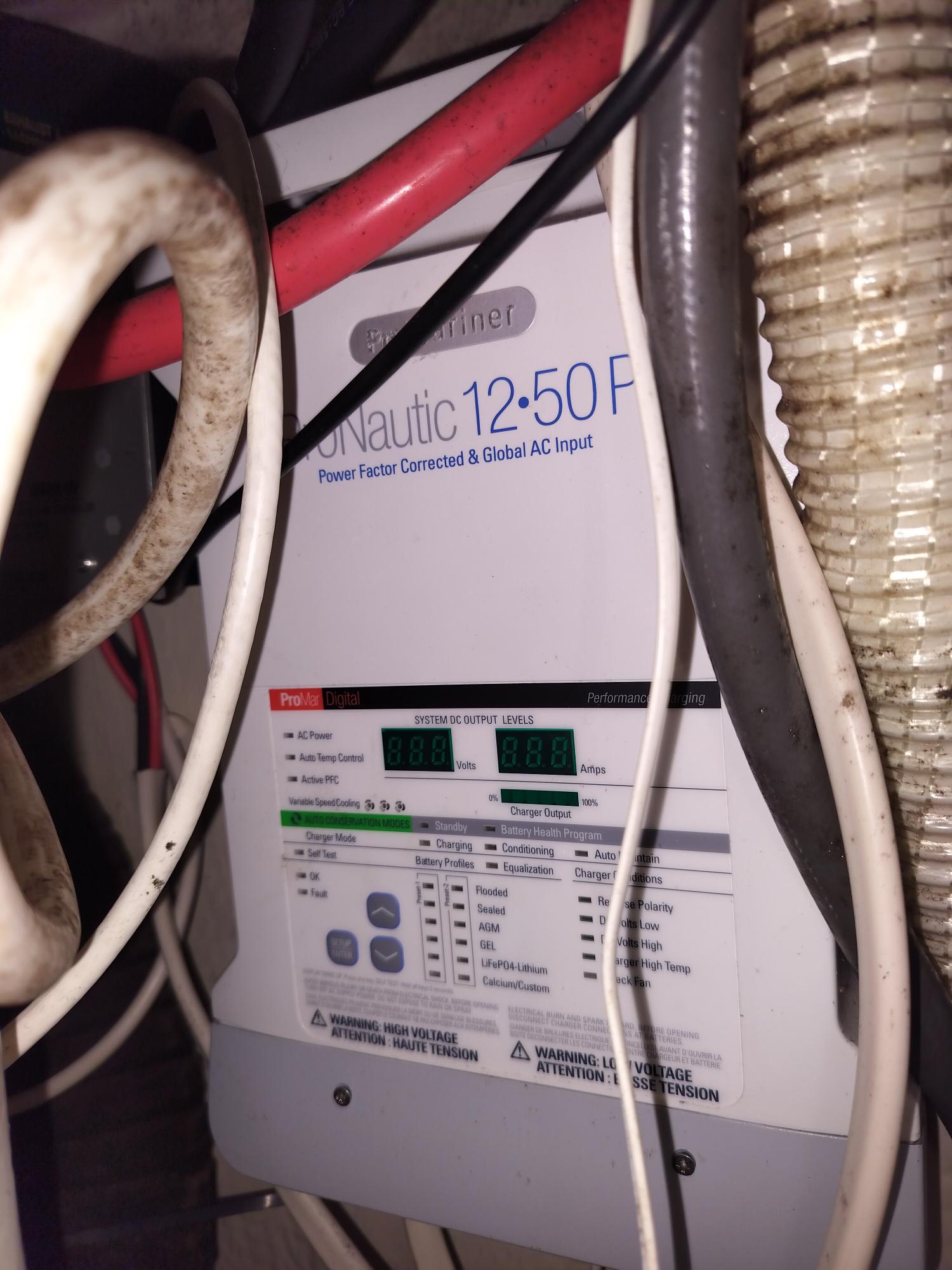

ProNautic 12-50P programmable Charger (Has a LiFeP04 charge profiles)

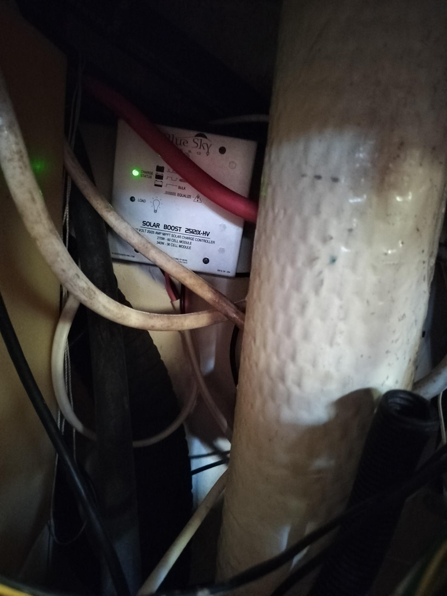

BlueSky Solar Controller with 100W panel (for keeping FLA house batteries charged - the Lithium will replace these batteries

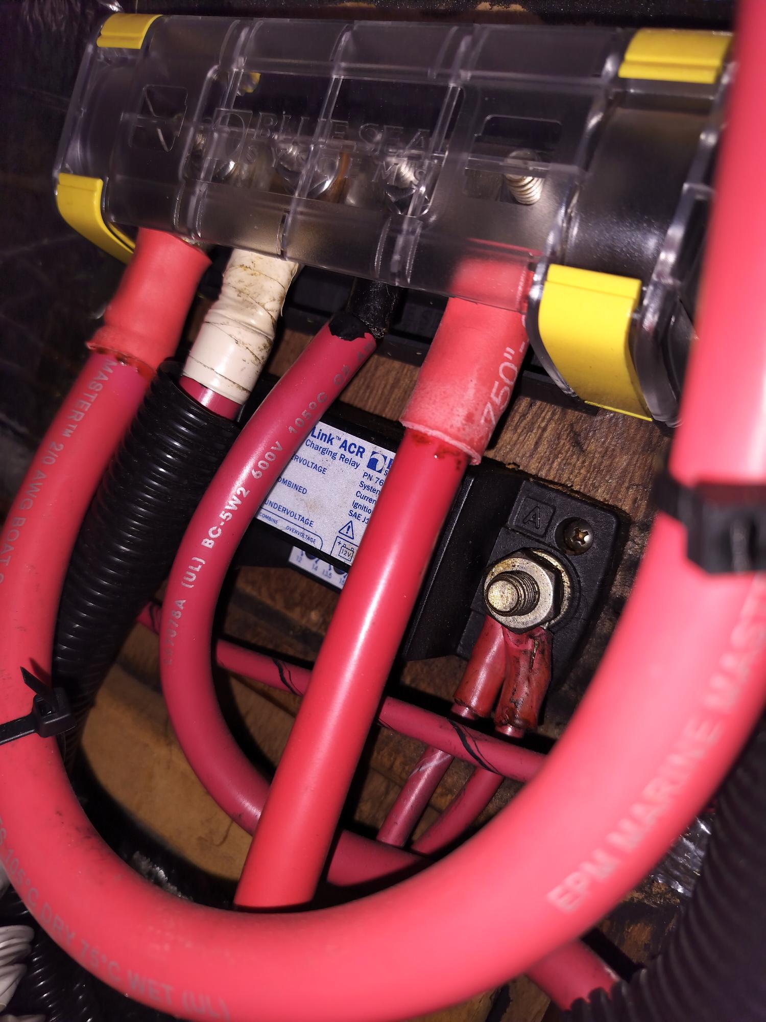

BlueSky ACR
An AC (plug in) 12 Lithium Battery Charger supplied with the WattCycle Battery.
Thoughts on what I have, what I don't have, and the best way to hook it up are appreciated.

ProNautic 12-50P programmable Charger (I believe it can run two different charge profiles)
No, it has multiple options and charging can be customized, but it can only deliver one charging protocol at a time. It can be connected to 3 batteries with each battery having the same charging profile and the total output (50a) is divided between the batteries.

Yes you will need a DC-DC charger if you want all charging sources, solar, alternator, and charger to simultaneously charge the house and start/reserve battery.
BlueSky ACR
In general ACRs do not work well with mixed chemistry systems as the LA and LFP batteries likely have different charging protocols. The DC-DC charger would replace the ACR.
No need for this as the Pronautic 1250 can charge the LFP battery.

Looking at the ProNautic charge profile for LiFeP04 it shows.
LiFeP04 Profile 1 14.8V Charging 14.4 Float
Profile 2 14.6V Charging 14.4 Float
Based on discussi on in the other recent thread, it seems that a custom of something lower might be better for long term health. Seems I remember Rod saying something about a lower voltage and his pack is many years old and somebody else suggested 13.8V? I can't seem to find the discussion though. Any help in refreshing my memory on that discussion. The ProNautic allows a "custom profile" so I can set that up if I need to.
Thanks in advance
Feb 6, 1998
11,763
Thanks in advance
DO NOT use the preset! ProMariner has zero clue how to charge LFP. Create a custom profile of 14.2V absorption & 13.5V float and you're golden.
Likes: mermike
Oct 26, 2010
2,223
Hunter 40.5 Beaufort, SC
Thanks Rod. 14.2 Absorption and 13.5 Float it is.

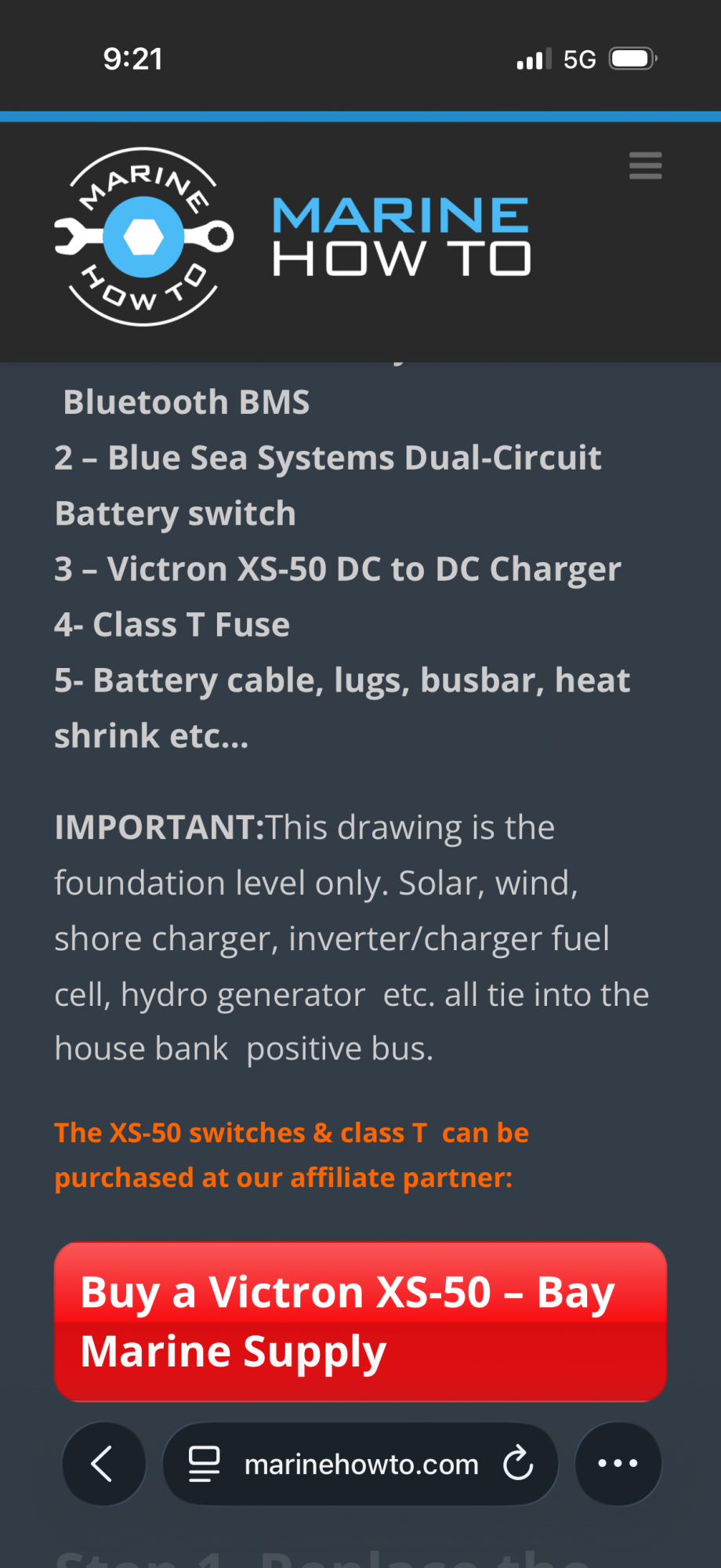

Your three switch setup is fine, no need to replace. If you want to charge via the alt a Victron XS-50 set to 40A will be The best bet..

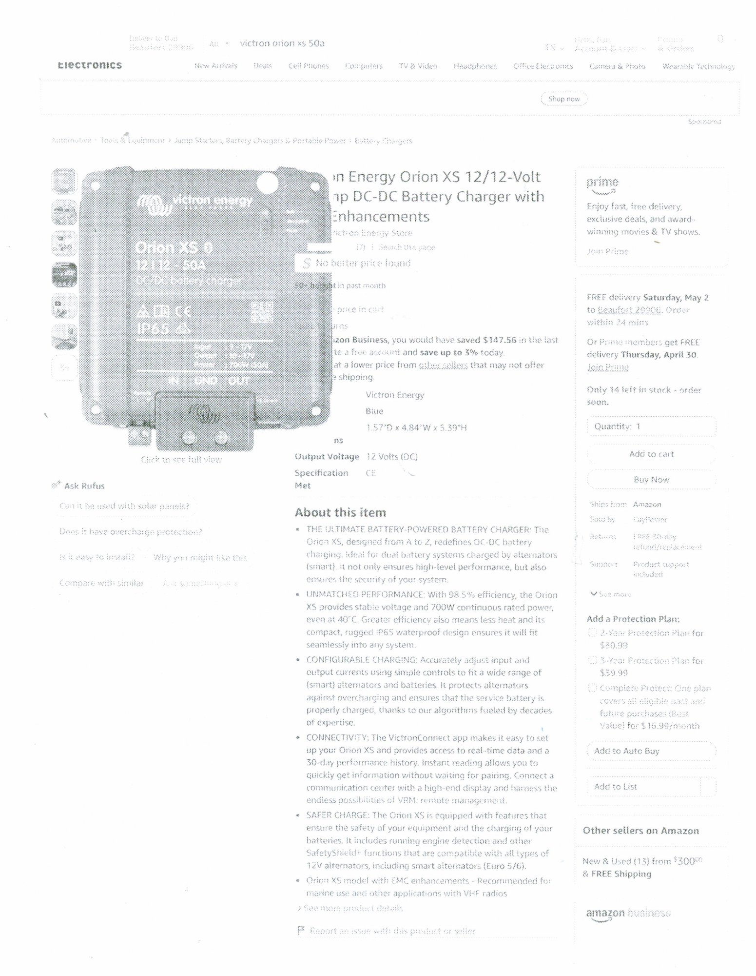

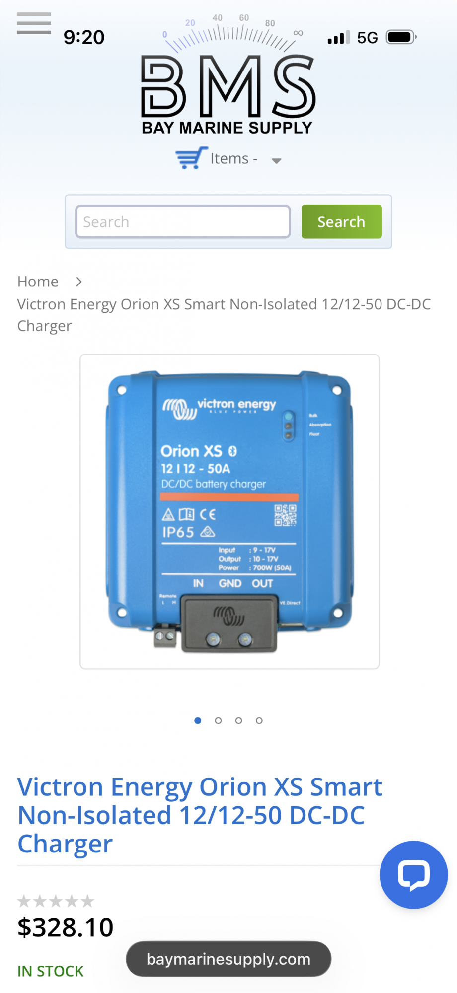

@Maine Sail Is this the animal I am looking for? It says it is for "smart" alternators. Can I use it with my oem Hitachi dumb alternator?
24,684
Here is the one I purchased. Guidance came from @Maine Sail ’s website.
