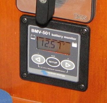

Tim has the Victron. FWIW Xantrex dropped the supplier of the old style Link monitors (Link 10/20 Link 1000/2000. They are now using a company out of the Netherlands who made the very reliable Xantrex XBM and the Victron 501 (same units differnt name branding). Xantrex has never actually made a battery monitor, that I am aware of, just signed exclusive US rights contracts with vendors to supply them such as TBS Electronics.
Victron parted ways with this company, perhaps when Xantrex signed on with them for the full line of products and either now build their own or found another source. The new Link Pro and Link Lite are good units as are the Victron units like the BMV-601. The Victron is MUCH less expensive than the Link Lite or Link Pro however and simple plug & play..
I have had a Xantrex XBM now for about 5 years and had zero glitches or issues with it. Can't say the same for my old Link 10...

Feb 6, 1998
11,772
I have installed the Victron BMV on several boats including our own. It is a very easy install and a great piece of equipment. All of the Xantrex units are very problematic. Chuck
Chuck,
I would tend to disagree that "ALL" Xantrex units are problematic. I would agree about the previous Link series though.
Prior to the Victron BMV 601/602's the Victron battery monitors were made by TBS electronics and were identical to the Xantrex XBM. The same company made them for Xantrex & Victron..
Victron BMV-501
Xantrex XBM
Xantrex's tech support has suffered recently but the new LINK PRO and LINK LITE are made by the same company that made the Victron units until just recently. I have found the XBM/Victron 501 to be a very, very reliable unit and would expect the Link Lite & Pro to be simila,r except for the poor Xantrex tech support. They should have dropped the "LINK" moniker and gone with XBM as it was a considerably more reliable unit...
As I said above though the Victron 601/602 is a FAR better value!
