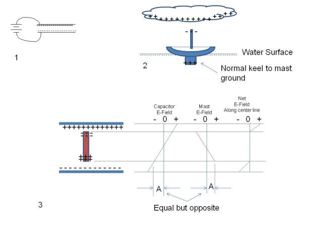

In less than a thousand words
Fig 1 is just a capacitor
Fig 2 is MS boat in salt water with a keel to mast ground and a cloud above it
Fig 3 is a mast isolated between the two plates of a capacitor. Off to the left side are three plots of the E-field a) of the cap, b) of the mast along the centerline due to the charges on it, and c) the net field along the centerline of the mast
As the capacitor charges in Fig 3 the mast will develop induced charges (just like the water surface under a charged cloud BTW). These develop to the extent that they cancel out the E-field. If there was an E-field inside the mast it would cause the charges to move till there was not one. Discharge the capacitor (not through the mast) and the charge concentration on the mast redistributes itself so there is (again) no E-field. You are not actually moving electrons into or out of the mast just rearranging them. The magnitude of the voltage across the mast (vertically) is just the magnitude of the induced E-field gradient times the height of the mast.
My hypothesis was that MS’s boat got inductively charged up to a few hundred or thousand volts. Not enough to cause a strike but enough to have a pretty good potential across the masthead-keel. The strike equalizes all the cloud and water surface charges, the induced E-field goes away very rapidly and MS is left with a charged up boat. This is electrically the same as a charged up capacitor. Now I’m not trying to say that it is a good capacitor but there is some charge there. Apparently more than enough (hundreds or thousands of volts) to zap his equipment as every wire that has some connection to ground discharges into the keel.
Thoughts?

Bill, that at least answers one question. You're NOT saying that the boat is acting as a capacitor being charged. You're saying that the atmosphere is the capacitor being charged and the boat is "in the dielectric", as it were. What's the potential of the mast? That's the one question I have not answered for myself as yet. Being a conductor it should be the same potential everywhere (but which). In instances where you observe charge separation, the medium between the separated charge is generally something that conducts very poorly. For the atmosphere, that's air, right up until breakdown voltage. For the mast? There is no such region in the mast, so you need to explain how what you are describing is possible. In every theory I know (that is, remember), it's not possible.
Jun 6, 2006
6,990
In the diaelectric
Yes, that is one interpretation of it. The boat is "in the dielectric". Now take the boat and look at it in isolation. We don't care how it got polarized just that it is. So lots of electrons at the top and not so many at the keel. SURE does look like a capacitor to me. If I turn off the external field it will discharge JUST like a capacitor.
The voltage at the top of the mast is just the external E-field gradient times the mast height. Let’s not get into "free space potential" again as that is everywhere all the time and just acts like an overpressure on everything. Kinda like air pressure. My gage says 0 but we know it is really 14.7 psi compared to a vacuum. To determine an actual value for that voltage we can make some assumptions. The E-field is the change in voltage/distance between the two measurements.
