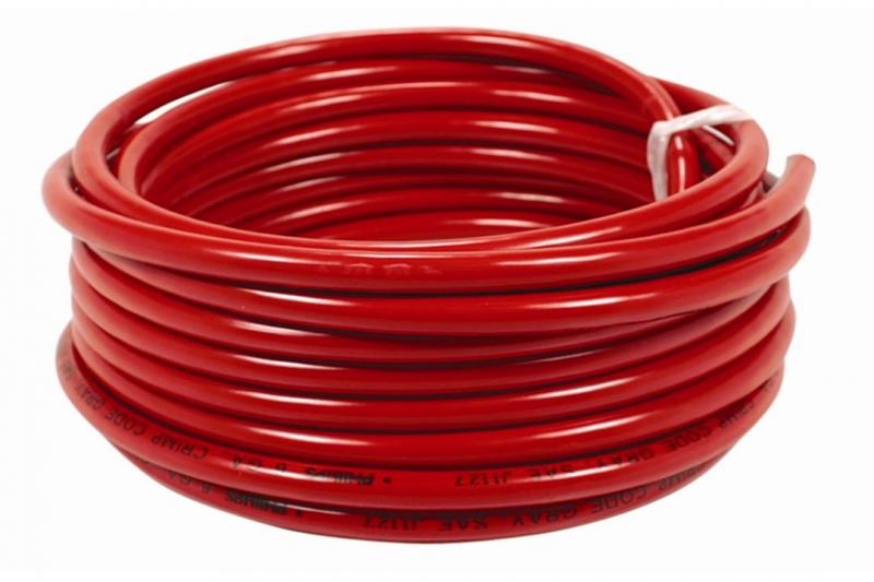

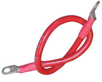

These are battery terminal connectors and wire... probably autozone etc would have them.
Of course you should probably use black wire to follow convention for ground.
