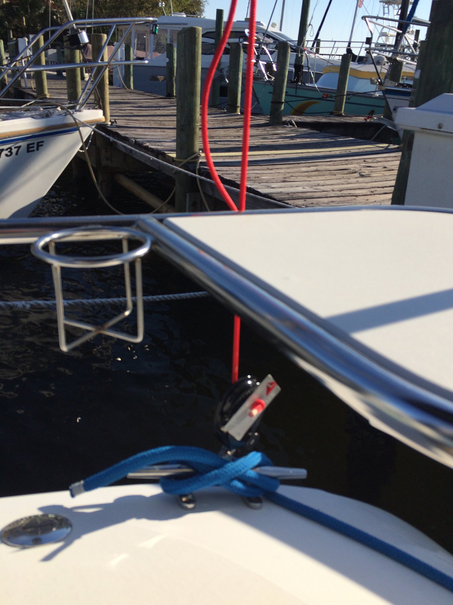

I attach snatch blocks to the stern cleats for my asymmetric. The red shock cord keeps the block from hitting the deck.picture I

Thanks @KZW I think that is the setup I'll start with.

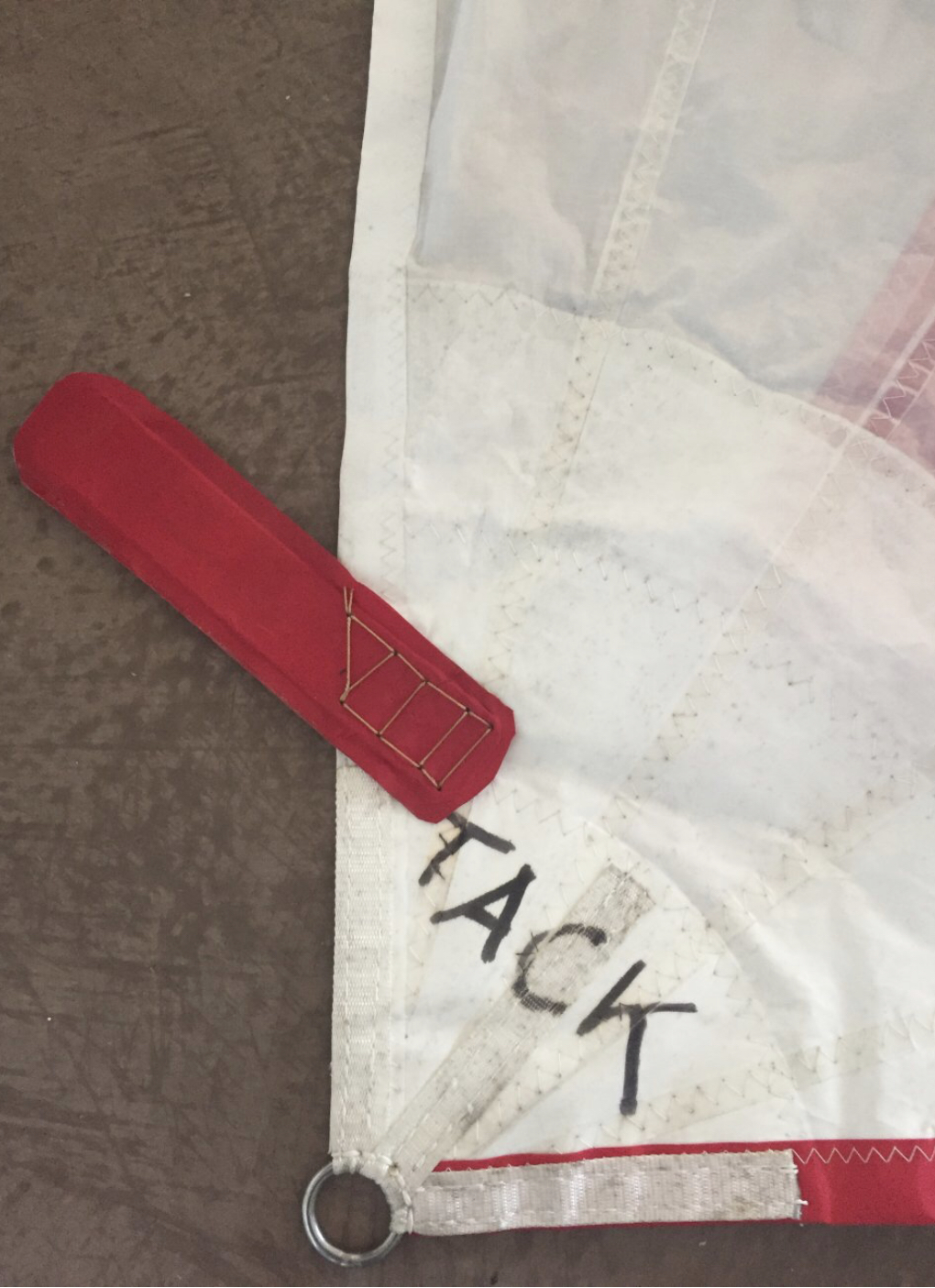

I've not yet trapped the lazy sheet under the boat, but I'm sure it will happen one day - at a most inopportune time.
@Jackdaw gave me two tips that really reduce the chance of this happening.
One is to sew a gybulator onto the tack of the sail. Just a piece of semi stiff material to catch the lazy sheet.
Two was to use a short wand at the bow, for the same reason.

I'll check with Precision about adding it.

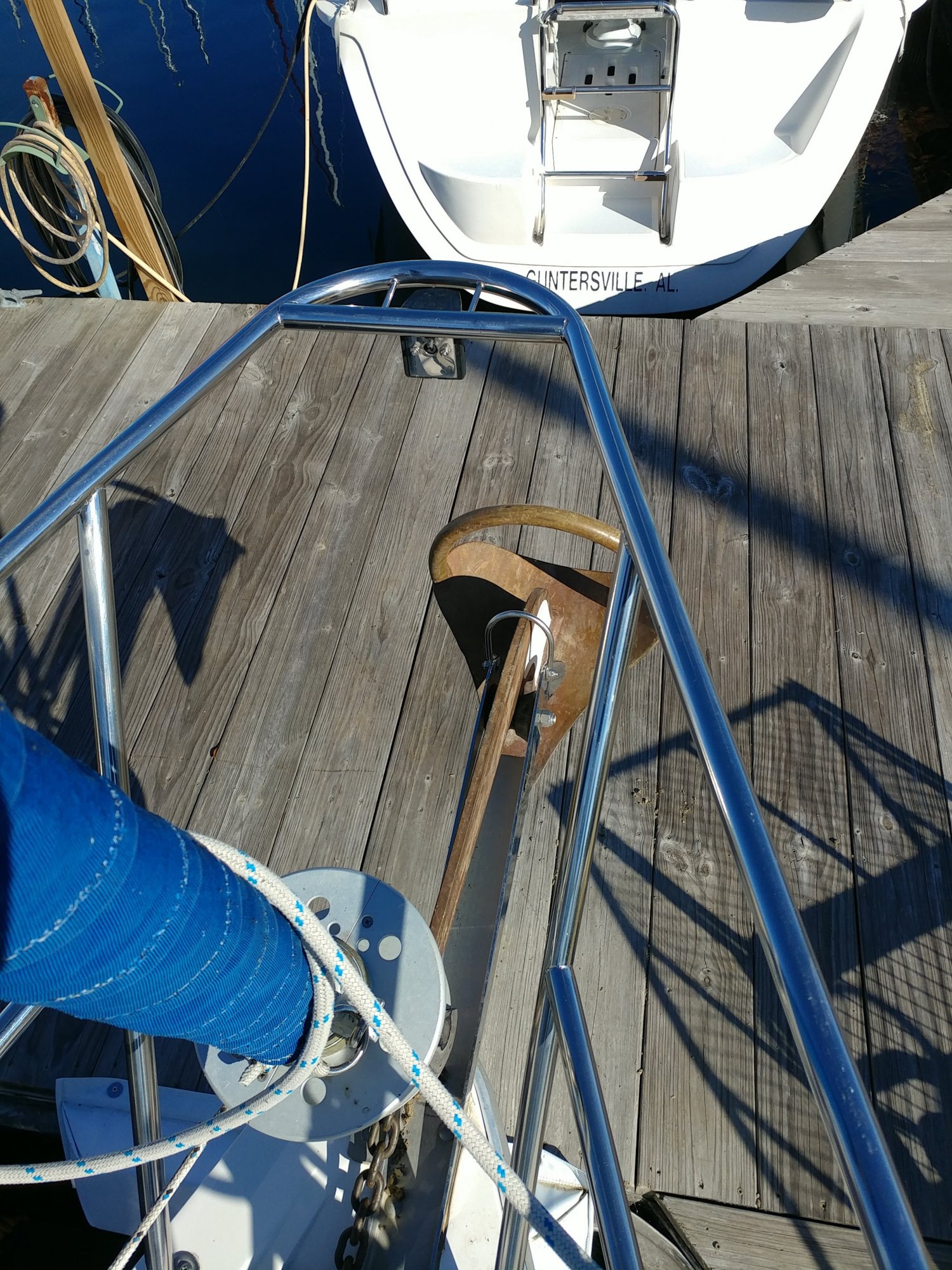

I haven't re-rigged the second jib halyard, so we are flying inside the forestay for now but...
@rukidn how is the tack attached inside? I have the sheets and turning blocks figured out but originally I was planning to attach to the bail on the anchor roller. @KZW I saw this was your approach, was any other changes needed to tie the anchor roller down? Anyone try a soft shackle for the tack?

I tied the tack line to a pin shackle on the spinnaker tack cringle, and attach a snap shackle-single block on the anchor bail. The tack line runs through the block then to the sail. The line goes back to the cockpit. It makes the tack easy to adjust. The two other C-310s at the marina do the same. Never been an issue. Makes it easy to attach and take off.
I will take a better picture next time I rig it and post it here. Given the weather, it will be some number of days.
