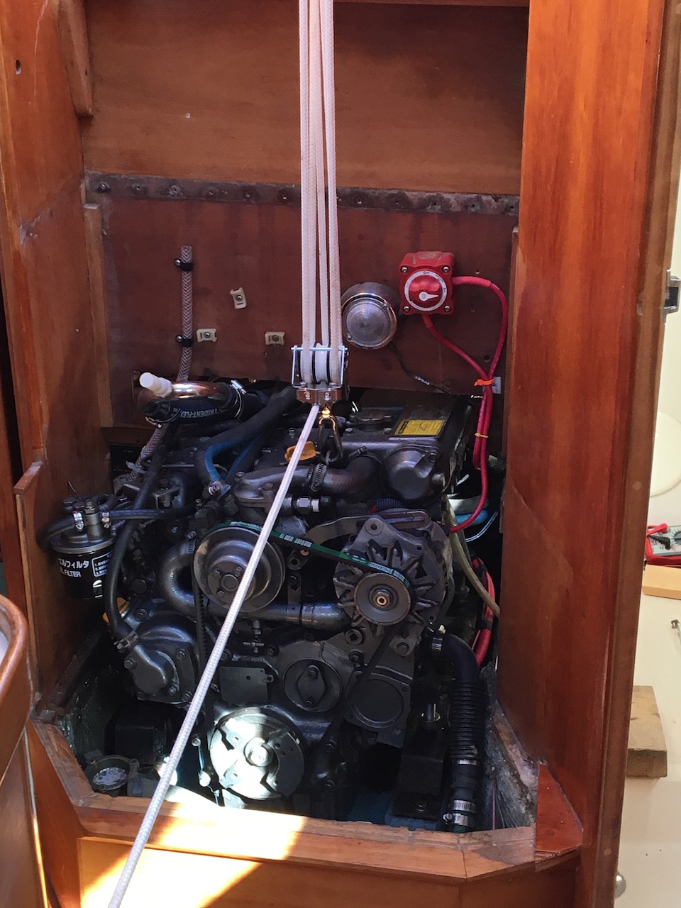

I lifted my 2gm with transmission using the eyes.. The eyes position balance the engine nicely from side to side. By adjusting the attachment to the strap that connects the eyes, you should be able to balance the engine. We first tried nylon straps around the bottom of the engine that didn't work well..
