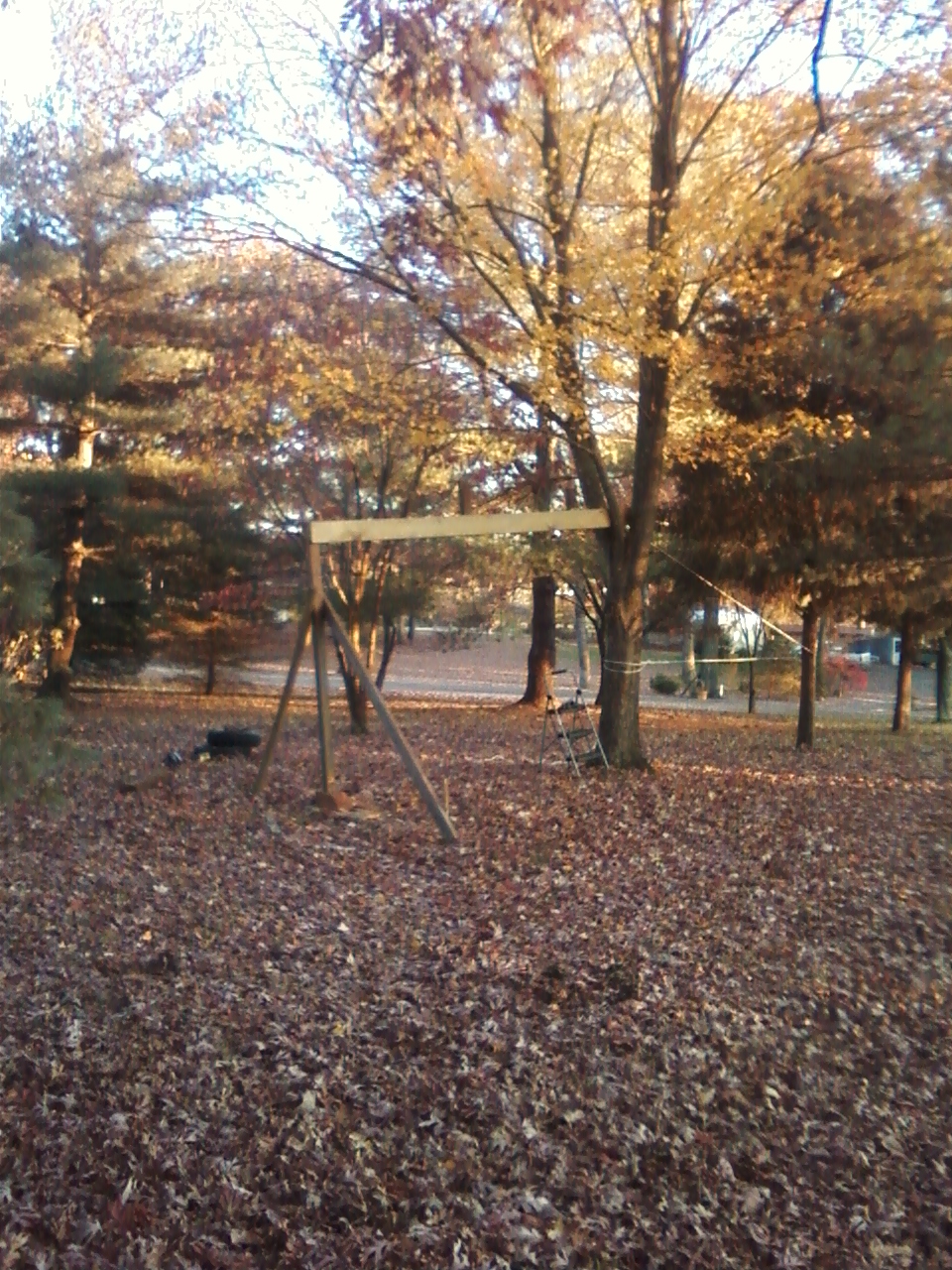

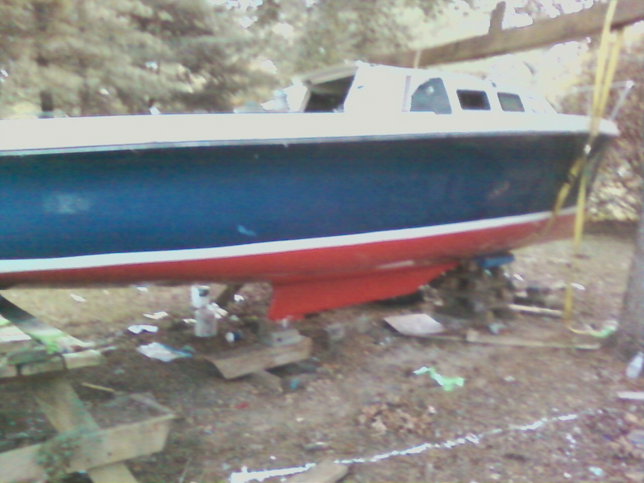

If you have a stout Oak tree nearby, park under it and use a wide tow strap and "hang" the front from a branch. On a 17' this will be no problem. I've done it on a 21' and 22' before. I've also built a frame to hang a boat once.... and I once built a cradle like set up... pictures attached.
13,982

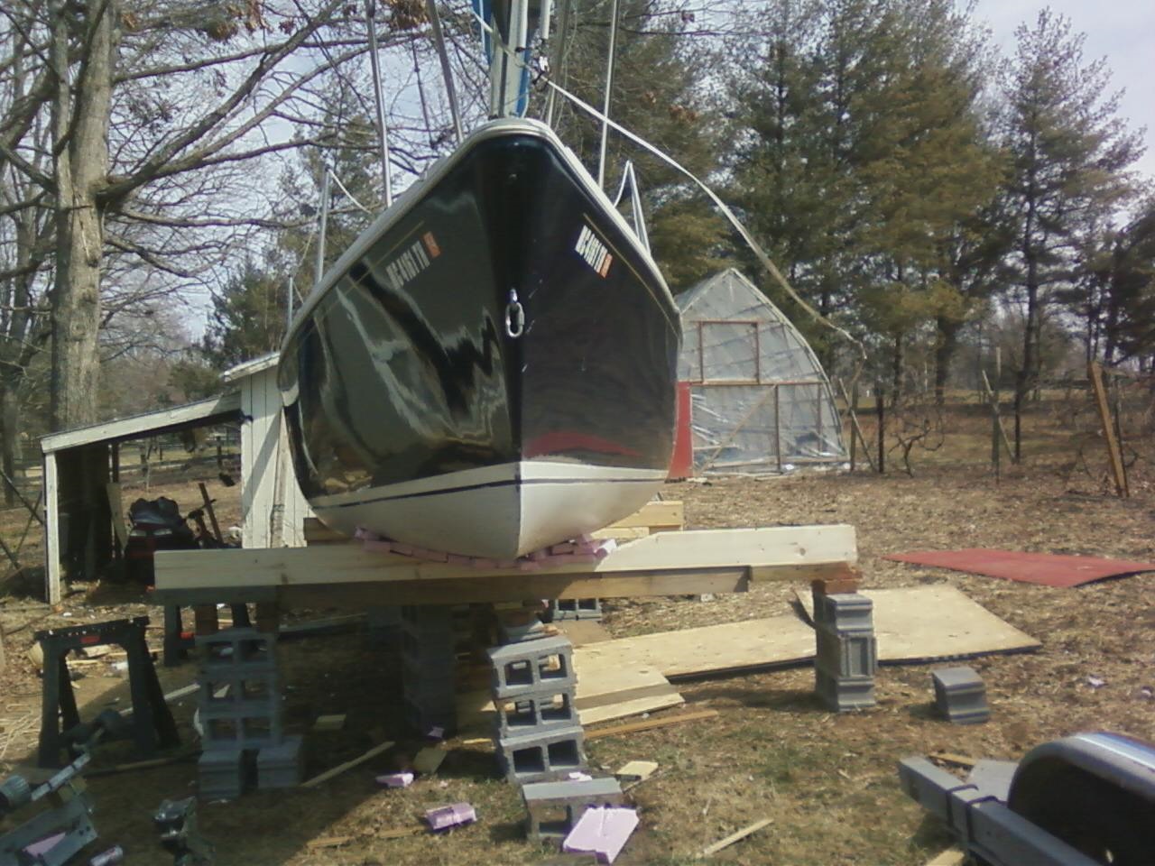

It is possible to lift the boat without using jacks.
Lower the front of the trailer, block up the stern. Raise the front of the trailer so that the stern rests on the blocks (or beam) and is as high as the trailer jack can go. Block the bow with a beam wide enough to remove the trailer. Lower the trailer tongue and remove the trailer.
Reverse the process to put it back on the trailer.

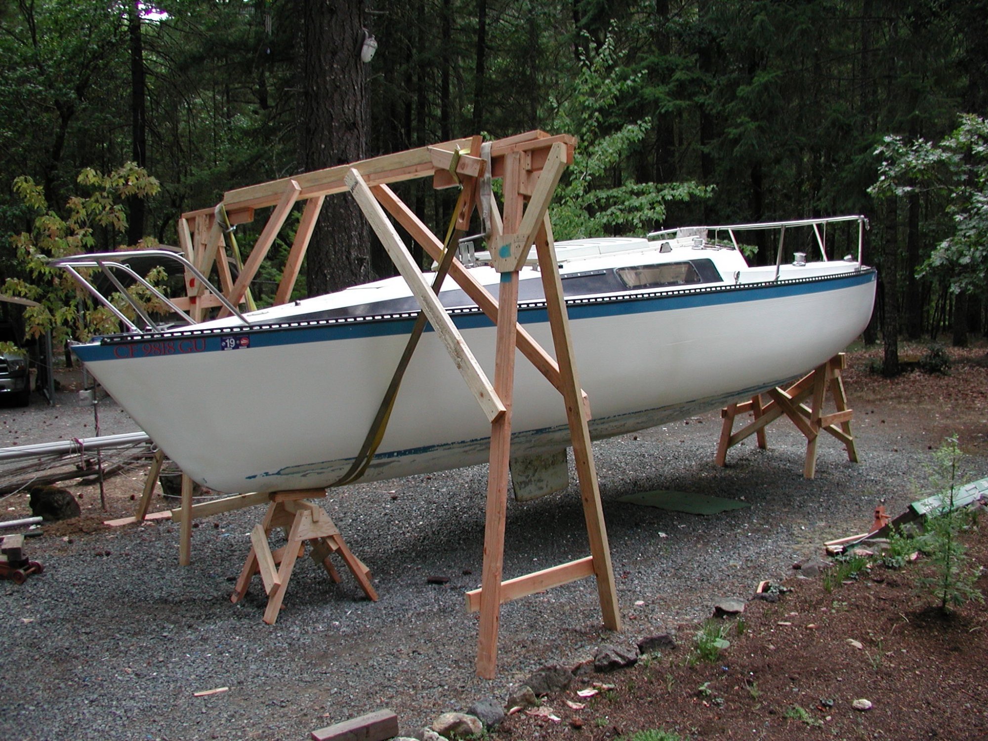

I use the method referred to by @dlochner and it works great. the beam needed for the front doesn't need to be as overbuilt as some suggest if you consider that the weight is transferred, via the straps, to the framework out near the ends of the beam. my real boat weight is about 2500 lb and I used 2/4 lumber throughout. the main beams are screwed and glued together to form a very stout assembly however.
BTW the small support under the bow isn't carrying any weight. it's just there as a safety backup. "just in case". Two HD tow straps, the additional bow support, screws instead of nails, etc. As a former pilot I believe in backup systems :).

Thanks. I''m trying to do your first procdedure. That's why I need the beam. Looked at the other options. All too expensive at this time.
