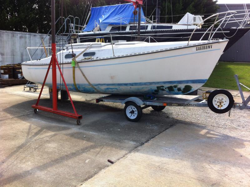

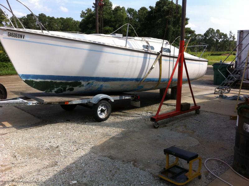

I have an oday 22 that I need to get off my trailer temporarily. I have a friend who is going to hot dip galvanize it for me for free so I can't pass this opportunity up. The trailer is in very bad need of a paint job and this seems to be the time to do this. I have an overhead gantry with a chain fall that I'm sure will take the weight but I'm concerned with the fact that it only has a single lift point. I just need to get the trailer up a few inches so I can pull the trailer out from under her. She has a fixed keel and right now all the weight is resting on some 2" X 8" boards which are attached to the trailer. I'm assuming by this that it is okay to have all the weight on the keel. My plan is to use some canvas straps and place one under the keel and another one just in front of the keel with some ratchet straps forward to keep the strap from slipping toward the stern. As I said my gantry only has a single lift point which is not ideal for this. Another thought I had was to lift an I beam with the chain fall with the I beam running fore and aft. I would attach the straps at the ends of the I beam and that would spread out the lift points a bit. I'm thinking maybe a six foot or eight foot beam. Am I overdoing this? Do you guys think that just lifting by a pair of straps from a single point would do the job? I don't want to put an undue strain on the sides since they are designed to be supported by water and I'm not sure how much strain they can take. I don't have a lot of experience with fiberglass boats. They may be constructed so strong that I could just use a single strap under the keel and just hoist the whole thing up a few inches. Am I being overly cautious here? Thanks for any advice.
