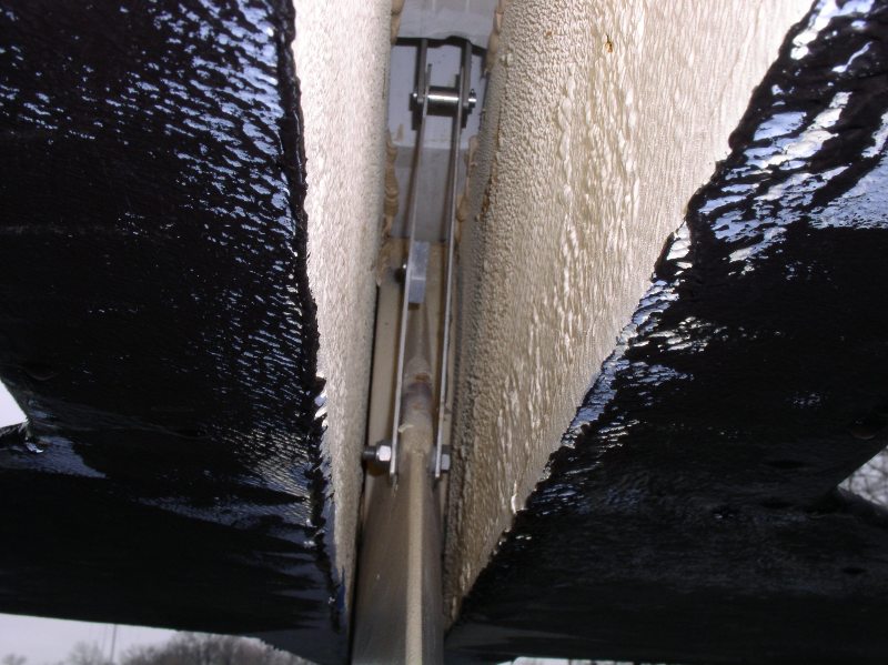

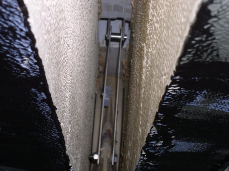

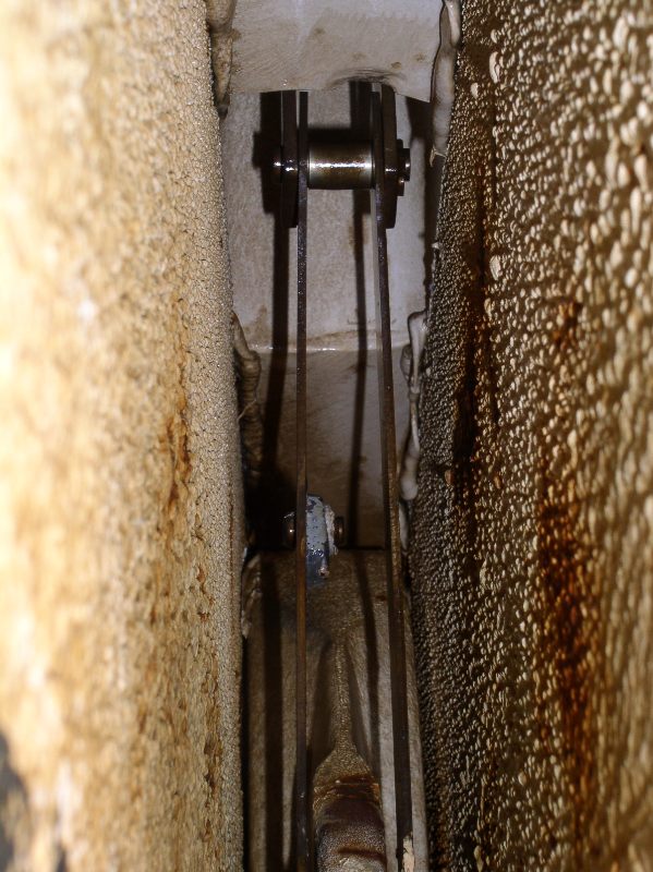

There is no cable shown in the diagrams or mentioned in the maintenance instructions. You might be able to contact and ask the fellow Michael James who wrote that article on the lifting keel maintenance here http://www.murrayyachtsales.com/lifting-keel-maintenance/I'm still looking for a good write-up on how the lifting mechanism works (eg, is a cable involved) and what happens if you go hard aground to the mechanism. At this point, it seems that it's a solid connection (ie, no cables). I read somewhere that if you go hard aground the mechanism lifts up inside boat and can be reset. Wish I could review that again Can anyone confirm or deny
