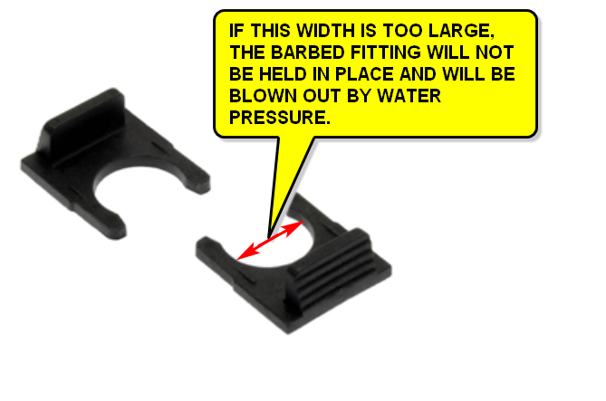

my greatest fear is that the internal diameter of the clip will be too large on the new one I receive.

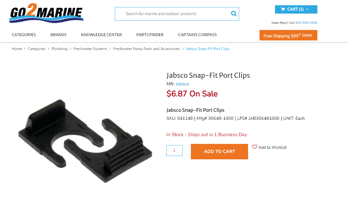

I went looking on the Jobsco Amazon page and found something interesting. On the Jobsco pumps, the clips are bright blue and captive so that they slide back and forth but cannot be removed. I then went to their accumulator, and it does not have the blue captive clips. It has loose black clips that look exactly like the Snap Port fittings that the rest of the industry uses. Were it me, I would gamble on the clips that John posted because from appearances, it looks like Jobsco does not make their own accumulator and just remarkets someone else's.

Provided a WM link that offered to sell you 2 clips for $16.99. It was a speedy search, I admit. If they are available at WM they may be available from other resources. The stated price is 5 times less than the cost of a replacement unit.
Feeling your need, I submit my second search for your bedeviled clip...

I've seen those as well. I feel 99% the same way you do. If I don't hear from Jabsco UK by mid next week (less than 1% chance of that) I will get the black slide clips. Obviously I do not frequently gamble but I will let you know if they fit.

You gave me the part number which, I had not been able to find. Couldn't come up with the correct words to describe the little %#$^@#*. So far I am down to :
Going to try it if I don't hear from Jabsco UK next week. It's a gamble but less than $100.00 plus shipping. The shipping will be more than the clips.

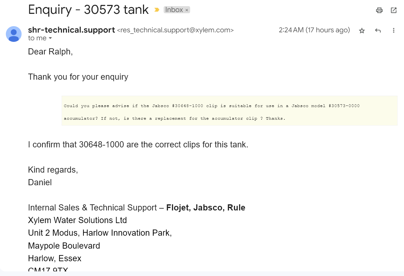

I wrote to Jabsco UK on Friday afternoon and asked them the part number of the slide clip for a Jabsco #30573-0000 accumulator. I received an answer early today :
The correct clip number is, wait for it, drum roll please, #330648-1000 :clap:, contrary to Go2Marine and Jabsco's omission in their literature.
