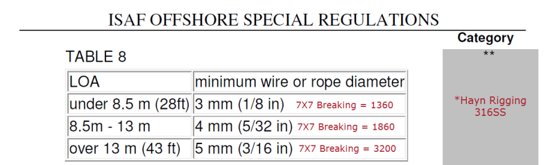

while a lifeline (and that is what this is)
The definition by ISAF is: "Lifeline - Rope or wire line rigged as guardrail / guardline around the deck."
This is neither rope nor wire line.
must withstand 4500 pounds in tension.
Having been involved in the inspection process, for an off-shore race, I dug out my 2012-2013 season ISAF Offshore Special Regulations. If I had followed the "rules" during those inspections, and was the final arbiter, none of the boats I inspected qualified yet every boat I inspected or helped inspect still raced. I was just a grunt/helper set of eyes for this but found oodles more than the ISAF sanctioned "inspector".. Scary really.
Our boat is 36' and I would never use 4mm or 5/32" lifelines but this is all that was "required" under the ISAF regulations as of 2012-2013 seasons. There are a number of 30-42' race boats around here who do use 5/32"... There is no mention in the regulations document of the braid of the wire required eg: 7X7, 7X19 or 1X19 just that 316SS is "recommended". I don't know where the 4500 pound requirement comes from unless the rules have been changed...???
If I were go by the actual rules above, an 1860 pound breaking strength actually meets the rules under the 2012-2013 document.
This is probably an OSHA standard for holding a person from falling [5000 pound tension load].
That rating needs a known span between between the hold downs, in normal sailing case, the Stanchions.
The fact that it not a wire or cable, doesn't not relieve the safety factor of using a "Safety tether" hooked to the bar or life line cable.
Why so high a number, since normally who weighs 4500 lb?
It is designed to stop a "fall" of a normal person hooked to it and sometimes 2 people depending on the fall distance.
Scenario: Heavy seas, waves over the bow, hook your tethered safety harness to the line or tubing.
Then a Big waves hits you and knocks you overboard.;)
Why does the LOA table show different specifications of load?
I suspect this set by the distance between stanchions for smaller LOA boats.
Last safety note on Life lines...
In load spreading calculation, you would assume each stanchion base hold down would need to support at least half of the load. In industrial safety world, each stanchion should hold down 4500 in worst case on a free fall [this is a dynamic load].
Since freeboard, on a normal sailing vessel, is not much a free fall to water, I would suspect your stanchion hold downs should be at least half the life line loading.
