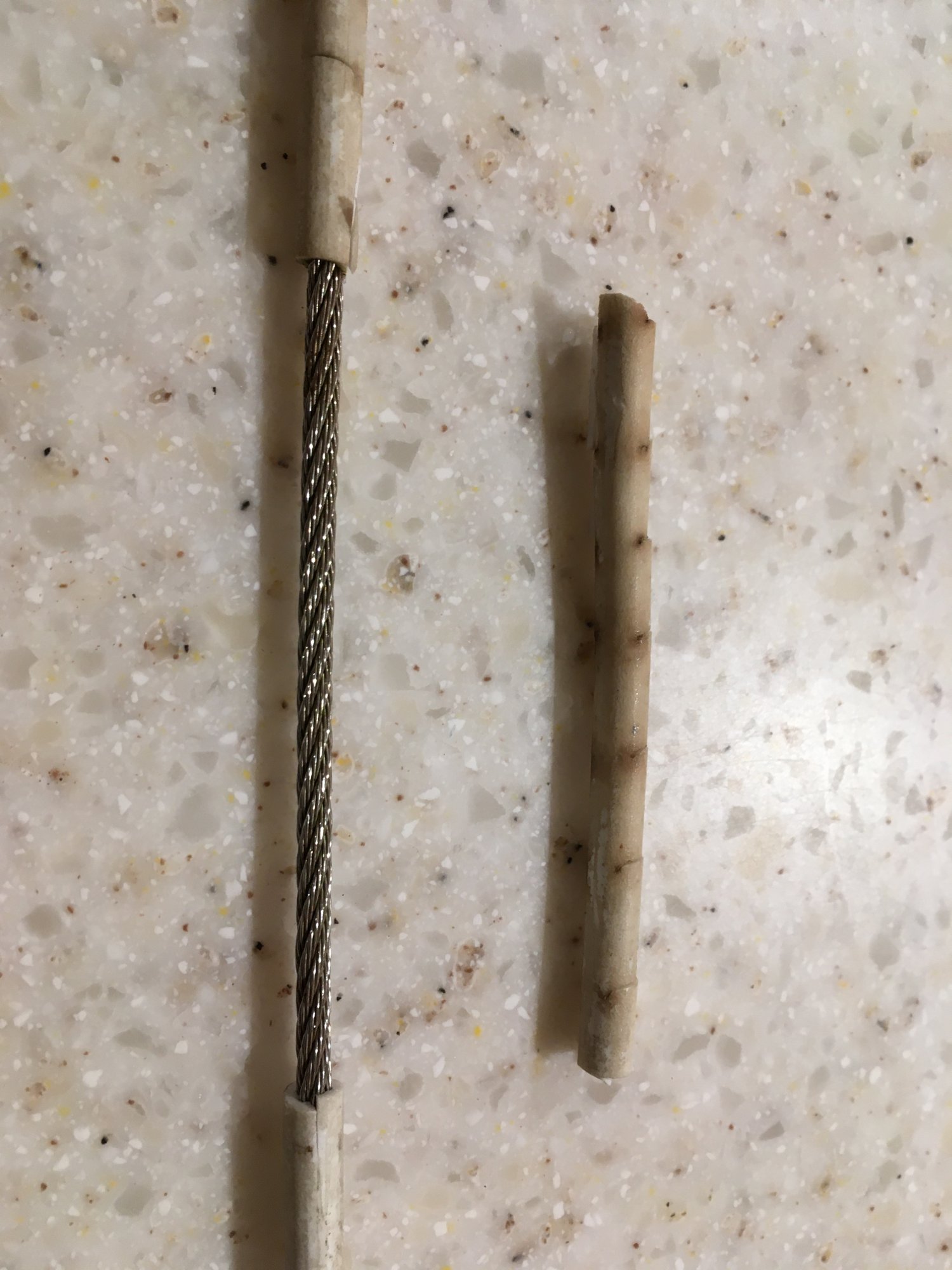

Since my lifelines were looking a bit scary, I decided to replace them with 1/4” Dyneema. If you’re interested in the process, here is the blog entry:
Dyneema lifelines

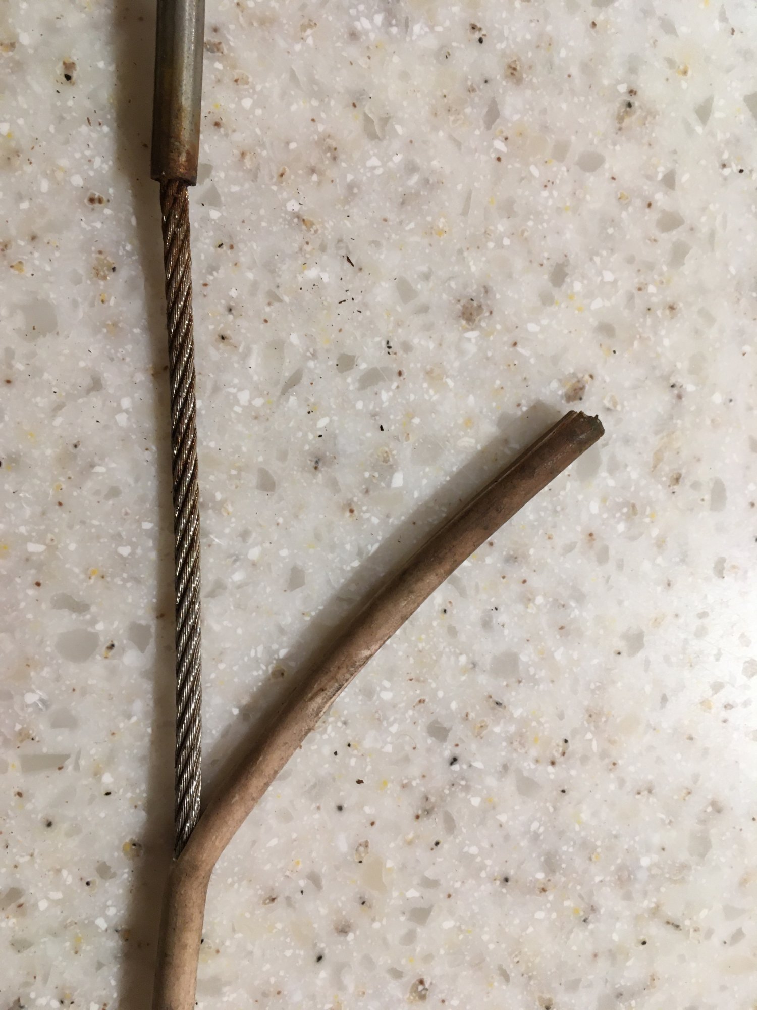

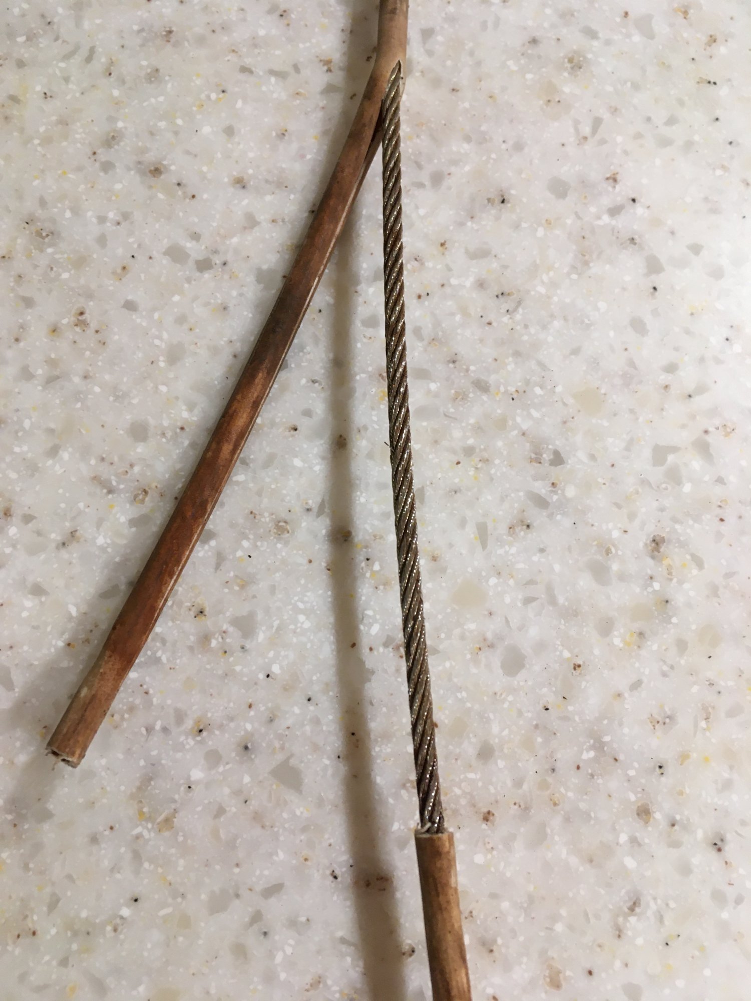

I brought the old lifelines home and actually took the time to cut away the plastic sheathing in three of the scariest looking areas to see what was underneath. Overall, it was not as bad as I had feared. Yes, there was some surface rust, but only a couple of individual strands had frayed. Perhaps this will make you feel a bit better if your lifelines looked as bad as mine did.

Actually, the worst of the corrosion is often deep inside the cable. Also, it only takes one bad spot (steel or Dyneema).
Dyneema is interesting stuff, but it still has a well-deserved reputation for chafing on even slight burrs. This is definitely an application with two sides.

The cool kids go bare. The issue with covered is you can't see what is going on with the important stuff they are non-inspectable. I didn't actually see what was wrong with the OP wires. So I guess I am not a great judge. I replace when it gets to the meathook stage.

The vinyl covers on my lifelines looked just as bad as yours and our local race rules do not allow vinyl coated lifelines so I cut the covers off to see what they looked like under the covers. Mine had a red tinge of surface rust but did not have any fish hooks. I wiped on some Wichinox, let them sit for 15 minutes and hosed them off. They came out all shiny and bright and have been perfect ever since.

Ours looked as bad as well. I cut the cover off in places and could find no issues with the wire. Because removing the cover was really difficult I chose to replace them with bare wire one size larger for comfort.

I found mine to be very easy to remove. I took them completely off the boat and secured one end to a post. I then used an old pairing knife like a draw-knife to cut one side off. I held the knife two-handed by the handle and back of the blade near the tip. I worked with the blade under the wire and pulled it along the bottom of the wire which sliced of that edge. after that, the rest just peeled off.

I did the same, but I drew the blade on the top of the lifleline while still on the boat. Held the blade as flat as it would go but still peel. Easy-Peasy.

I started out that way but the vinyl was very brittle and rather than coming off in a long curl, it popped off in little chips that all wanted to take a swim. by removing them I could confine them to the center of the concrete dock and sweep them up.
