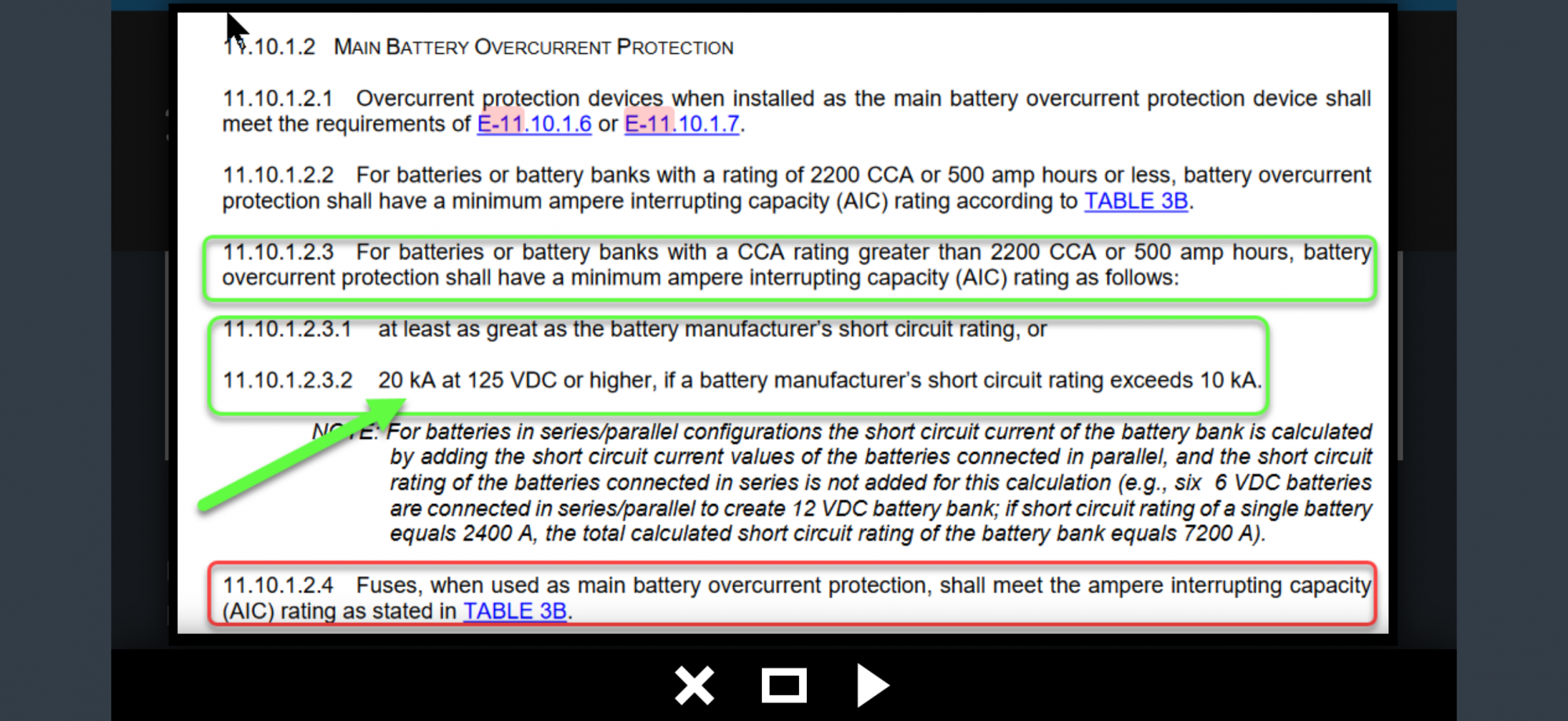

Phil. What is the short circuit rating of each of the batteries? In Parallel configuration that rating is cumulative. Your fuse will need to be able to function without welding shut.
@Maine Sail shares this detail on his site:
If you find this helpful in protecting your boat, why not buy the guy a cup of coffee.
BUY ME A COFFEE if you want to support this site.​
ABYC standard
The green arrow is pointing to a specification that can only be met by a Class T fuse!
AIC & Why It’s Critically Important!
AIC stand for Amperage Interrupt Capacity. The AIC is sometimes called “interrupt capacity”too. AIC is the short circuit amperage capacity the fuse or breaker can “interrupt safely” without welding shut, blowing up and losing “ignition protection” or jumping the gap and failing to provide protection..

Doesn't the BMS prevent overcurrent? It is rated for 100 Amps. These are only 100Ah batteries but I appreciate the low internal resistance presents a risk with LiFEPO4 but I was afraid of putting too big a fuse on the circuit as well. I want to make sure it is protected properly. I have the product manual on my boat I'll have a look when we are down this afternoon for short circuit rating. Thanks for the info

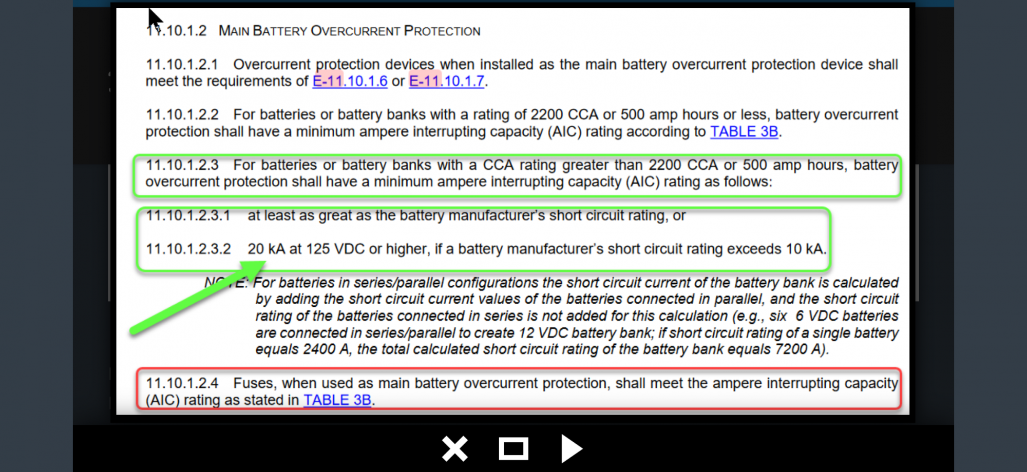

ABYC standard
I got ChatGPT to run the numbers and this is what I got. Let me know what you think:
From our earlier PSCC estimate for your two 100 Ah LiFePO₄ cells in parallel (ESR assumptions 3–10 mΩ per cell) we got a prospective short-circuit current on the order of ~2.6 kA → 8.7 kA. The Blue Sea 10,000 A @ 14 V DC rating therefore exceeds that upper estimate, giving a margin of safety

That’s almost all. When dealing with Lithium Ampere Interrupt Capacity (AIC) matters too. AIC is the maximum amount of current that a fuse can cutoff before the fuse itself welds shut and keeps letting current through. Lithium batteries can put out more amps than traditional lead, so it needs higher AIC rated fuses.
Generally MRBF AIC’s are borderline for lithium and Class T is the preferred solution. I’ve read that there’s an updated ABYC standard for exactly when a Class T is needed but I haven’t seen the new standard for myself so I don’t want to misquote it. I will say this seems like the kind of nuance I wouldn’t blindly trust ChatGPT with, especially since the standards are likely newer than its training set.
I appreciate the fuse is required for overcurrent protection but I wanted to not oversize the fuses to the point the cables or connections could be exposed to a fault current the fuse wouldn't clear and I was not relying on the BMS alone as the only overcurrent protection for wiring — fuses are there to protect conductors and equipment.
I tried to size the fuse to correspond to my cable runs and the battery. According to Blue Seas claim they meet the ABYC requirement. I only used ChatGPT to run the numbers but when I asked it to verify my setup against the revised standard, the fault that came back was that my specific battery model was CE but not UL listed. I don't trust ChatGPT either but it can be useful if you query it for information that it can acquire.
Upon more reading of the new ABYC standard based on ABYC publishes updated battery and electrical standards your AIC sounds reasonable to me. Panbo quotes the standard as requiring 5KA AIC for each 100AH of lithium. If your batteries are connected to a positive bus then you have two 100AH batteries and they’re each protected by a 10KA AIC fuse at the terminals, so you should be fine. If your batteries are daisy chained then the “second” battery terminal has a 10 KA AIC fuse and 200 AH of lithium behind it, which is still fine.
