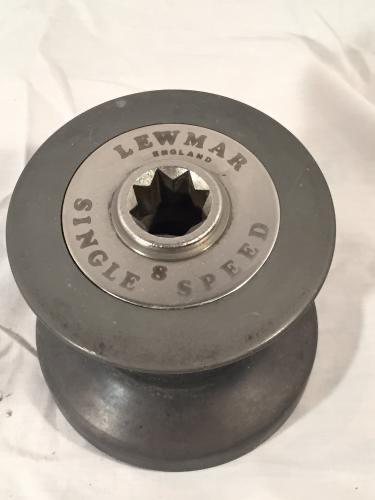

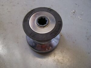

For your boat size and being these are for the jib/Genoa I will venture a SWAG.
If a previous owner (like many of us do when new technology comes out and solves our identified problems) did an upgrade then possibly in the 24/30/40 group.
On the other hand, if the previous owners preserved the boats 1977 OEM build, then the 8/10 for single speed and the 16/25/40 for two speed winches are likely. They both were introduced in 1972 to 1976 period.
Here is a site that will help with the older winch designs.
