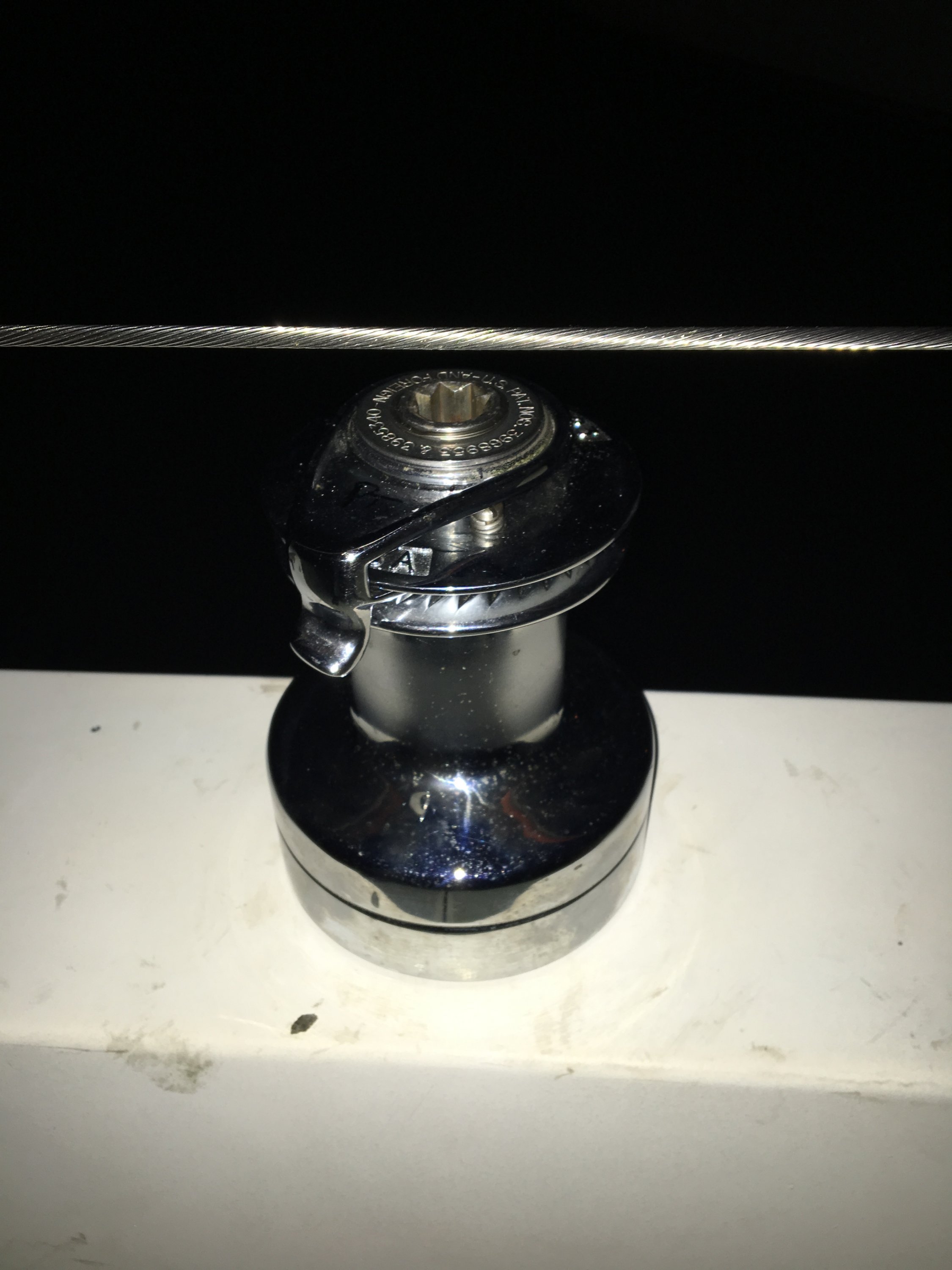

I don't see any dogs on the top of the winch.
It's not like any of the newer evo styles lewmar makes today.
The stripper arm and entire top of the winch one cast piece, the drum rotates around the top section.
I have tapped on the stripper arm before and it will not move.
I am thinking that this is machine pressed on and is not serviceable.
Well, that would be about the worst design decision ever made. You could call Lewmar customer service... you may get lucky.
