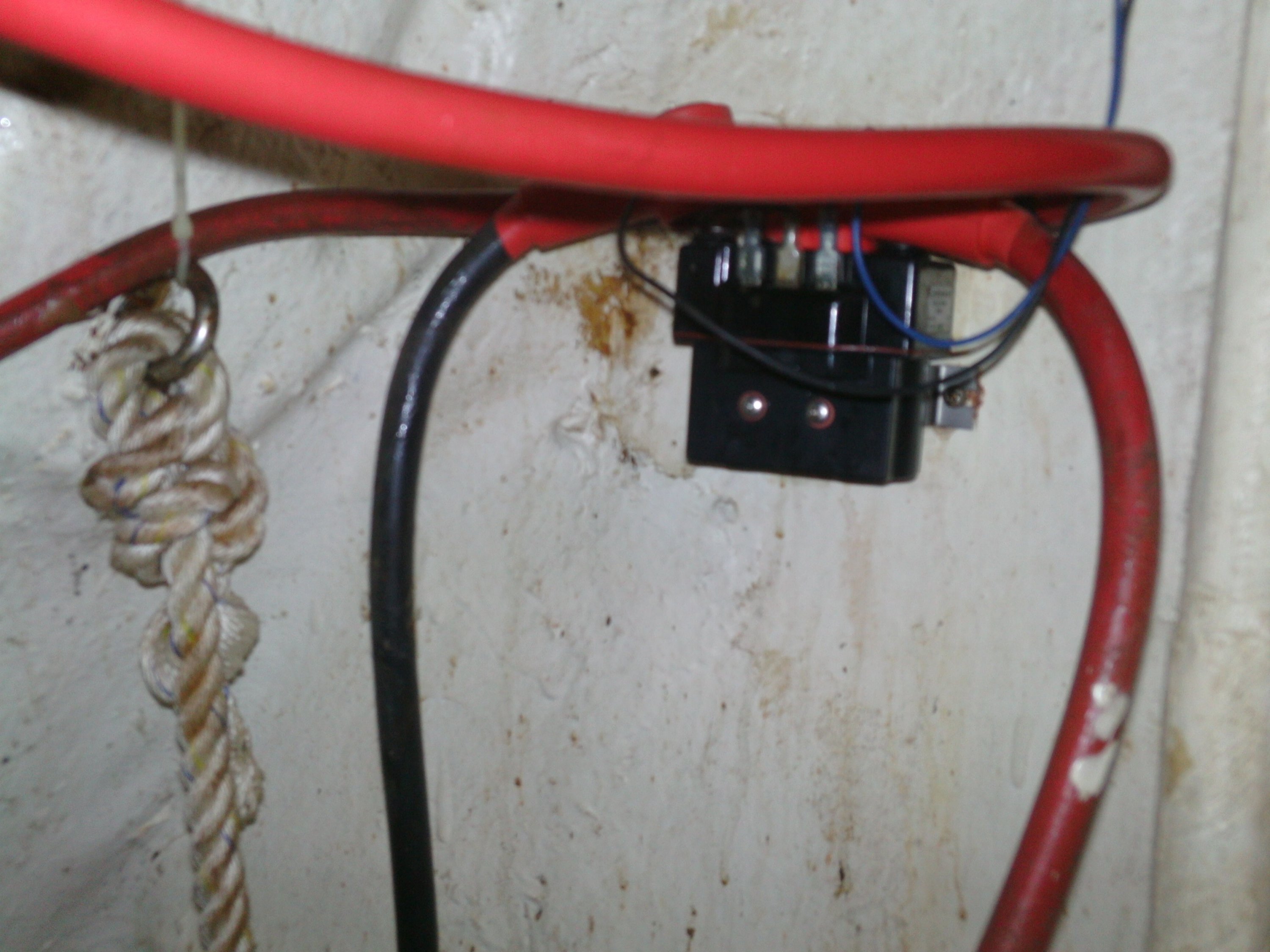

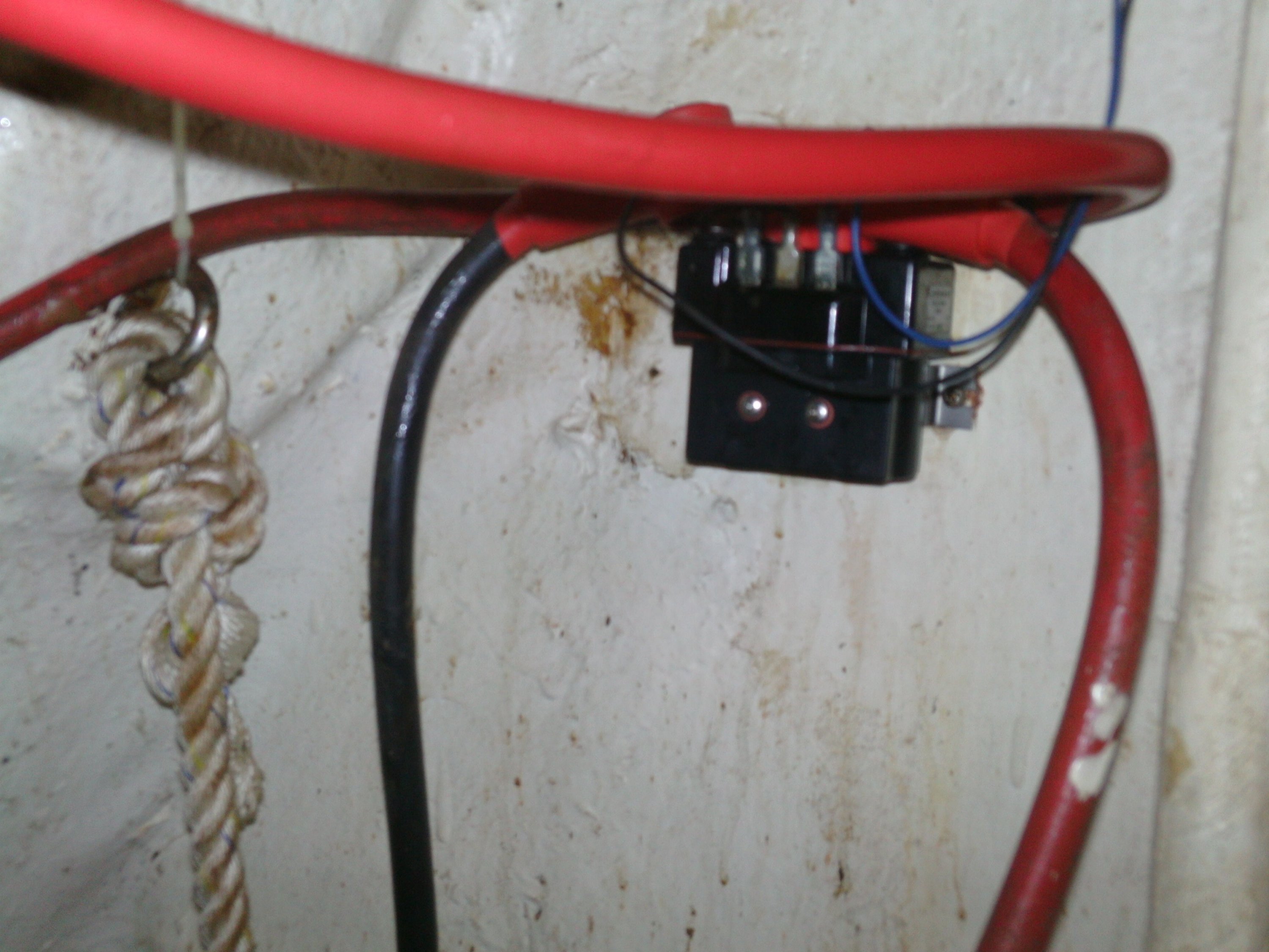

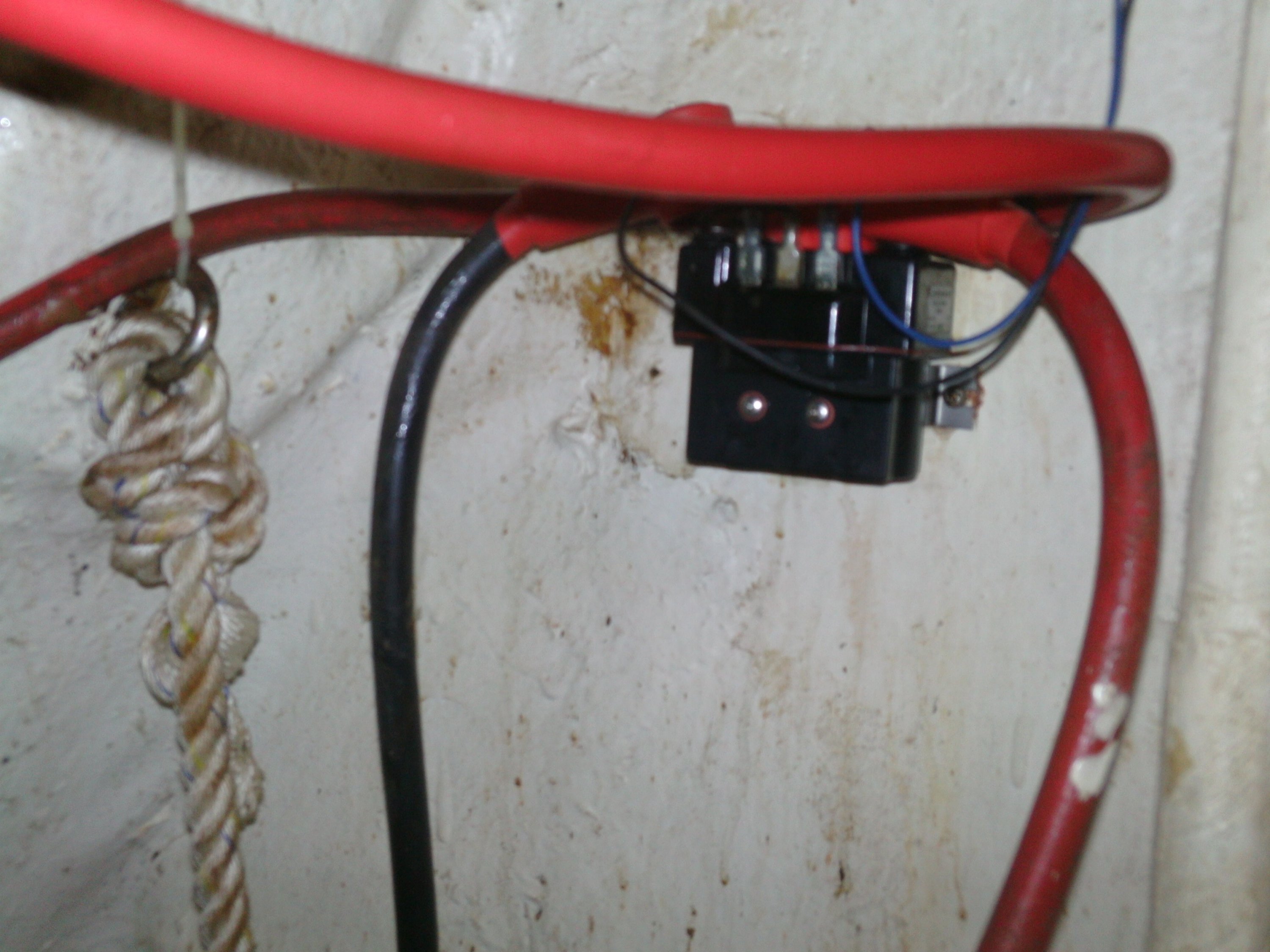

This a picture of my Windlass contactor and 2/0 wire.
You might save wiring by putting a separate battery near the windlass. It is wired to my engine starter battery for high amp pulls.
