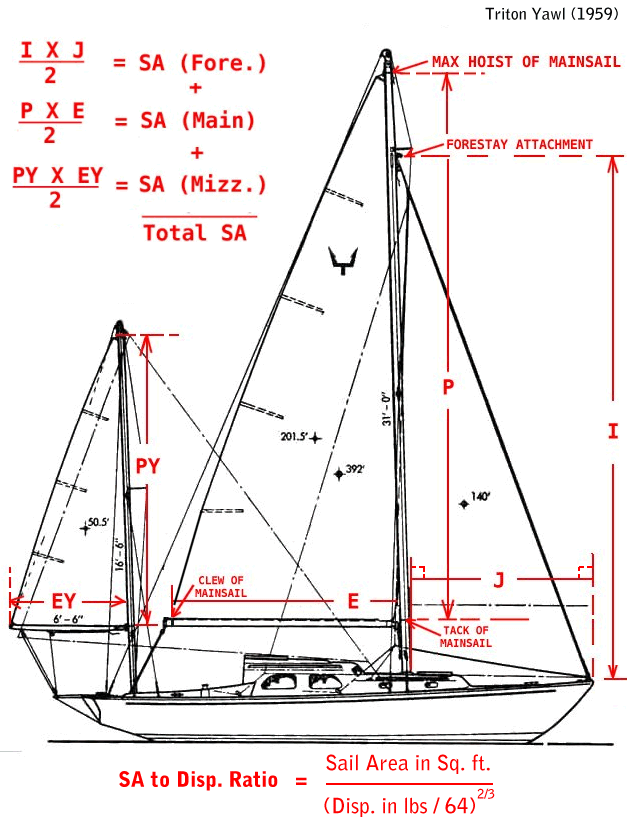

Your boat’s rig dimensions are determined by the mast height. They can be generally derived from the
I, J, P lengths for the boat.
A rigger will use these numbers to get an approximate number to rough cut your shrouds. Then they will measure twice your actual rig length before the Final Cut. It is a cut to match length why a rigger prefers to do this work with the mast in the yard laying on a stand of sawhorses.
Thanks for the info... unfortunately, as far as I can tell, (and if this sounds grumpy, forgive me, please. I'm not even halfway through my 1st cup of coffee) that only gets me the lengths of the forestay and backstay (if it's not split, which mine is) ... but not the shrouds.
