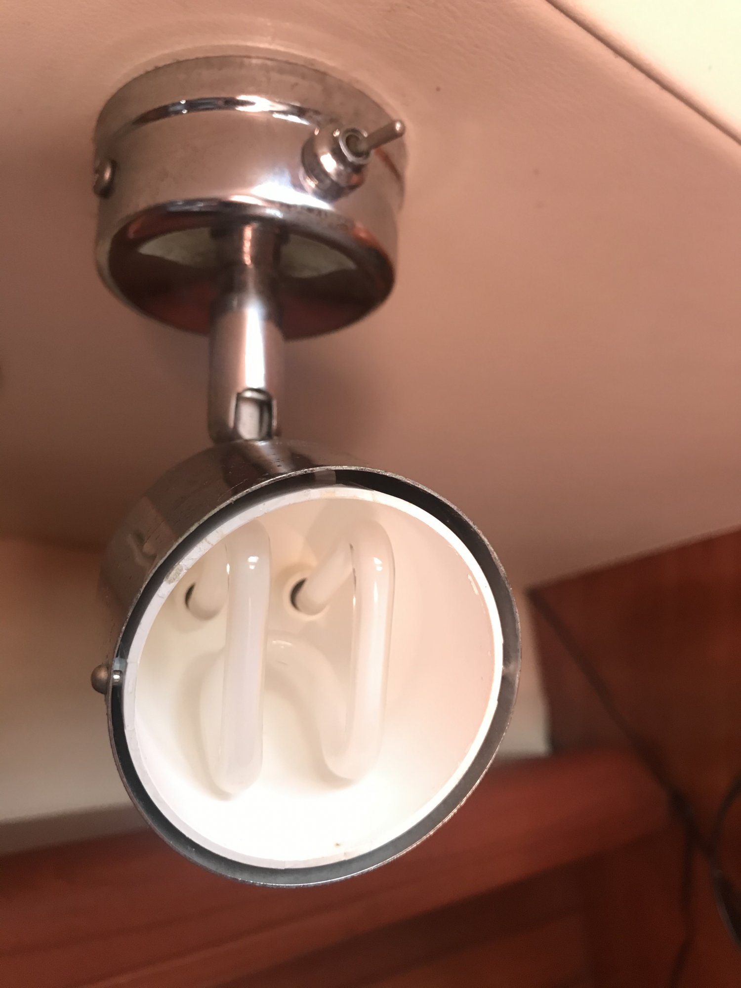

On these lights is there an led replacement?
Or I’m guessing they are fairly low power any idea of a part# for replacement as is?

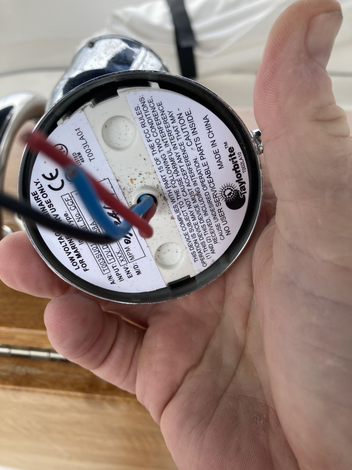

Hi Scotty. That is one odd fixture bulb. Never seen an LED replacement. Can you remove the bulb and if so does it have a number stamped somewhere on it? Depending upon the type of bulb plug/socket might determine whether such an LED replacement exits. It would help if you could post a picture of the bulb plug end or fixture socket.

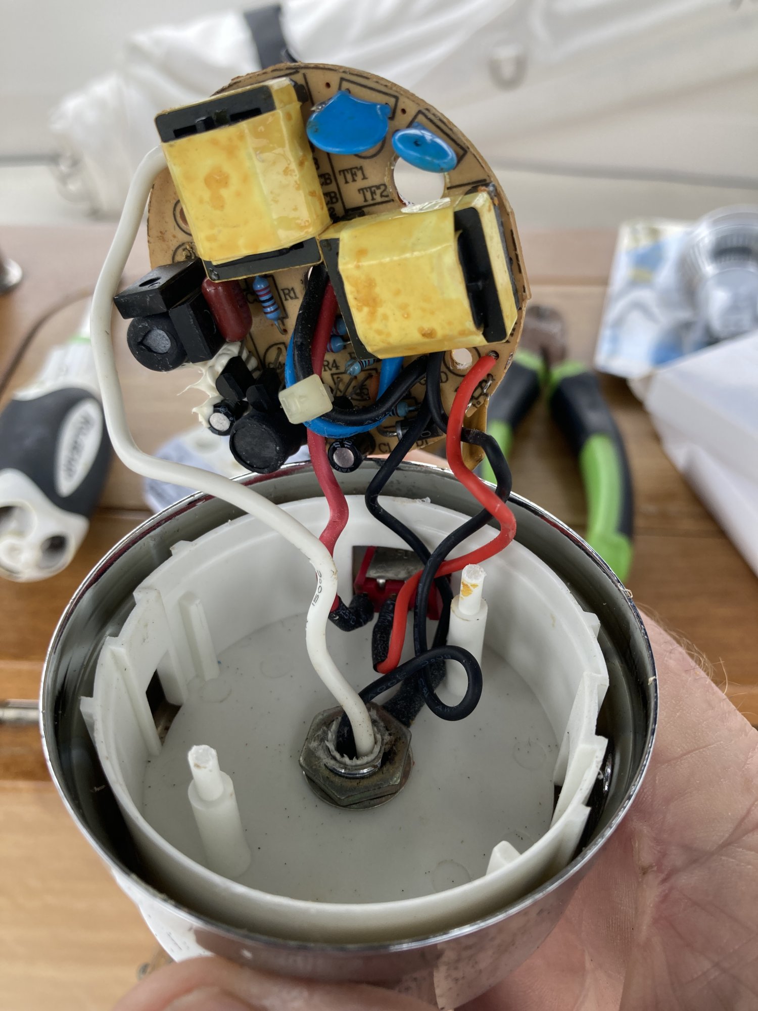

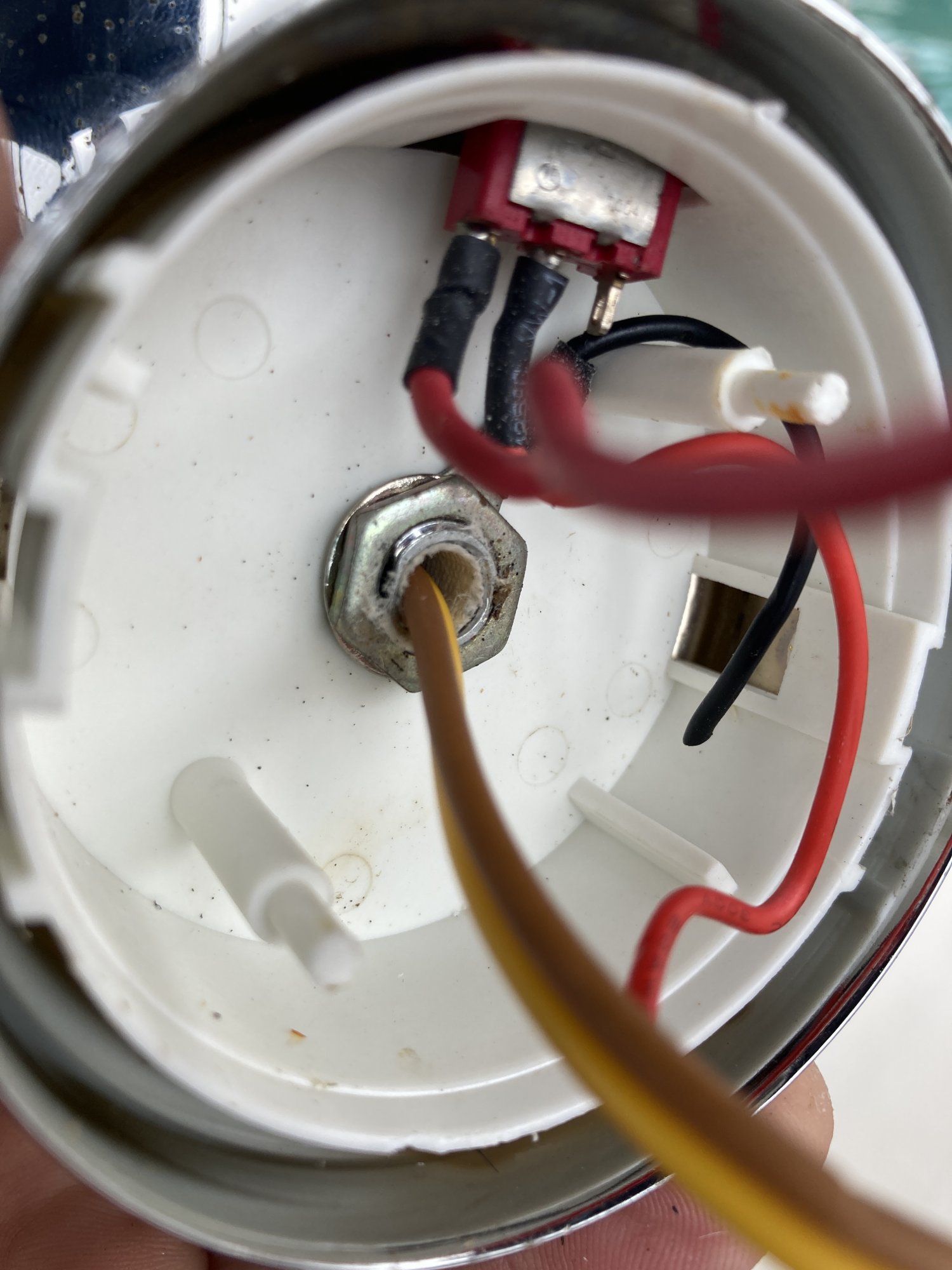

Terry, I can’t get the bulb out and scared to break it. I disassembled but not much identification as far as bulb goes. It works for now so maybe leave it for now.

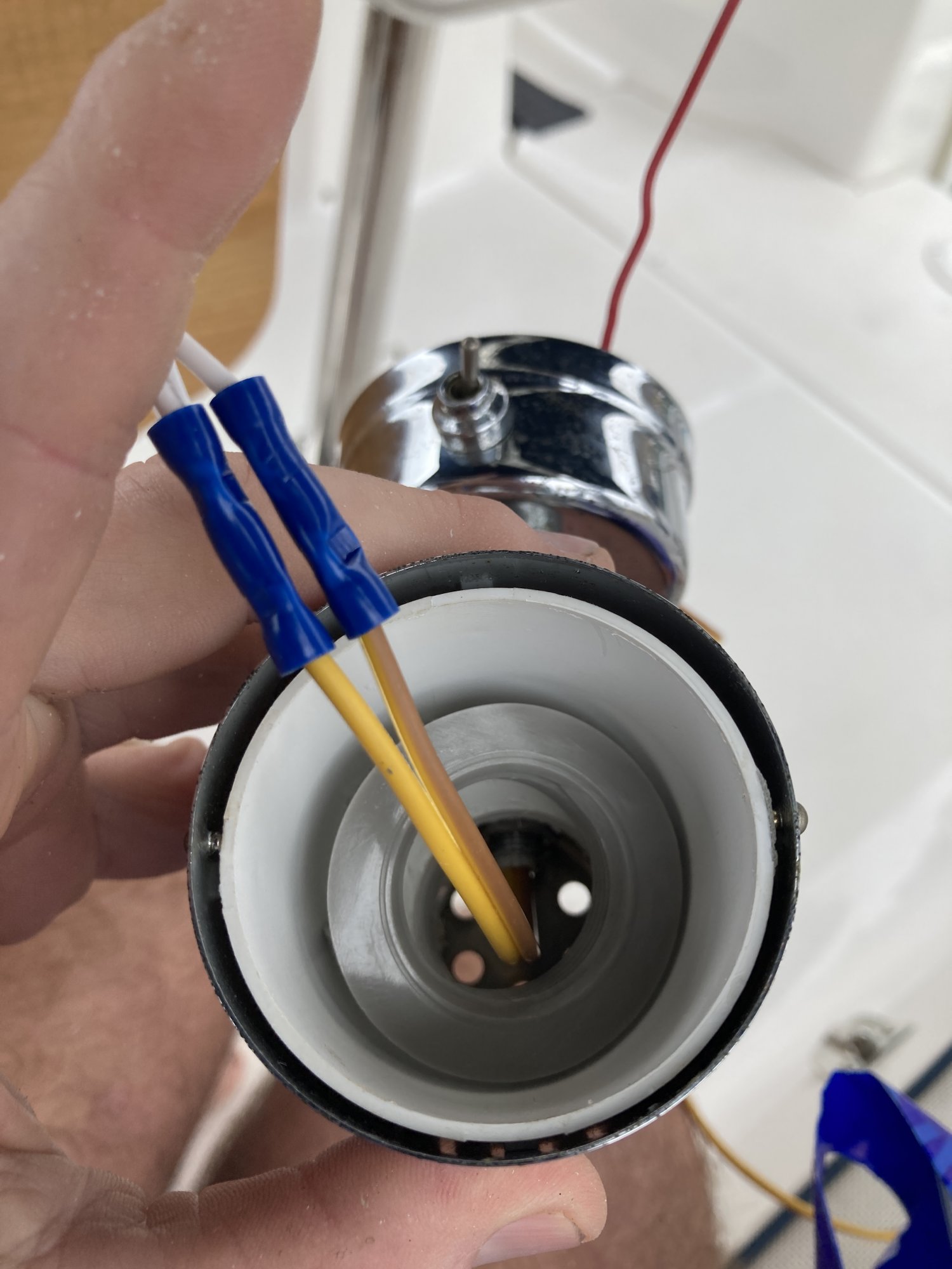

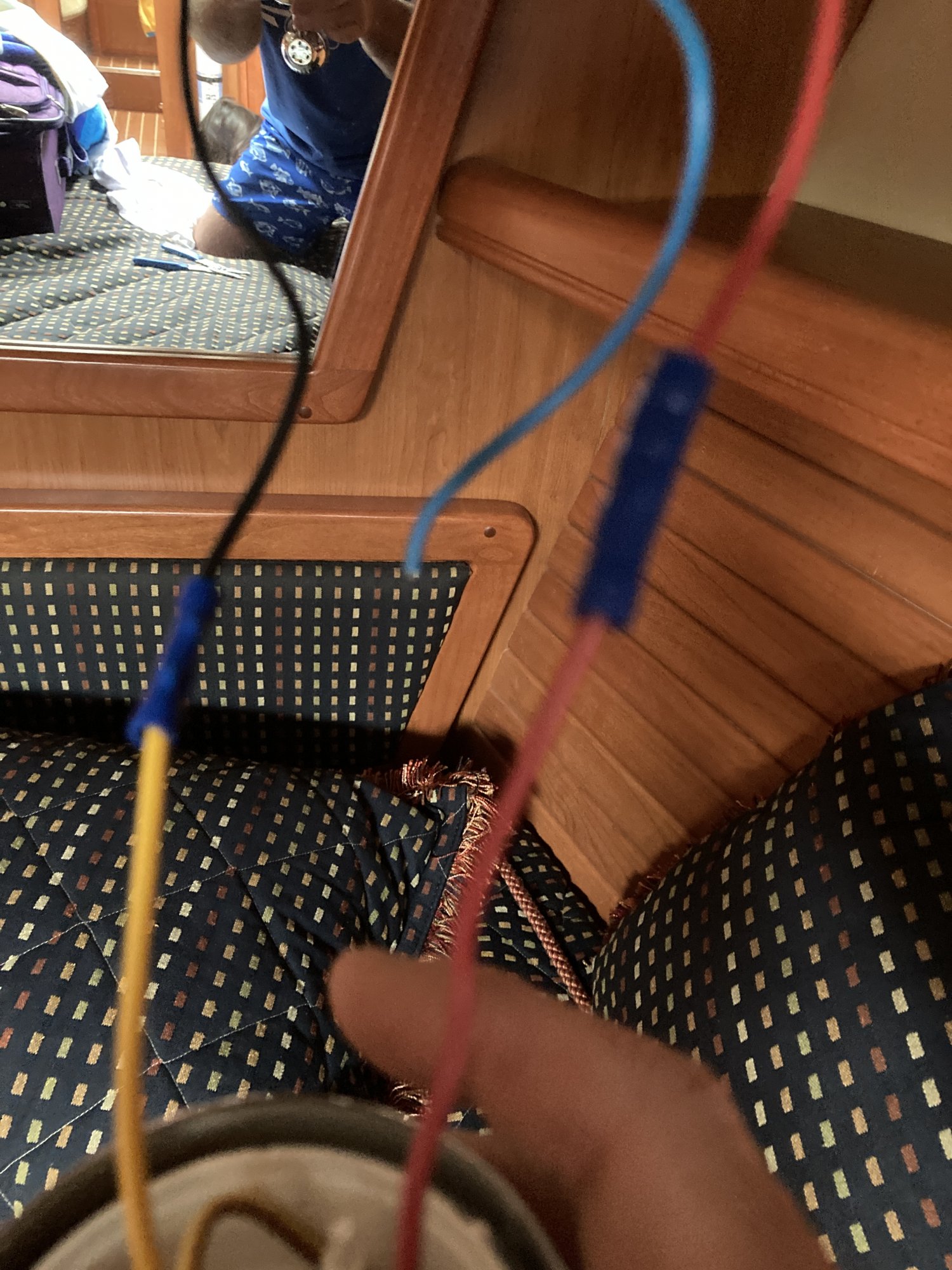

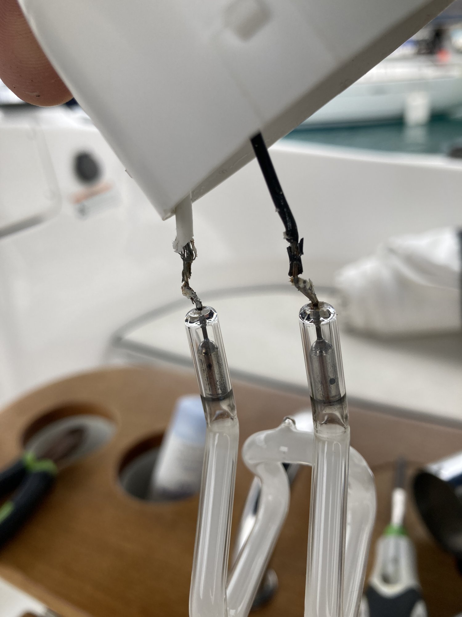

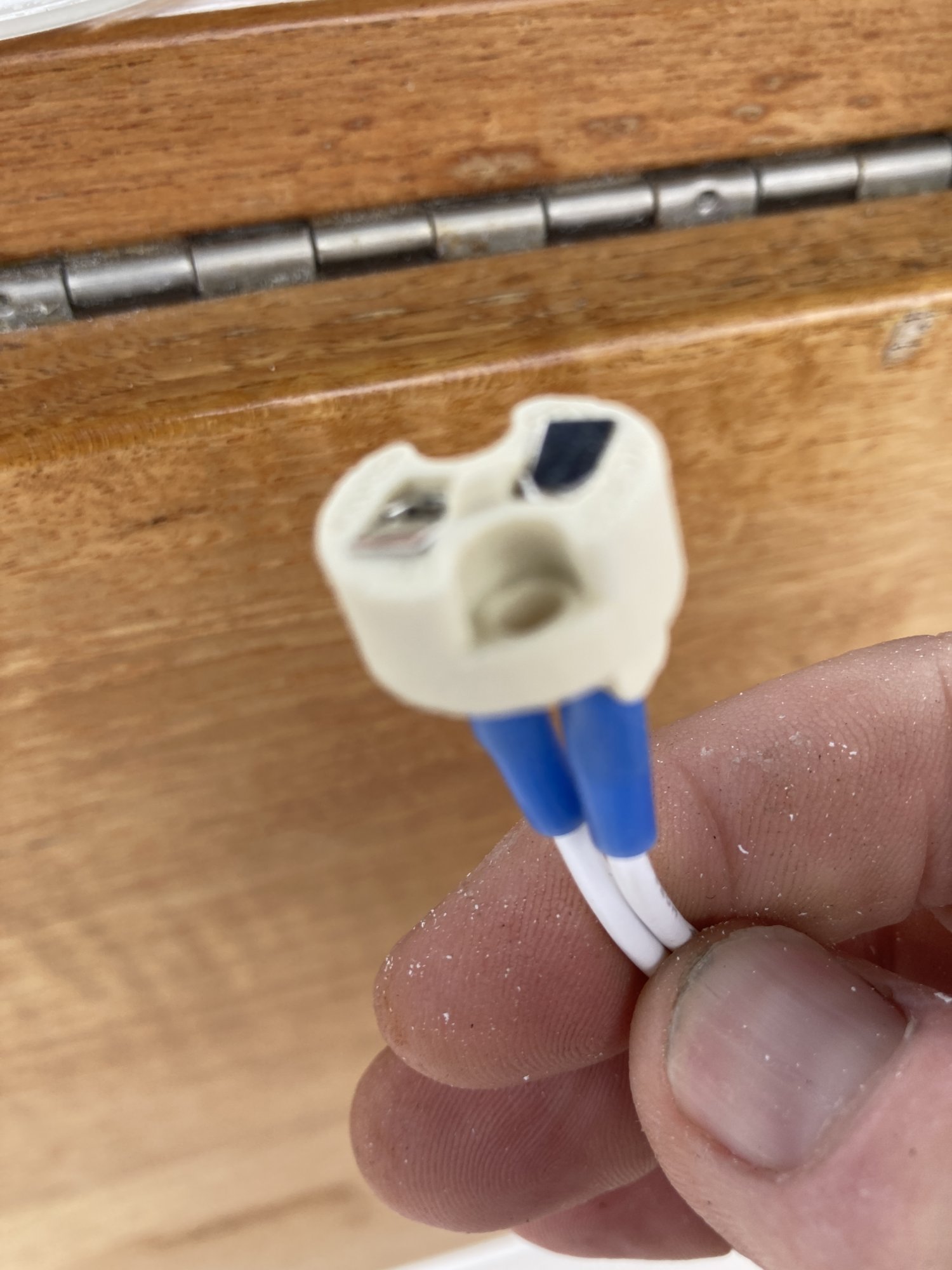

I bought a bulb from West Marine, bought a bag of M16 sockets from Amazon, and then pulled out the old bulb and circuit board, leaving only the plastic housing. Then I ran some new wire through the fixture and connected the wires to the tails on the new M16 socket. You have the option of reusing the lens. If you choose not to, just put the bezel piece back on and you're done. I have a couple more to replace. I’ll take some pictures and post them as a tutorial.

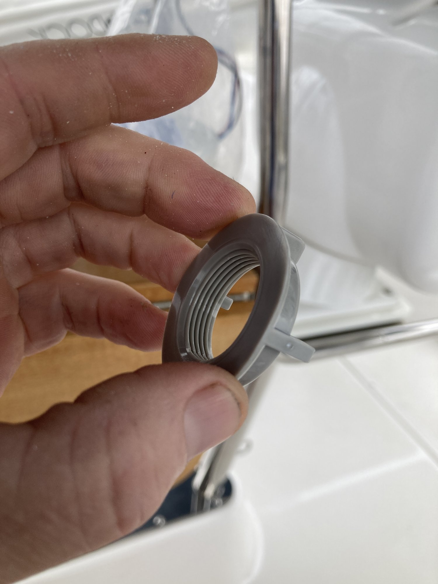

I used a plastic nut from a plumbing fixture to take up space behind the bulb. I had some extra from a previous project. Anything that pushes the bulb up to the lens will work.
