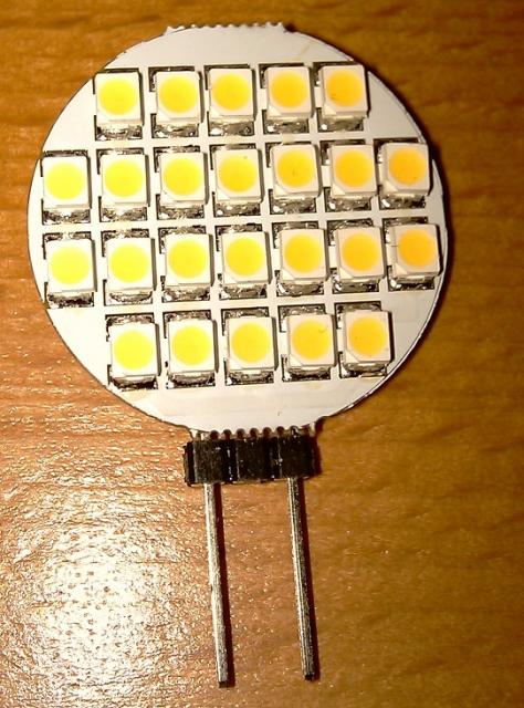

Didn't want to hijack someone else's thread, so this is an update to the LED Lamps purchased from Ebay.
Lamp Specs
  • Base: G4 ​
  • LED Chip: 1210​
  • Light Color: Warm White (3000~3300K)​
  • Input: DC 12V​
  • Power:0.9W​
  • Lumen: 140 Lm​
  • Life time: about 30,000 hours​
  • Angle:160​
They cost $2.88 each and shipping is free. They do not have voltage regulation.

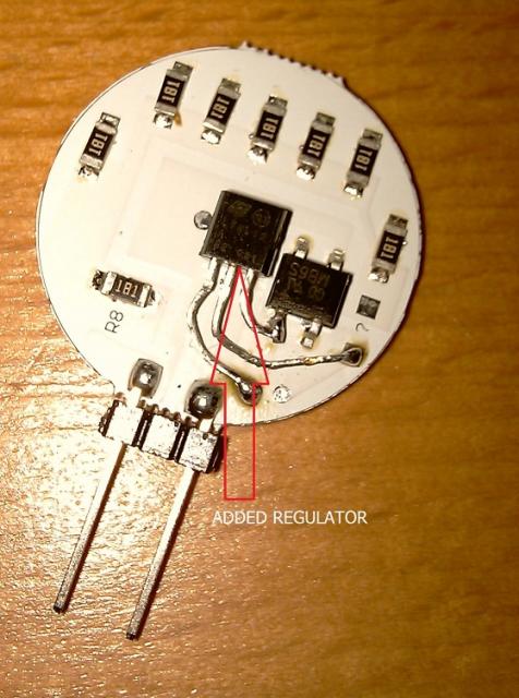

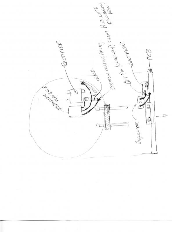

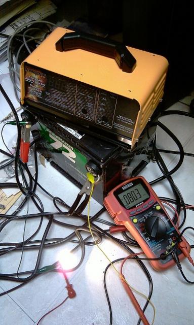

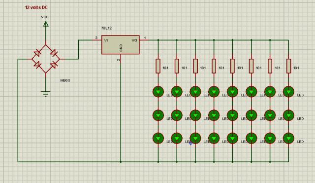

Purchased a voltage regulator for $0.21 and added to circuit board. The positve lead from the rectifier has been lifted from the PCB so that I could attach the regulator into the circuit.
You can see this in the attached photo.

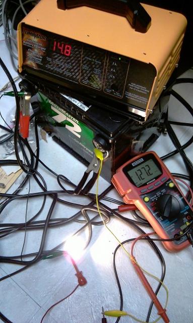

One picture shows the charger on (14.8 volts) and current draw of 127 ma. I ran this for 1 hour. The LED was slightly warm to the touch at the end of that time.
The other picture shows the charger off and the current draw of 80 ma. Battery voltage is 11.9 volts.
Note that the brightness hasn't changed.
Total cost $3.09.

I have been playing around with these sorts of LED lights also - what is the purpose of the voltage regulator? I have installed two without the regulator and they appear to be working fine. I have 2 more samples of LED pannels in route as I type. The first two I am playing with are not quite as bright as the stand bulbs they are replacing.
Apr 8, 2010
1,606
Frers 33 41426 Westport, CT
As I understand it LEDs are very easily damaged by over current of even just a couple volts, and they dim quickly at under voltage. A voltage regulator allows the use of lower voltage LEDs, so they can work correctly with input voltage ranging anywhere from ~10v to 20v without burning up the LED, and in some cases burning being the operative word...
see http://store.marinebeam.com/whyounetokna.html for more info
Apr 27, 2010
970
Beneteau 352 Hull #276 Ontario
Fourpoints is correct.
These LED's do not come with any regulation. They work well if the voltage is a constant 12v or close to. The problem comes in when your charging circuit exceeds the 12 volts and especially when you equalize your batteries.
Chargers are usually around 14.8 volts. Without the regulator, the LED's will shine more brightly because more voltage is applied and they will get hotter.
Now, if you equalize the batteries, the voltage can go go above 15 volts. This could cause damage to the LED's.
The regulator maintains a constant 12 volts to the LED which means a constant Brightness no matter what the input voltage is.

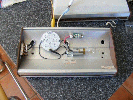

Good thread and good DIY project. I did something similar several years ago when incandescent to LED conversion "bulbs" were still very pricey. And super-bright LED's even more so. After the holidays, I had noticed that "warm" white LED Christmas lights were locally marked down to $5.00 for a 60 light string. Each LED was reasonably bright. So I removed the individual LED's from the strings and and mounted 12-18 on a PC boards, also using a voltage regulator in each array.
They work fine in my 1980 vintage cabin fixtures. But to put a bit of damper on our DIY enthusiasm in this case, just to mention that the cost of LED "bulbs", with regulators already built-in, has really really dropped. Joker460's project is still cheaper, but the time vs. cost relationship might be tipping away from DIY.

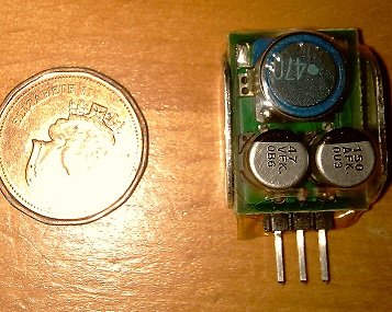

I had another idea for LED lighting.
If you don't want to modify each LED, you can add a regulator to your electrical panel switch for the cabin lights only. Just be sure to change all incandescenrt bulbs on that circuit otherwise the magic smoke will escape.
These LED's without regulator draw 40 ma. So if you have 12 lamps x 40 ma = 480 ma, so a 1 amp regulator would do.
Attached is a switching regulator rated at 1 amp and doesn't get as hot as a linear regulator would at rated current.
This regulator is $15. A linear regulator would go for under a $1 but you would need to add a heat sink.
Remember you do this at your risk.:eek:
From your photos, there's a 4-pin IC on the back which I suspect actually is a regulator of sorts. Also, the things are designed for autos and RVs, which implies a similar battery/charger/alternator environment... so I would guess that they could handle up to 15v with out blowing up or changing brightness.
Just a guess; i haven't yet found a spec sheet for the thing. In any event, your regulator is cheap insurance.

@ Ken
I have the data sheet on the device. It's definitely a full wave rectifier.
It allows you to connect the device either way. No polarity required.
