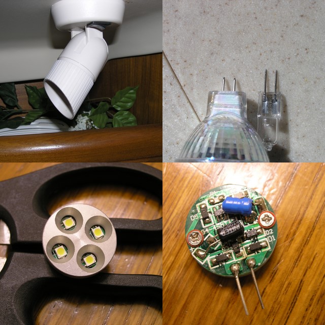

I ordered these led from Cruising Solutions for $25/piece. The fixture in upper left was unable to handle the led originally since the prongs were to short. The base would not sit in deep enough. They exchanged it for one like the lower right but with the prongs straight up. I've now enough led's to replace all the lights in the salon. This coming weekend I will check and see the difference between the old bulbs and new led's. The current draw should be a significant difference. Will try to take pictures...
Mainesail these leds look just like the ones you are getting from MaineBeam, do you concur?
Yes but only because Cruising Solutions is selling the MarineBeam bulbs. This according to Jeff the owner of MarineBeam..
Sailors Solutions / SCAD is a different company altogether.
P.S. I have added a photo of a 10W halogen to the OP. The color temp is very similar to the Sensibulb but it's a wider beam.

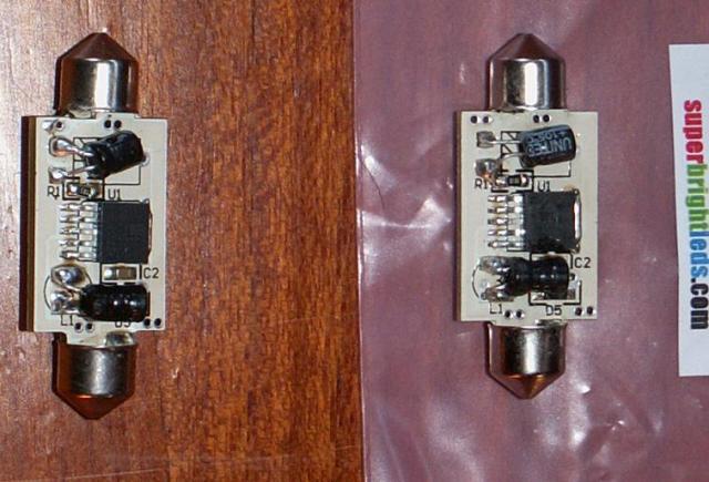

Can you comment on Tim R.'s finding about the two festoons, one from you and one from, Superbrite being the same? I saw them and it is more than a knock off it is the same bulb? Is it possible Superbrite is now buying from your supplier?
I have a Superbrite G4 / MR-11 on order that also looks to be identical to your bulb and when it gets here I'll let you know what I find. I will also take high resolution photos to compare the two. The Superbrite bulb sells for $14.95.???
If they are in fact the same bulbs you might want to go back to your supplier for a price break so you can remain competitive..:confused: Your service was outstanding BTW!!

Not a copycat. This is the exact same bulb.
While you might not notice any difference, I see different LEDs, with different forward currents right off the bat. One bulb has China orphan LEDs, the other has Seoul Semi LEDs.
I can't say anything more as I don't have it in my hands. Clearly looks as close as the others on the copycat section of my website.

Tim R.
May 27, 2004
3,626
Re: More LED Bulb Comparisons
The LEDs do look a little different. The light output looked to be very close in both color and intensity. Are your's from China or Korea?

They could be from different manufacturing runs, of the same design, from different manufacturing plants. A lot of companies outsource actual production, and the circuit board design is identical as are most of the components. It is like when a computer manufacturer uses Western Digital harddrives for one production run, and then switches to Maxtor or Seagate harddrives for the next batch because the WD drives were more expensive or not available. Almost identical specifications, but slightly different components.
