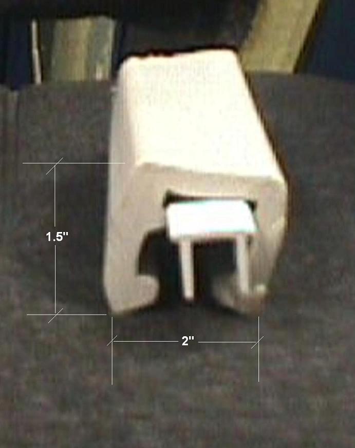

Second, I don't think the drawing you show is related to a Hunter unless it's for very early models. More recent Hunters use a flanged hull/deck joint bolted every 6". This looks like a Beneteau construction.
Below is a photo of a Hunter rub rail assembly sent to me by Hunter. The hull/deck flange joint sits between the internal vinyl piece and the rub rail is applied like cap.
Also, Hunters now have a solid FG toe rail as part of the deck.

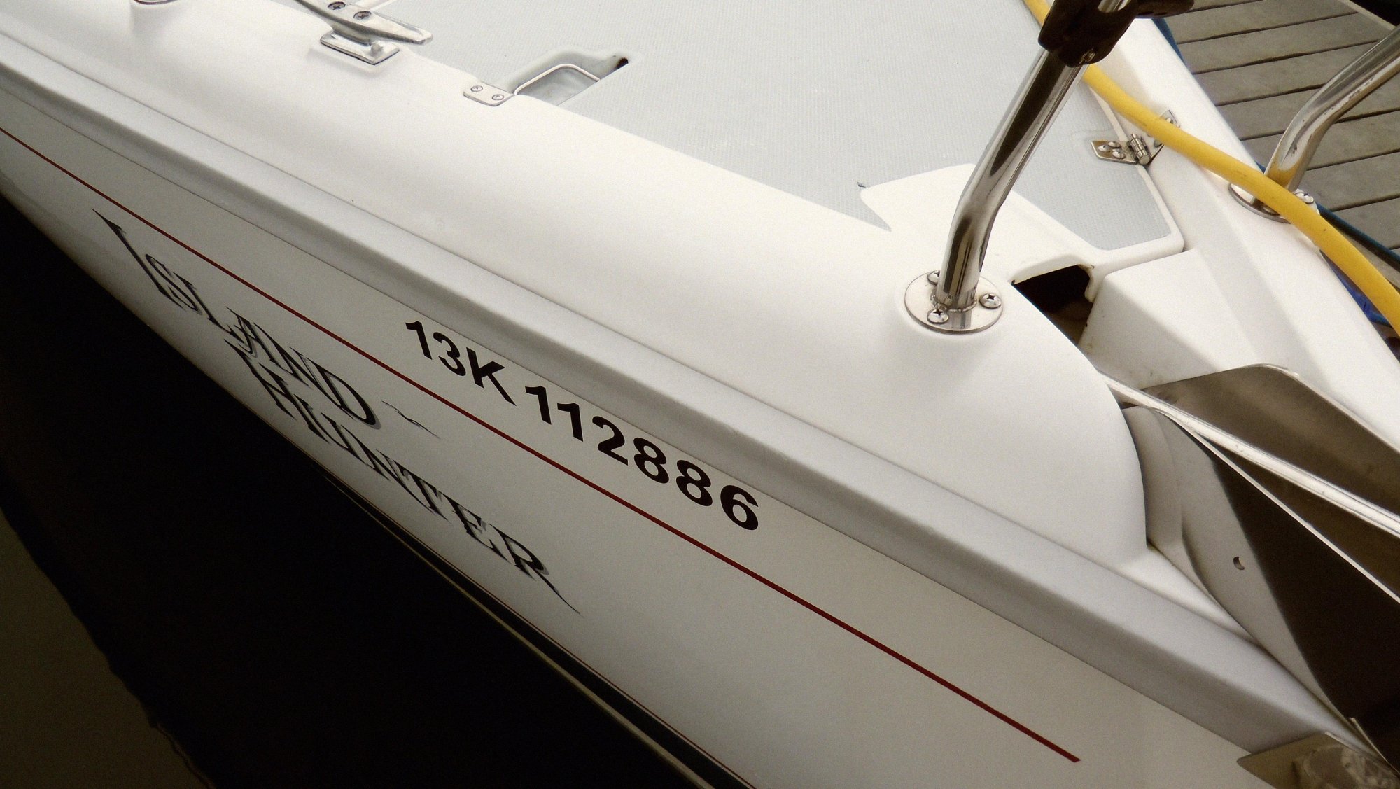

Hunter 33.5 Toronto
Hi Ralph,
Thank you for reply.
Boat year is 1988 which makes an early production of the 33.5
The picture below is the best depiction of the toe rail on the actual boat that I have. I have to assume that the hull/deck joint is under the rub strip. The picture should enlarge but with attendant quality loss
