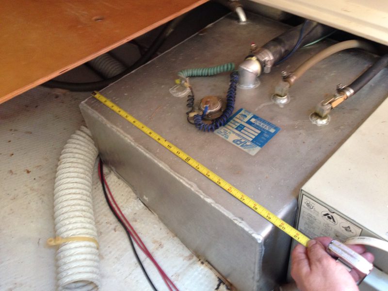

Just replaced mine recently. The old tank had the manufacture's label on it. It was AFP and is now RDS in Florida. They still had the original drawings and made me a new tank for less than others. I called Catalina factory but they were having difficulty with getting the right part- go figure.

Thanks Stu and Doug. Doug, your tank looks exactly like mine. The mounting brackets are glassed to the hull. Did you just grind the old glass off the brackets to remove the old one and glass in the new one?

Gregory, yes I used a 5 in grinder/sander. It didn't take much to grind but it does make a mess. I decided not to fiberglass it in like the factory. Instead made some straps to go over the tank and bolted it to some blocks that are epoxied to the hull. This way if I need to take out the tank in the future it will be easy.

My tank was leaking ever so slightly at the bottom weld where the tang or corner was. The tank rests on the hull and the tabs are glassed in. I don't know if vibration and chafe was an issue but whatever causes leaks in aluminum tanks I decided it was just easier to replace.
