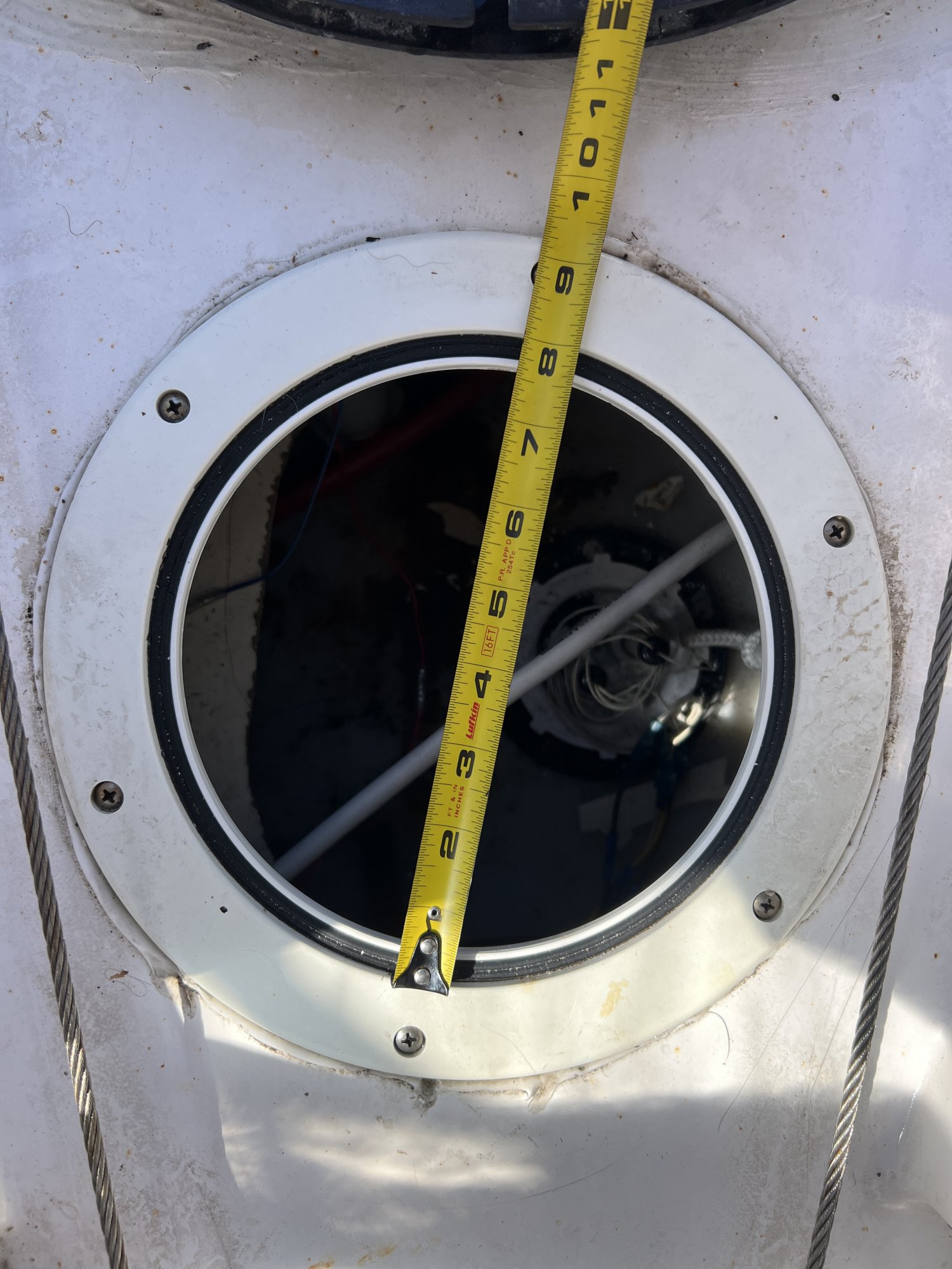

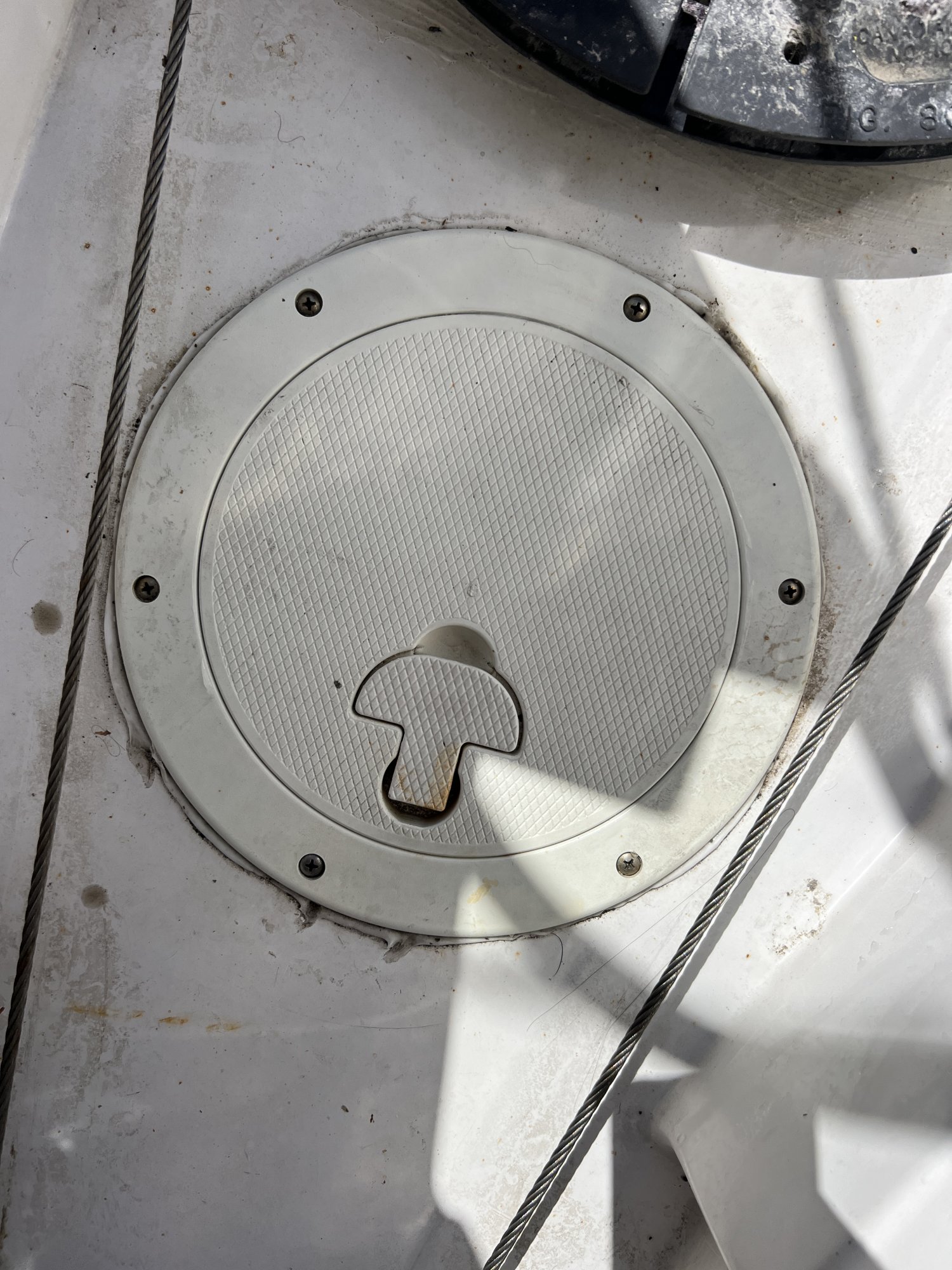

This deck plate has a latch that seems to be leaking rainwater when at dock with our stern to weather. I’d like to replace it with something watertight. I’ve seen the pry off type, as well as the screw type, but I’m not sure which would be better, if there is a difference in water tightness. I assume I’ll need to remove the plate and the mount, then install a new one (though if it’s possible to simply replace the gasket and plate while keeping the mount, that would be great).
Any recommendations on water tight deck plates, or if I can potentially even switch the plate while keeping the existing mount?

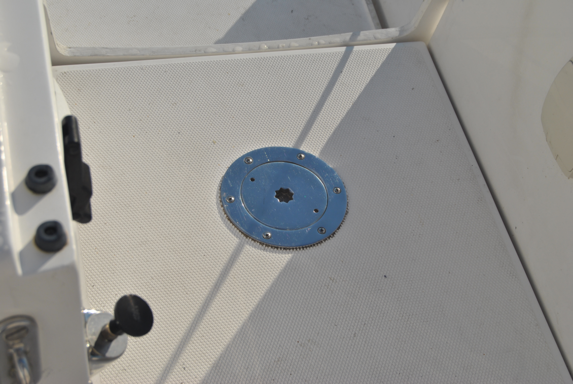

That hatch is used over the emergency tiller head on my boat so the helmsman stands on it. Replaced recently because the cover had cracked starting at the pull tab as Claude indicated. Whatever caulk was used for the frame seemed indestructible so I left it and just replaced the center hatch. Surprising was that Worst Marine had best price (49.99) and could pick up at local store.

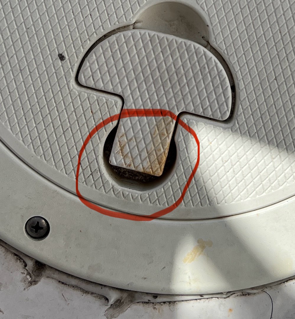

It appears to be leaking through the latch itself - there is rust stain on the bottom side of the latch.

Is it leaking around the edge that's sealed to the deck, or around the gasket under the removeable cover?
Neither from what I can tell. It seems to be coming through the latch mechanism. I’ve superlube the gasket, but that may also be a culprit. Can I get a replacement gasket somewhere?

The center plate is screwed in and doesn't object to being stood upon for endless hours.
