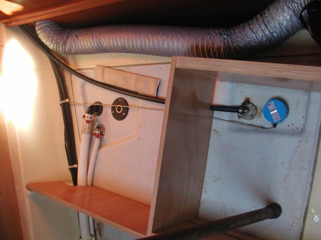

My buddy’s 2000 Beneteau 42, center cockpit, fixed dodger, cruiser has a leak in the starboard forward water tank. We’ve eliminated all hoses and stuff since they all come out of the top of the tank and are easily seen. The tank slowly leaks to the bilge and we’ve eliminated other water sources by dying the water and having the dyed water show up.. This happens with the water pressure turned off or on. The water shows up in the forward limber hole in the liner structure. We are pretty sure that the leak is in the tank itself, which is molded into the liner and has a lid glued onto the ledge in the top of the molded tank. The lid is not leaking. Beneteau confirms that the top of the tank can be removed if carefully pried off and can be reused after cleaning. They cannot tell us what is holding it down..
Has anyone had the same problem and how did you deal with it? Is the lid held on with elastomer or resin? How did you take the top off? Our plan is to get in the sealant groove and remove what we can see. Then attack the sides with a pry tool and possibly a heat gun to get the sticky to release.. ??
The picture is the top of the tank, looking forward on the starboard side, bunk support board removed. The boat is in Oriental NC (many hours away) , and we are trying to get a grip on how to get the top off before we get there.

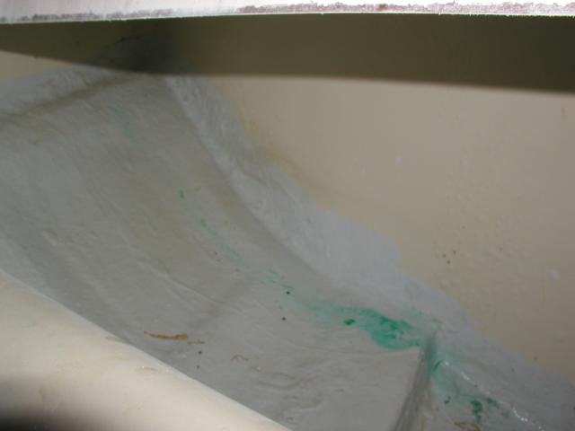

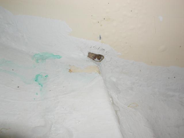

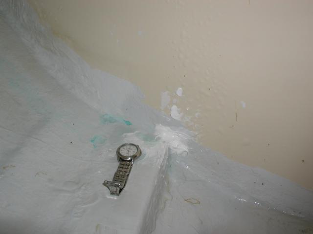

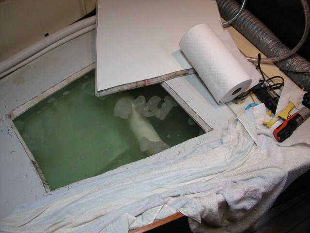

Talked to the Beneteau expert in Charlotte and he said we would not be able to get the lid off of the tank. We cut a hole in the tank and found the tank was made into the hull and liner. The bead of 5200-like material was about an inch and a half wide so there was no chance of levering the lid off. The lid is 1” balsa core with 1/8” fiberglass top and bottom. The tank was formed, I think, by putting a sheet of random glass matting over the hull and using that to seal to the liner, after the liner was in place. The hole we found was a result of poor workmanship by the builder. There was cracking and porosity in the glass matted joint between the liner and the hull. The worst was at the aft of the tank where the mat was glassed over a long, hull strengthening stringer. We got concerned about not being able to get food grade epoxy and so used food grade RTV silicone. The holes were ground out and the cavity filled with silicone. The tabbing elsewhere in the tank looked to be good enough for strength so we did only leak repair. A three hour full tank test after the repair showed no leaks..
Pictures are of the tank with the water and dye in it for leak testing. Other is of the inside, looking aft. The matting over the hull and tabbing onto the liner can be seen at the bottom. The leak was where the dye is oozing out at the corner of the aft tank wall and the corner of the stringer.

Yeah, apparently they did this on only two models and have discontinued that practice. This boat is a 2001 model. The top is still off because it was cold enough in Oriental NC that we didn't want to deal with the condensation. First time I've looked out of a port and seen snow ! Anyway, we cut the top at a 30 degree angle so it will sit in the hole. The plan is to put 2 aluminum angle braces across the cap extending about 3-4 inches onto the lid. These will rest flush with the top and hold the plug up. The raw cut edge will get a BIG bead of 5200 before the plug is put back into the hole.. The trick is going to be to seal it well enough to keep the balsa core from seeing water. Probably going to trowel on a thin layer of 5200 on both faces of the cut, let that set a day and then glue the thing back in place. The angle will remain screwed across the plug and tank top. Pictures are of the hole opened up and the silicone goo plug in the hole.
