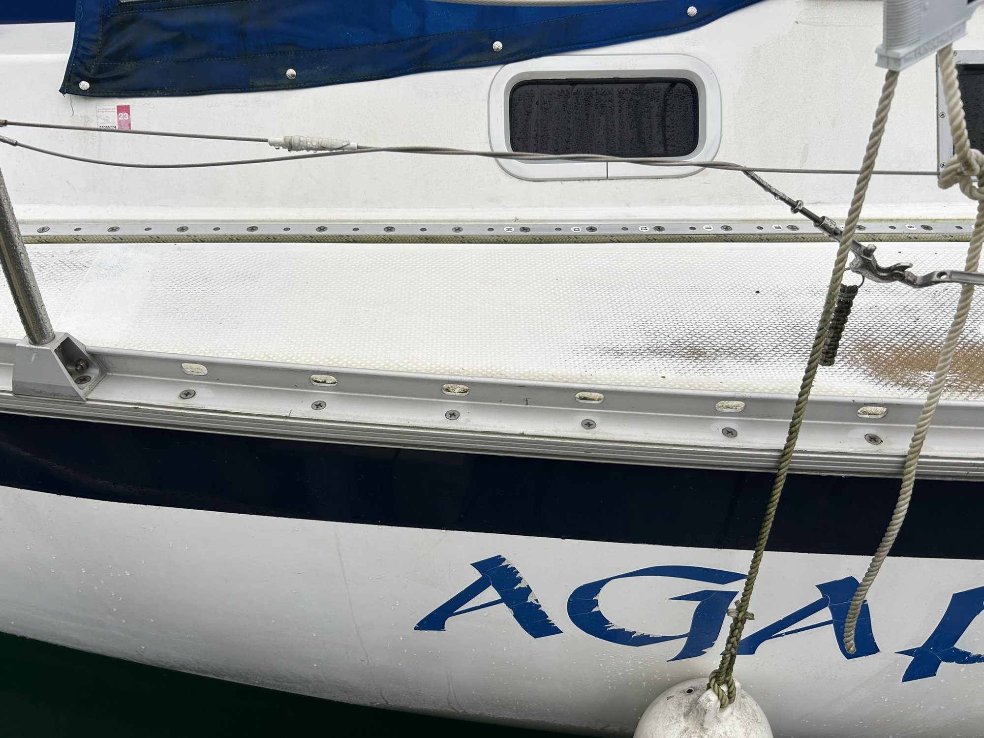

My 1984 Hunter-34 has a leak that results in rainwater slowly running down the inner hull, making the carpet wet. I cannot tell which through-deck bolts are leaking. I started off by re-sealing 10 bolts that secure the genoa traveller to the deck. It is still leaking. Now I am wondering if a leak in the toe rail bolts would result in water running down the inner hull. I am attaching a picture. What do you think?

The design of the H-34 toe rail is such that it is unlikely (not impossible) that rainwater can come in. I would suspect the fixed portlights or the opening port over the galley that you've pictured. The hull has an outward turned flange; the deck has a "shoebox" fit over that flange and the toe rail bolts are outboard of the hull. A very loose bolt could pass rainwater; Get a good sized philips head driver and hold the heads in place while you tighten each nut with a small socket (tied to your arm so it doesn't go for a swim). Snug down each one.. Not too tightly, snug. (probably something like 60-70 inch pounds..) n start looking at the other stuff. Dave is right about the pressure leak detection.
