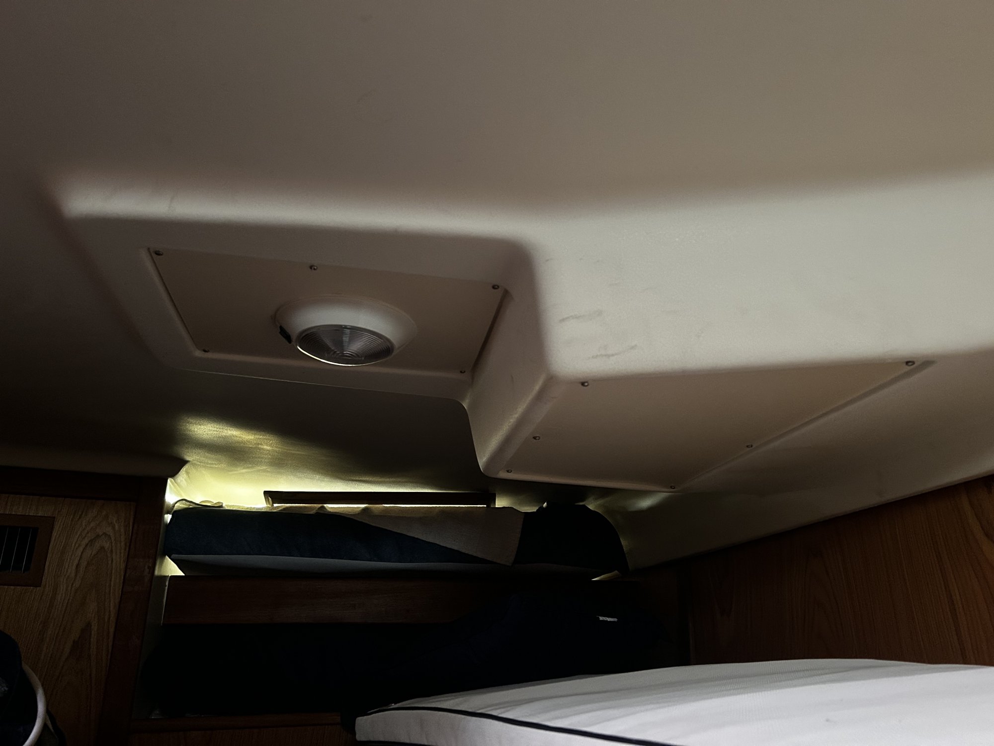

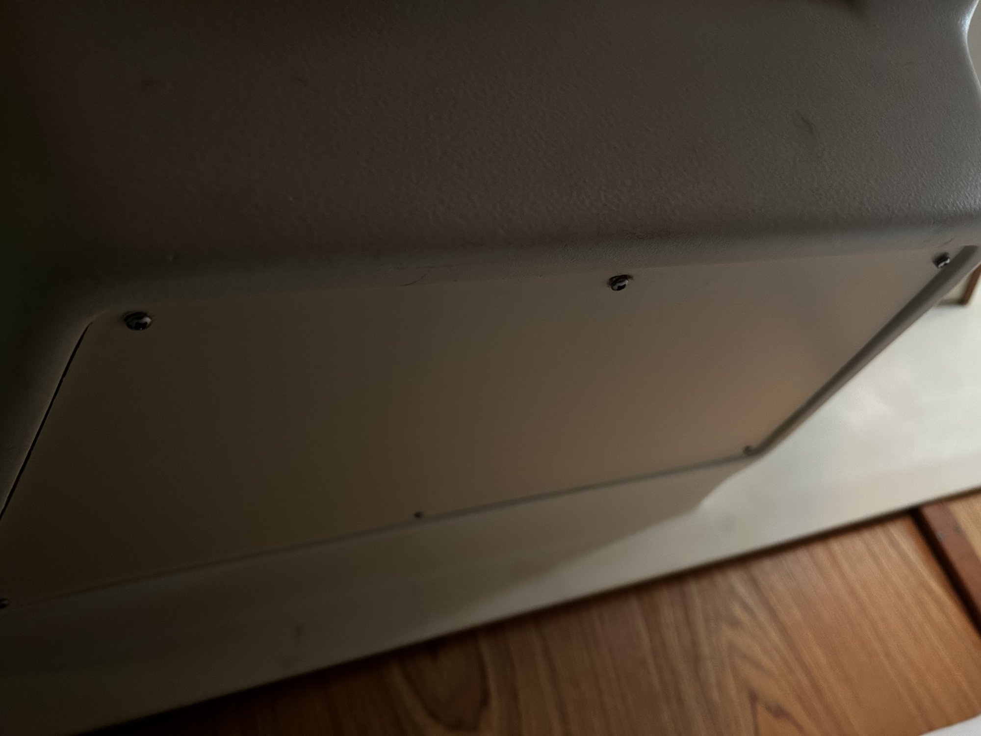

Today, on my 2000 Hunter 340, while I was finishing up routing my remote Mic Cable into my pedestal I found a source of a water leak into my aft stateroom headliner. I Didn’t even know I had a water leak in the headliner until I removed a small access panel to see if I could grab the Mic cable (that didn’t work). So were not talking about a lot of water coming in, right now.

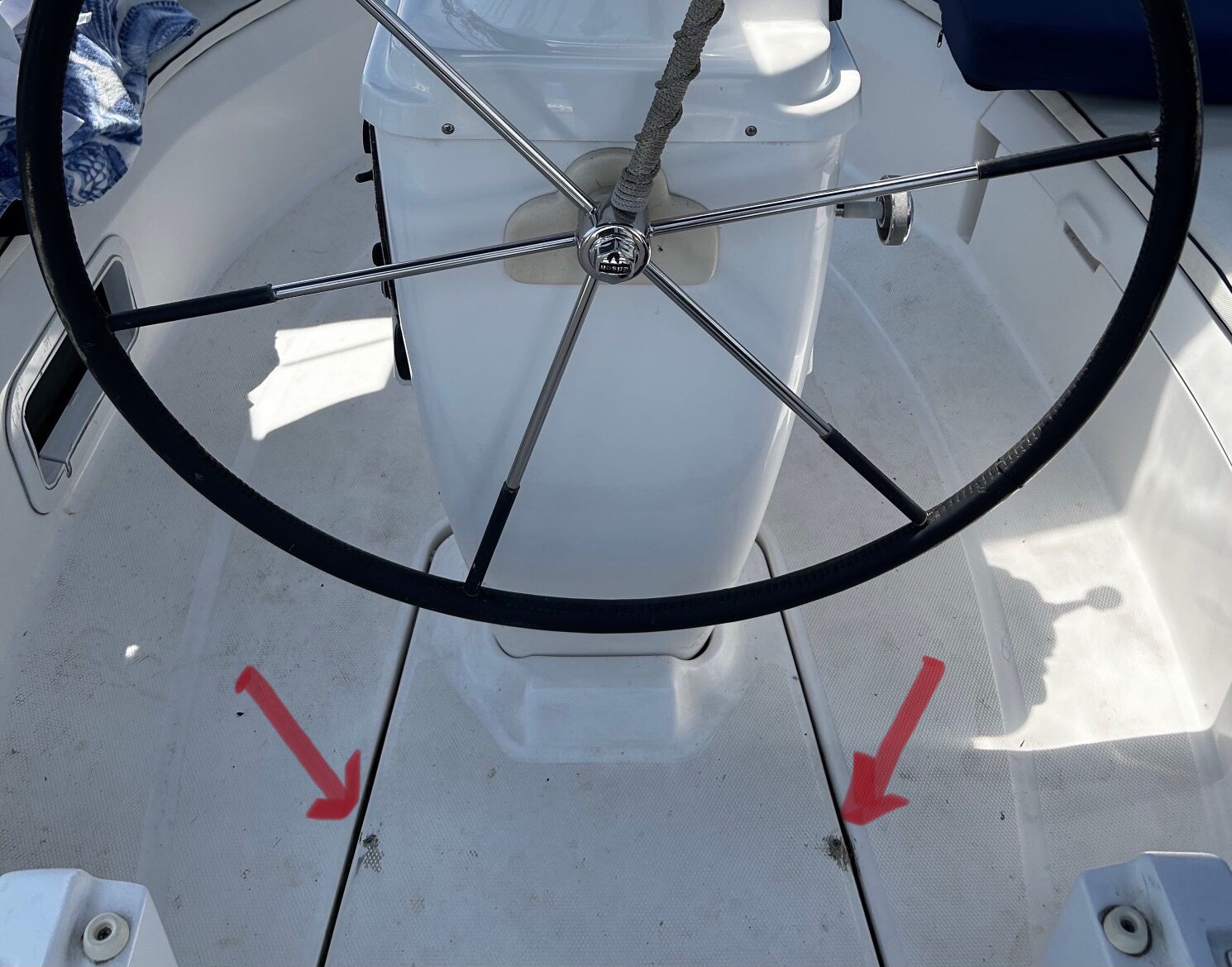

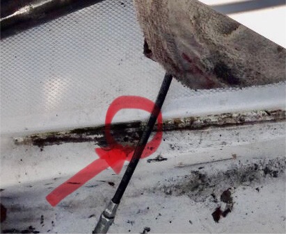

But the leak is coming from one of the 2 screws that hold the removable deck access panel covering the steering linkage. They’re 2 inch long screws that I can see in the headliner access area. They hold in tight when screwed down, have some caulking around the hole, but one of them is leaking. I do put some flexible caulking on the threads of the screws when I put them back in, but I think the hole is widening.
So the question I have is…..has anyone else had this leak source? Is there some sort of silicone sleeve I can insert into the holes and then screw the screws into that to seal the holes up?
I have pictures that I hope get the point across.

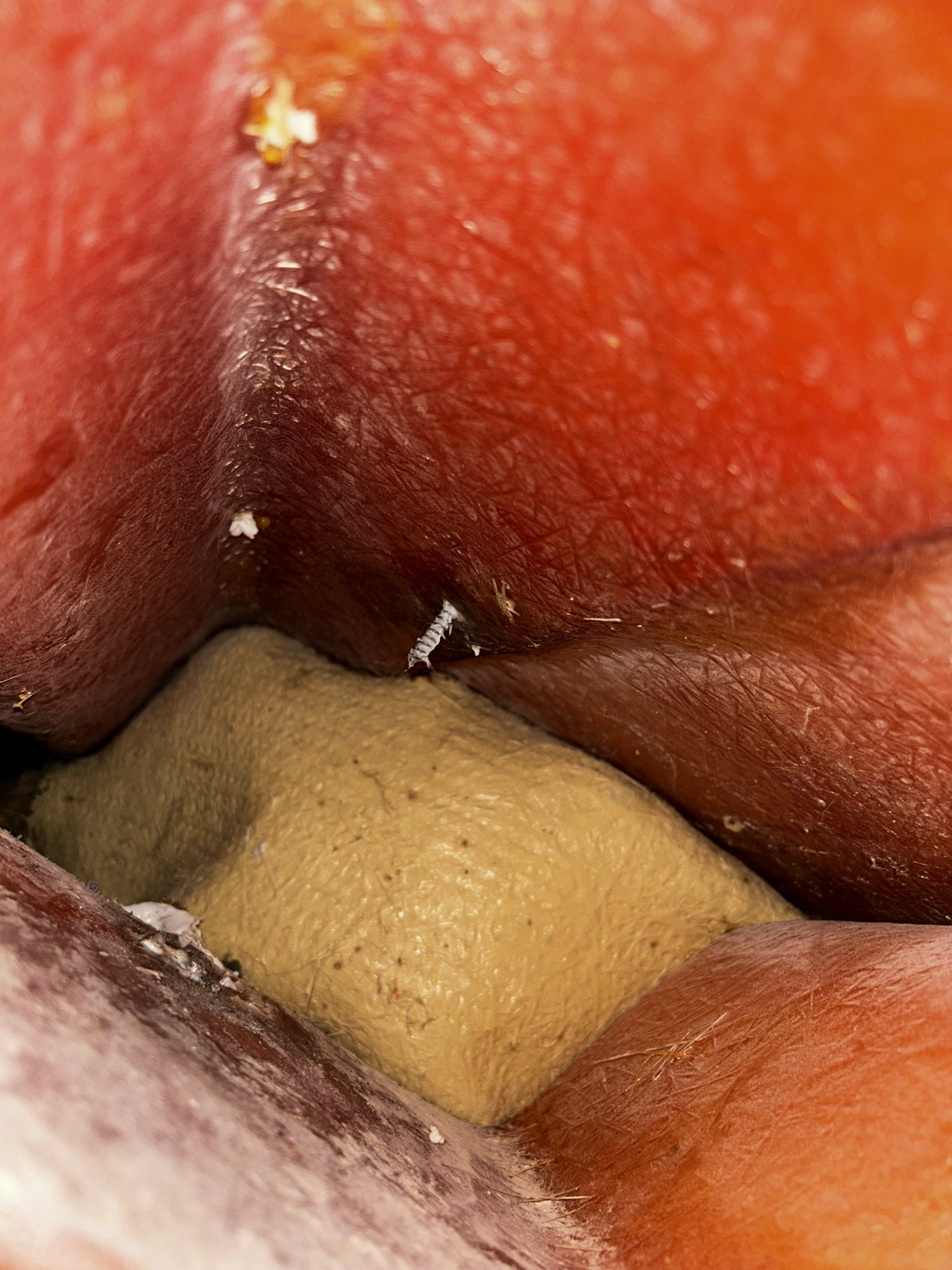

dj, great idea, but I couldn’t get my hand in the access area far enough in to where the holes are now. I tried to get a picture of inside there but really, it‘s only as wide as the thickness of your hand.
I'm afraid someone went overboard with the screws. Those screws on my deck access panel are closer to 1" flat head screws.
Oh Boy are you right on that one!
We bought the boat new in January 2000 so I have to blame the guy at Hunter who had the screw gun in his hand that day. Mine are flat head as well and there are only 4 same as you. 2 on the deck and 2 on the step through edge ( they 2” long as well)
I think I’m going to have to fill the holes, drill and tap them for new screws.

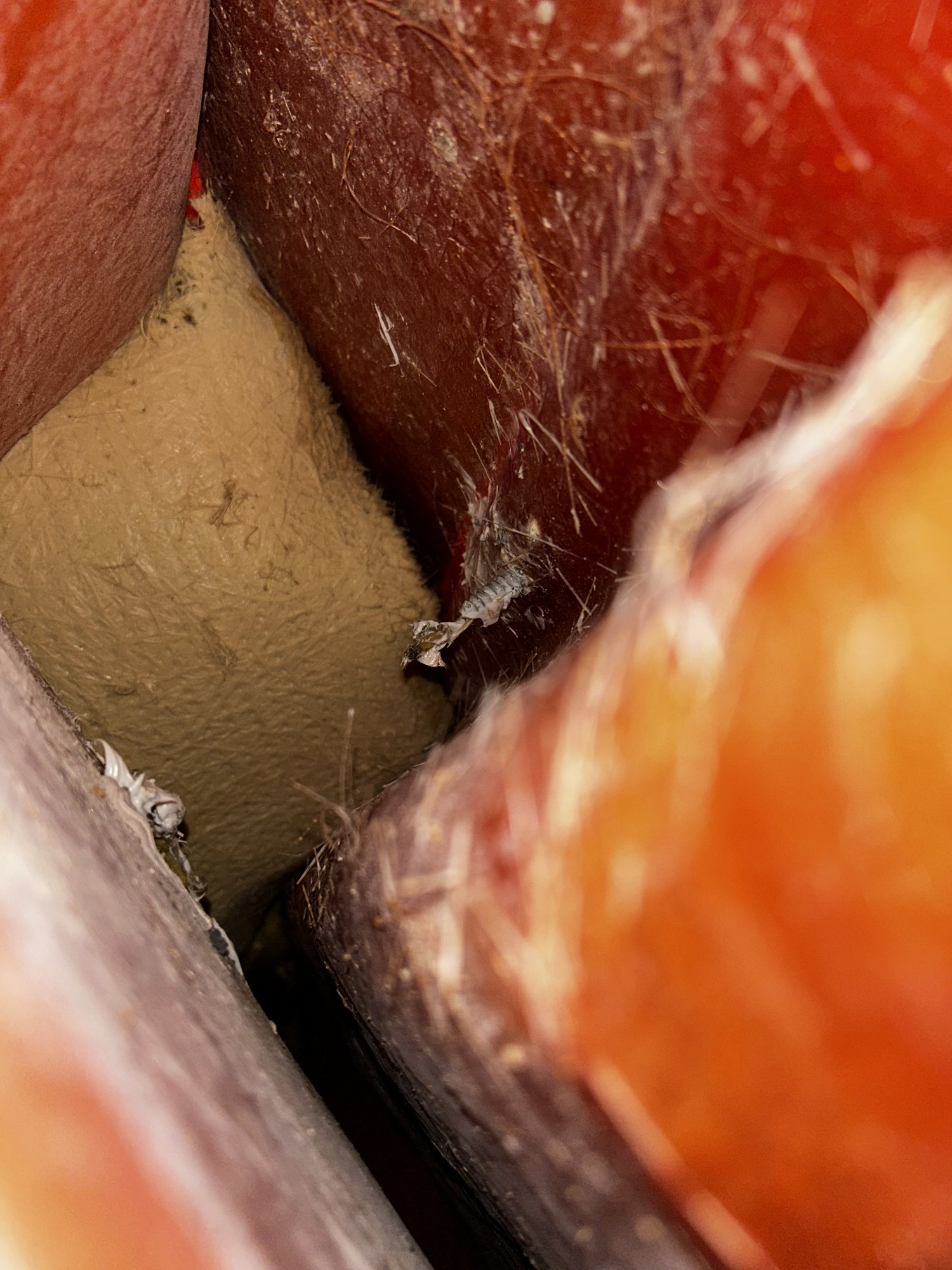

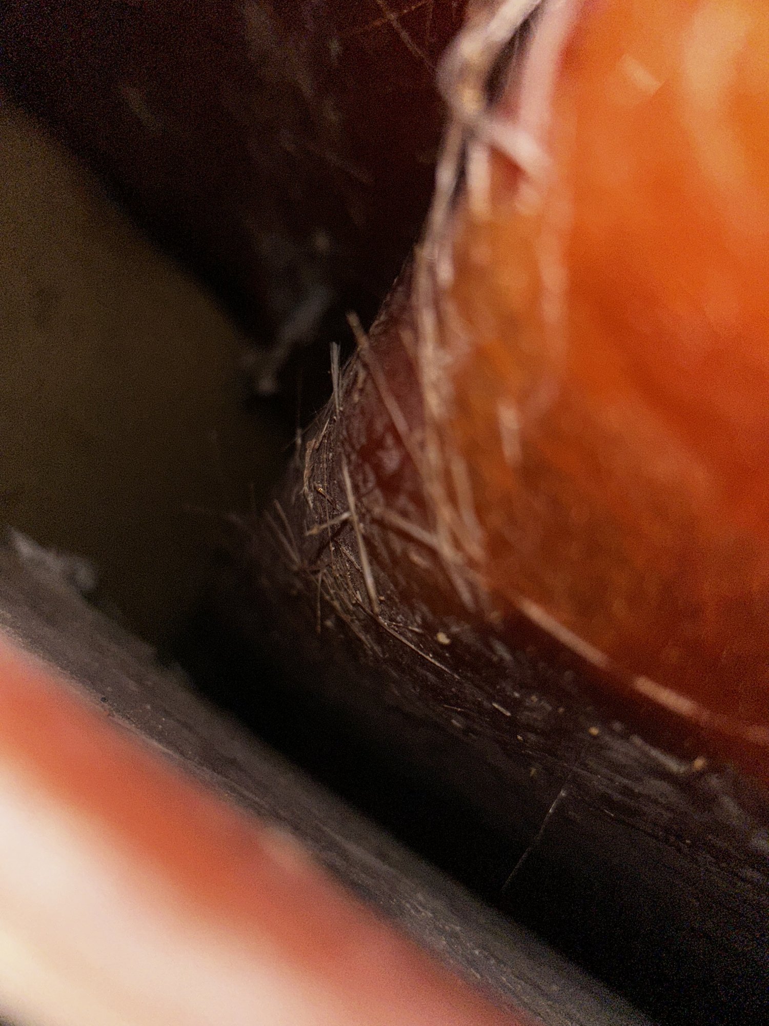

I managed to get a camera into the area and got a picture of the screws. Also the area they are hidden behind. What were they thinking! I always thought those 2 screws were solidly locked into a thick cross member, I guess not. So if you have leak you really can’t find in this aft stateroom, it’s worth a look.
I plan to fill the holes, drill and tap for new screws. And go with what Ralph has suggested, maybe 1” or 1 1/4” at best. That’s really all that is needed to hold the deck panel down solid.
