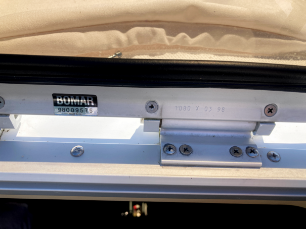

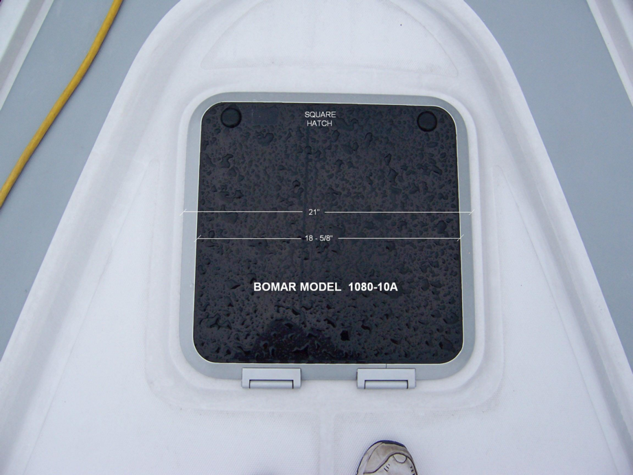

Your hatch is a Bomar unless it's a knock off :
Check under the flange for the model number :
Hopefully, the reason the gasket is not contacting is the latch is not pulling the flange down tightly enough causing the gasket to leak. If the gasket is brittle, you can find the part number on the Bomar Pompanette site.

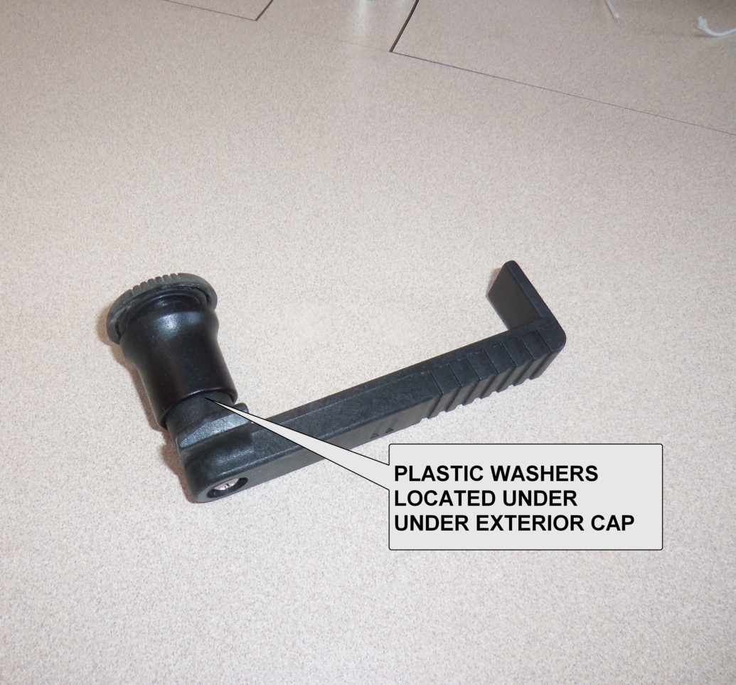

You adjust the tightness of the two latches by adding or subtracting plastic washer as shown :
