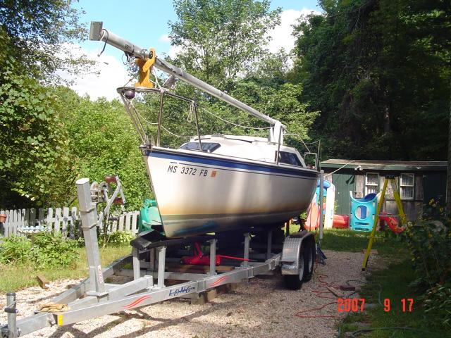

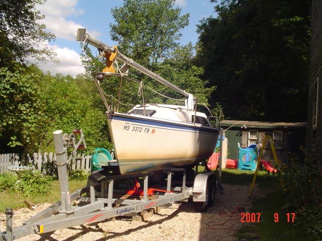

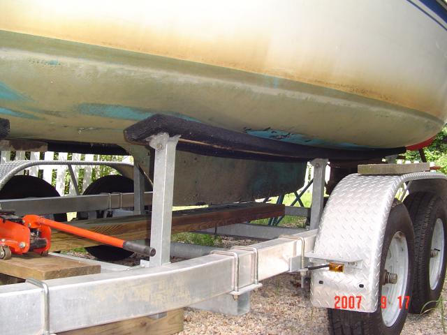

It's true that getting the boat off a roller trailer is a lot easier than getting it off a flat bunk trailer, but not impossible. I no longer have the Load-Rite roller trailer that came with mine. Today, I have a Long Mfg tandem flat bunk trailer. It takes a little longer to get the boat off it, but I'm still able to do it with the right equipment.
